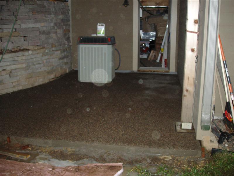

Hey Obed what do you think about pouring a concrete pad in that entire corner? You then won't have to worry about cutting the grass in there or pulling weeds, trimming, etc. If you do pour the entire area I suggest putting plastic up against the brick to protect it from splashing concrete and also place rebar into the brick to keep the pad from settling. I know this is additional work you hadn't planned on but this is what I did when I built my house. Both a/c units sit on them. The concrete is sloped away from the house so water does not settle there. Just a thought!!!!

I second the motion
and pitch it out a good couple inches to keep the water from wicking down the wall

I third the motion, lol. Whether you go with a 4'x4' prefab or pour a good sized pad yourself, you'll want to go 'big' to avoid having to dance around the thing with your trimmer every weekend. Especially when it's running, you get grass and crud built up in the vanes, big flat spots from flying hard stuff and it looks like crap. Mine looks terrible because i haven't taken the time to deal with it yet. Hoping to score some pallet forks so i can just pick the hog up and pour a pad right underneath it. They aren't easy to move after the fact.

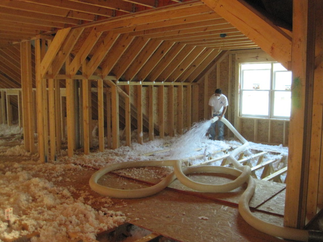

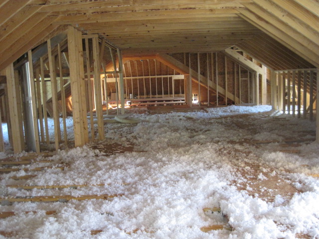

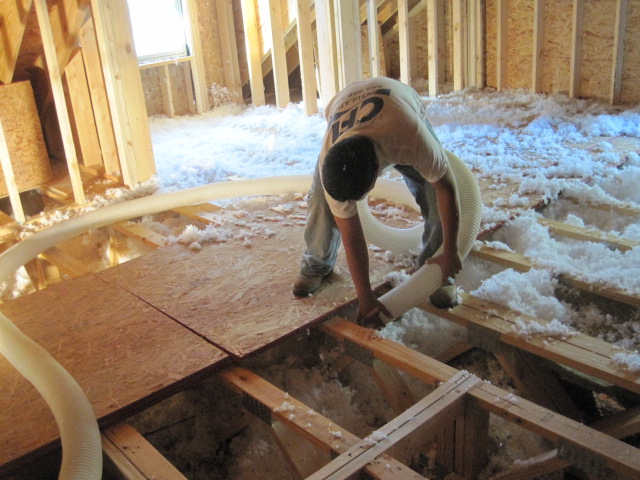

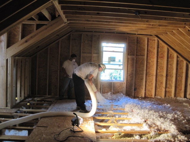

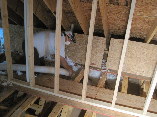

The ceiling insulation got blown yesterday. You can see where we had removed half of the attic OSB sheets. My wife stayed with the insulation guys the entire time to make sure they didn't miss any hard to reach areas. The ceilings are R-38 in the house, R-30 in the garage. The walls are R-19 in the house and R-13 in the garage.
Today, we had a laborer clean up the attic and screw down the OSB that we had removed. The screws in the OSB we re-attached are no longer countersunk and should be easier to find if I need to remove them again for ceiling access. There are advantages to hiring your own workers and paying them by the hour. You can get things done the way you want them without a bunch of arguments. When we renovated our last house, we hired a handyman and paid him by the hour. That worked out very well for us. I wish we knew someone like that here. The laborer we've been hiring is not equipped to do lots of skilled tasks. We've been using him for simple framing tasks and cleanup work.
Stanley,
I mentioned concreting the whole area to my wife a while back and the boss shot that idea down. She said it would be ugly. There are lots of things I can argue about but when she thinks something is ugly, all my arguments fall on deaf ears.
jcims,
I hadn't considered that. That's the first good reason I've heard for making the pad bigger than the unit.

Obed - You should take into consideration the location - N<W>E<S. East side would be best. Less exposure to sun and heat of the day in summer and winter weather. By the pics I am not sure what the overhang is across from the retaining wall. I would be ideal to provide overhead coverage. Like it was stated 2' or 3' from any wall and don't plant shrubs within 3' if you plan on trying to hide unit from view.
PAGUY
PAGUY,
The outside unit will be on the north side of the house and west of the retaining wall. This area is shaded much of the day during the summer. We didn't plan it that way; that's just where it ended up.

Really? Ugly like this? :)
attachment.php
Exposed aggregate is easy to do and looks really nice. This was a solution to a similar problem on a friend's house. You could also go with stained, pigmented, stamped concrete to make it look nicer. You really are going to hate mowing a spot of poorly growing grass back in that corner. No light = dirt patch.
