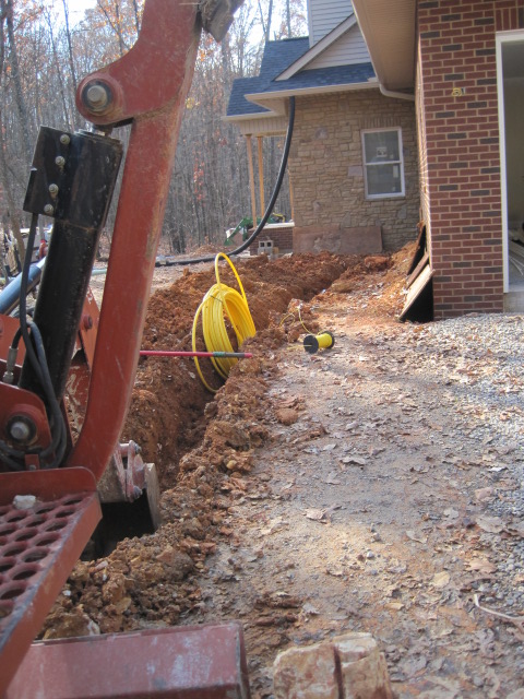

Natural Gas Line
The gas company ran the gas line the last 100 feet from the driveway to the house. What I didn't know was that the gas line has been pressurized for the past year. In order to connect two pieces of pipe, they put a clamp on the line to stop the gas pressure. They then used a tool to trim each end of the line to a perfect 90 degree cut. Then they pushed the two ends together and melted them together to bond the to sections of pipe together.
