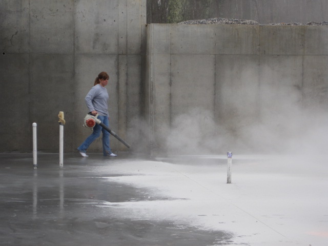

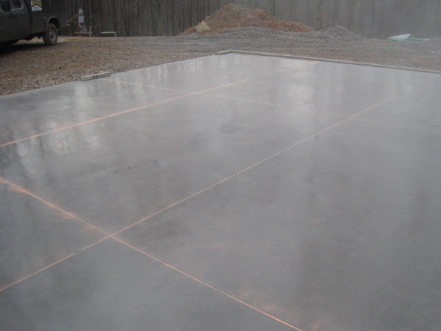

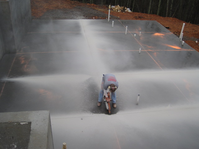

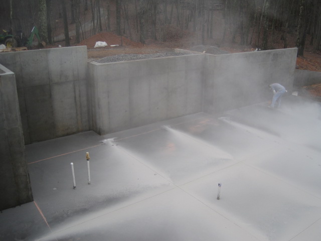

Monday evening under the lights the concrete workers finished all the flatwork other than cutting the stress joints. The last thing done Monday night was to seal the concrete. One of the workers was out there in his sock feet rolling the seal on the concrete with a roller.
Tuesday the stess joints were cut. The joints are approximately 10 feet apart. In the garage they are approximately 8 feet apart. Joints were cut at all the interior corners because concrete cracking is very prone at these spots.

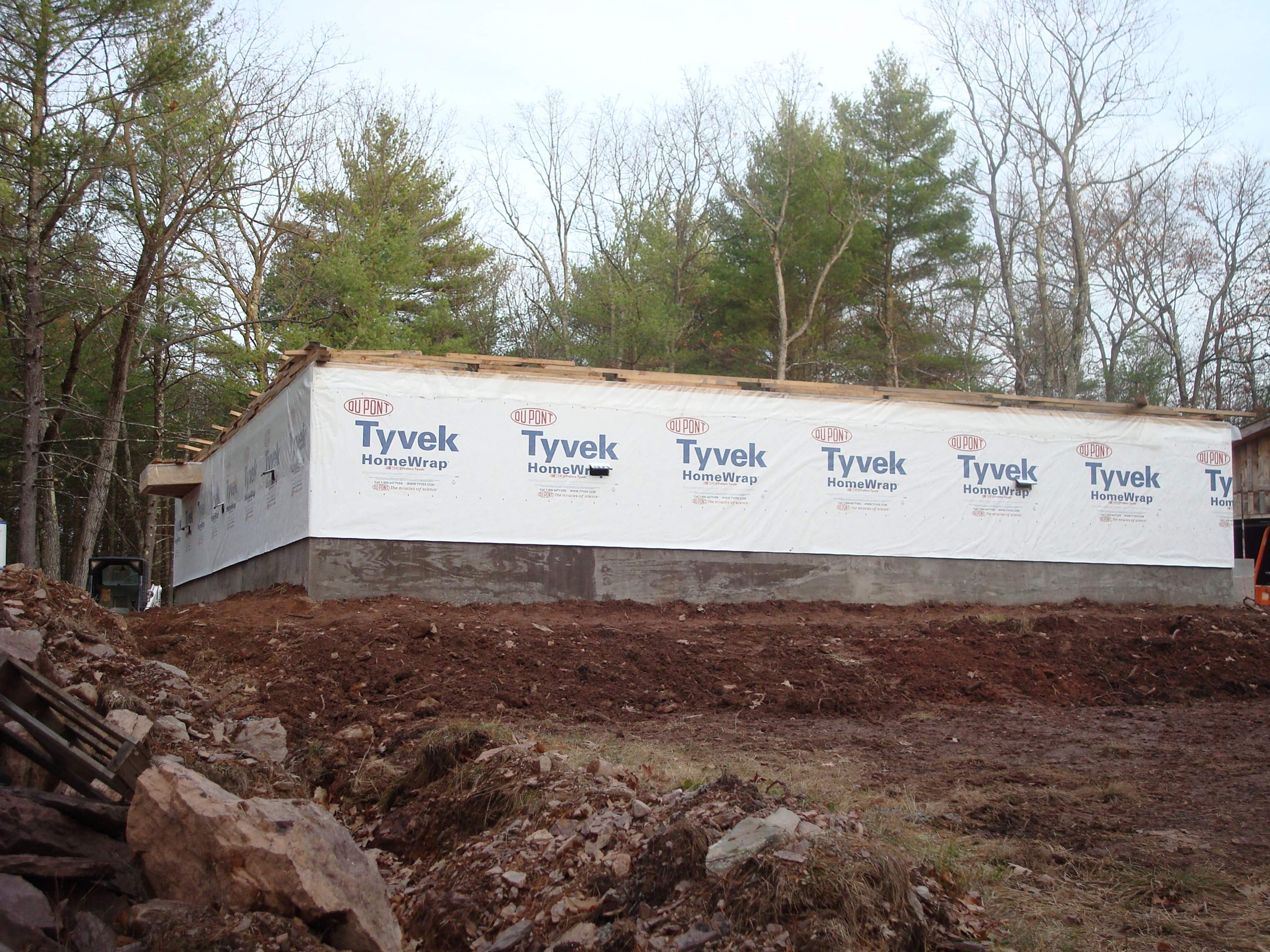

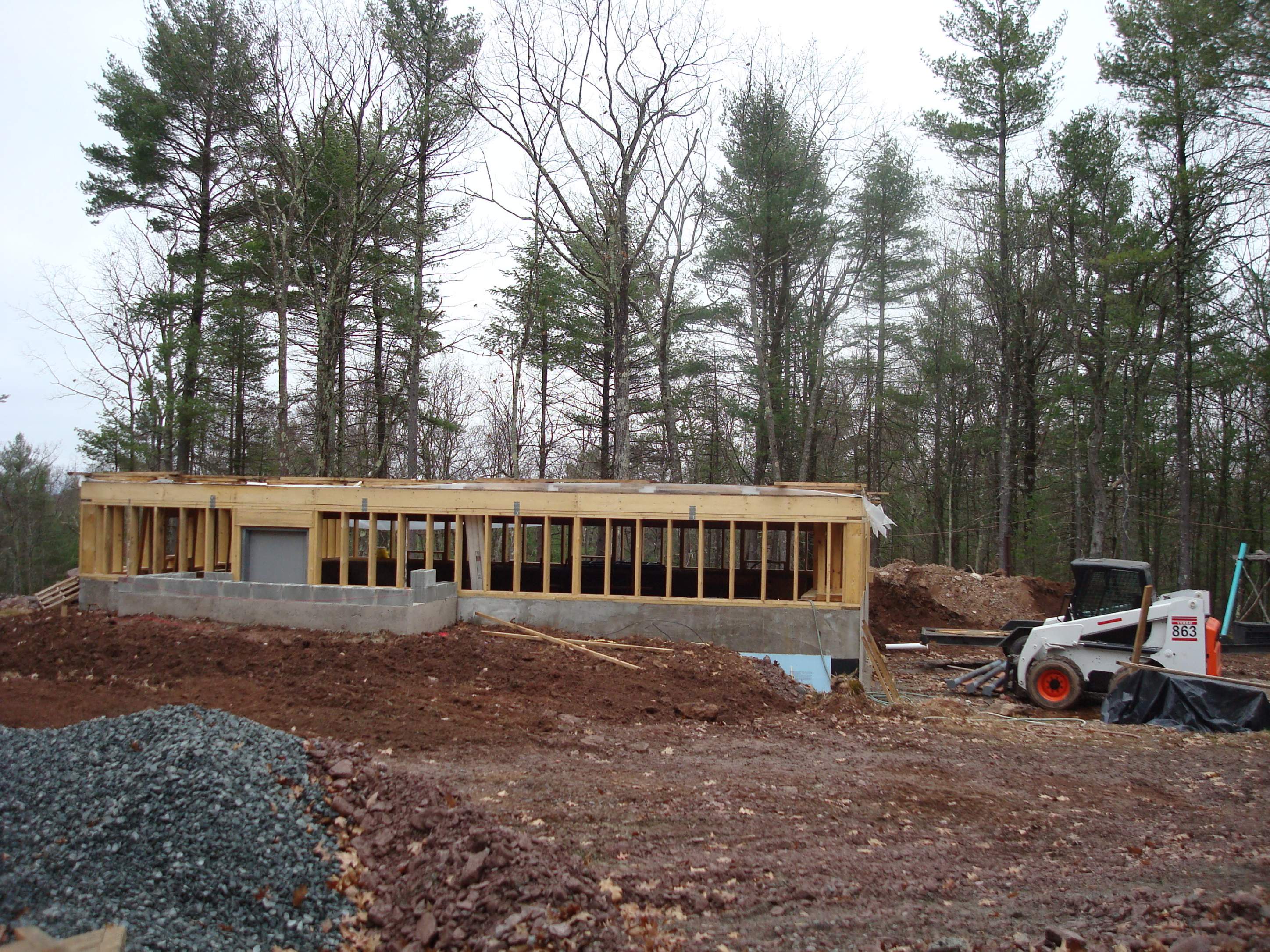

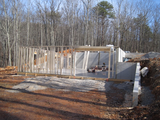

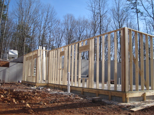

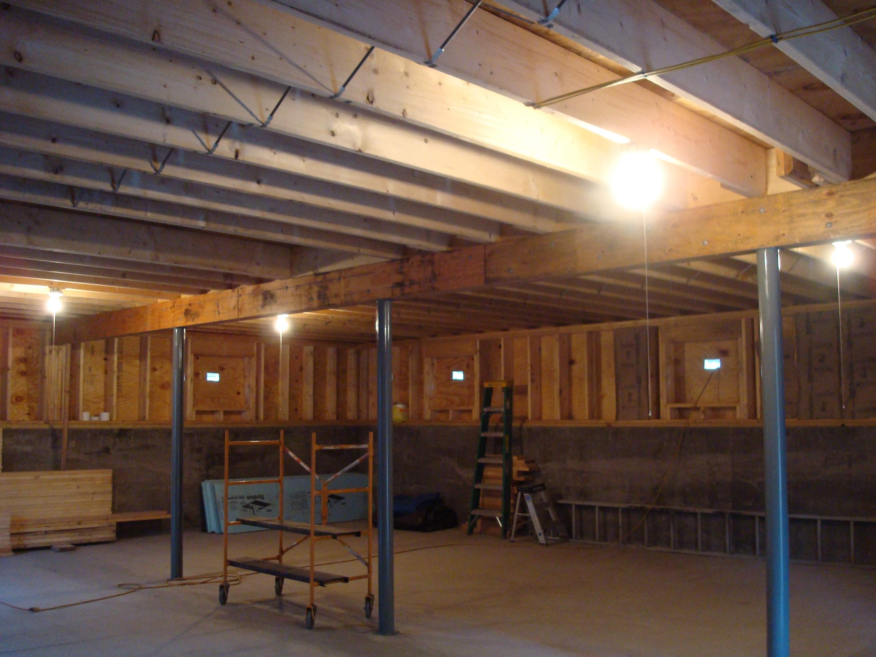

Wednesday the framing began.
