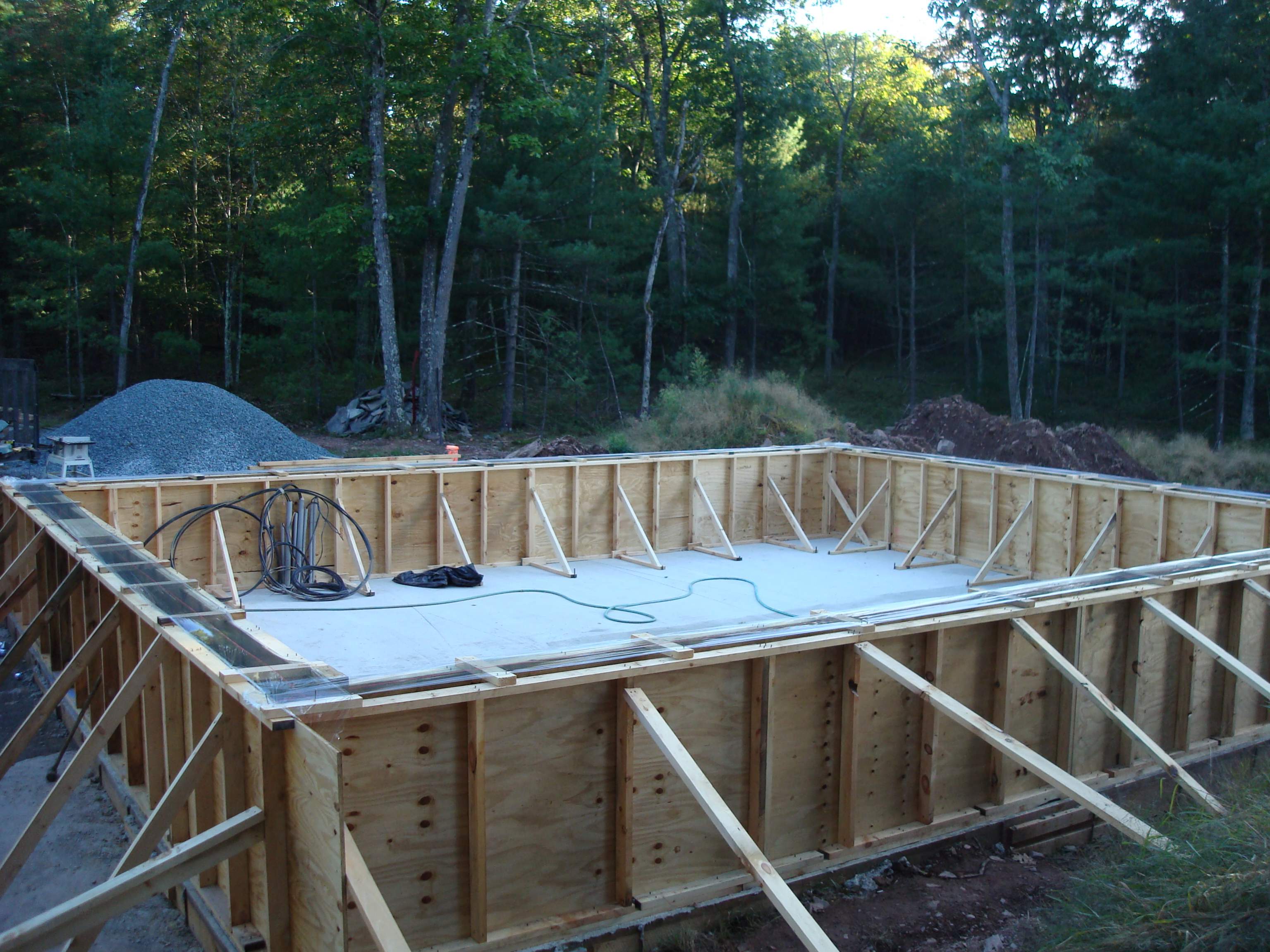

razvy,
I'm very impressed with your project. Thanks for posting the pictures. Did you build the forms for the poured walls yourself?
Obed
O yes , I use 4'x8'x3/4" plywood coated whit used motor oil which I used later for sheeting the floor, my walls are 10" thick and 4 ' high.
I like your concrete job, come out perfect , at mine I have lots of flows that's the price you pay when you work by yourself :rolleyes:
