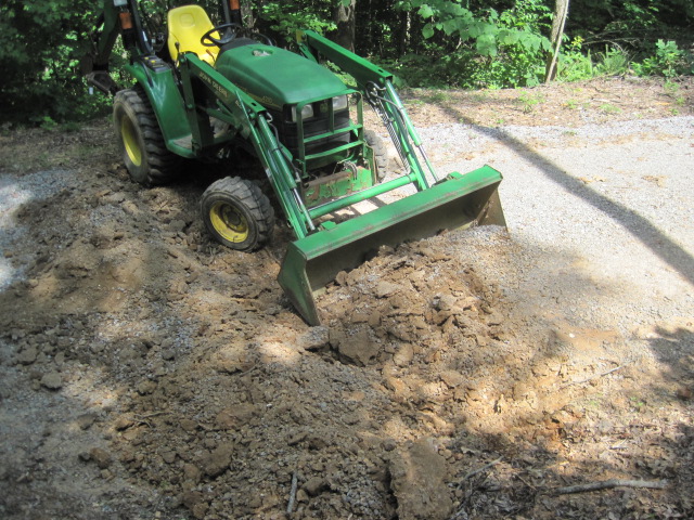

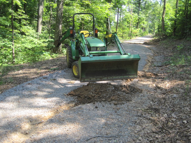

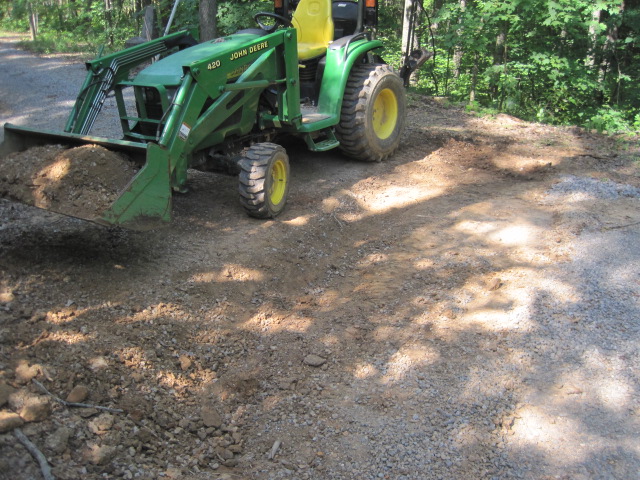

The heavy rains and storms we've been having resulted in a rut running down our driveway. Our driveway was constructed with a crown that runs down the middle of it for its entire length. The crown (i.e. hump) sheds water quickly off both sides of the road into the swales to prevent erosion in the road.
Our road has been in place for almost 2 years and has had very little maintenance done to it. We have a significant slope to the road in places but have had very little road washing issues. We designed our road based on information in the Gravel Road Maintenance Manual put out by the state of Maine. I highly recommend this guide for anyone building a gravel or dirt road.
When the huge hickory fell across our driveway last fall, we had a tree guy remove it for us. While the tree guy was here with his skidsteer, he thought he was doing us a favor and, with out asking me, graded flat a section of the crown on our driveway. He made sure to tell me, very proudly, how he removed the "hump" in our road and thought I would be pleased. I didn't say anything to him about it and might have even thanked him even though I was very perturbed. It's kind of hard to raise a fit when someone attempts to do you a good deed. He was trying to be nice and helpful; he just didn't know he was messing up our road. He really didn't have any business grading our road; he was here to remove a tree. It just so happens, not coincidentally, that that section of road is where the rut down our driveway developed.
Today I did some work to correct the rut that developed in our road. The first think I needed to do was try to limit the amount of water running down the high side swale. Thus I built two water bars. A water bar is basically a shallow trench that you run across the road to funnel water from the high side of the road to the low side. A water bar is a cheap way to avoid putting in a culvert. Culverts are expensive when you count the cost of the culvert, the gravel required around the culvert, and the labor.
I put the first water bar across the road above where the road was washing. I put the second water bar about 200 ft below the first one. If done correctly, the water bar will divert the water to the downhill side where it will run away from the road. A second advantage of the water bar is it acts as a speed bump. The contractors really drove fast on our road. I put in 3 water bars a year and a half ago. I didn't do a great job installing them so they didn't divert the water very well but they did slow down the contractors!
I used the extra dirt and gravel left from constructing the water bars to fill in the rut. I did some grading with the FEL and bebuilt the crown in this section of the road.

When you get your road really settled I myself put in some crossing in the road that would look like a U made from treated wood...They are on an angle--high side about three ft above discharge side-- and the opening is about four inches and about six or seven in deep...A plank on the bottom of the trench, and the two planks for the sides....They look quite attractive, and I keep them open with strategically placed block of wood , only about four by two in ...I keep them cleaned (once a yr) with a special hoe that is cut off so it reached down inside....They are still fine and at least twenty yrs old....When I put new gravel I just put it by hand where they cross. It is cheap and gives the road a finished look like the old time roads......Tony
