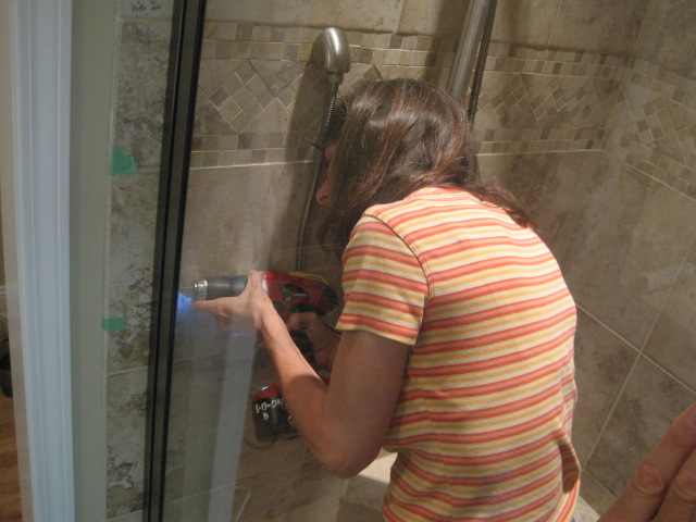

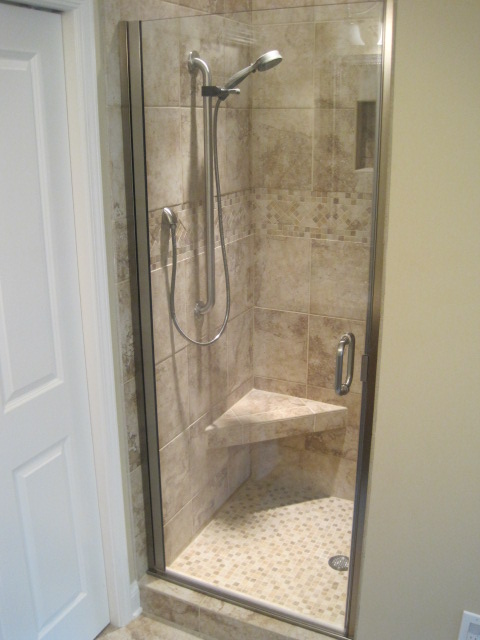

Finally we have a master bath we can use. Getting a properly working shower door was an endeavor. In May the first attempt at installing a shower door occurred. The door leaked at the bottom where the installer did not provide the threshold that should have come with the door. We ended up letting the company who sold and installed the door take it back. We didn't pay anything for it. We decided to buy a different door from another company and install it ourselves. With the expense involved putting in a tile shower, it really bugged me that the original shower door installation was obviously put in not square and plumb. Thus, we didn't want to go to the headache of having someone else install the door incorrectly.
My wife actually performed the installation. I just helped carry the door and hold it it in place. We made certain we had a threshold at the bottom of the door to prevent water from seeping out from under the door. Not having a threshold makes no sense to me.
The first thing my wife did was to purchase a chemical to help remove the silicon caulk that was left from the original door installation. Even using the chemical, she had to scrub and scrub to best remove the caulk. Removing the original caulk will help the new caulk to adhere to the tile. Next she filled in the holes drilled through the tile from the original door installation. Then she installed the threshold using only silicon caulk. You don't use screws to install the threshold because screw holes would provide a potential place for water to leak. She installed the door frame and then we installed the door. Lastly she caulked around the door frame.

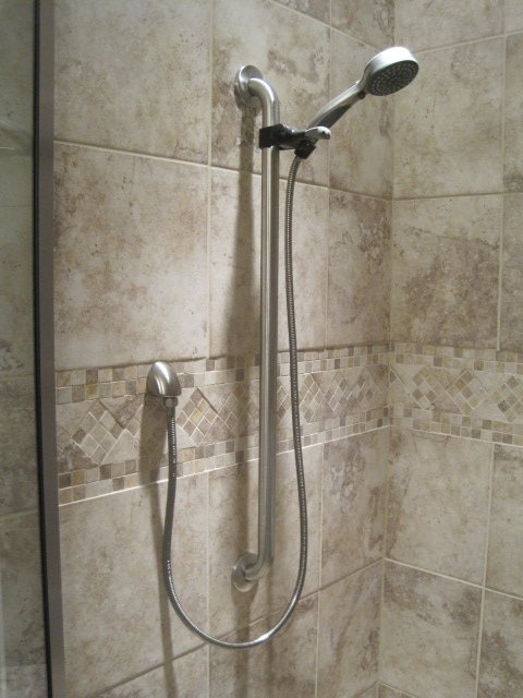

Tomorrow we get to use the shower! I'm confident my wife's installation will not leak. Don't be confused by the shower pictures; we have two shower heads in the shower. One shower head is attached to a flexible hose. My wife wanted the hand-held shower head to make it easier to clean the shower. We have the controls in the shower to use either shower head or both. There is enough room in the shower for two people, as long as they are opposite sexes and married.

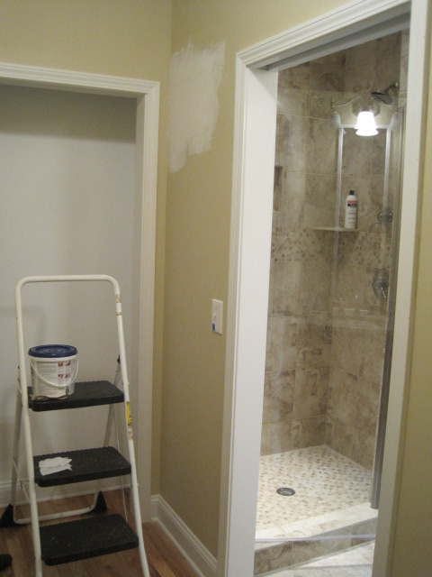

Locating the handheld shower head on the opposite wall from the main shower head was not part of the original shower design. We had originally planned to tap a flexible hose off of the primary shower head supply line. The two shower heads would have been located right beside each other. As part of the original shower plan, we installed blocking for a horizontally oriented grab bar, not a vertical grab bar. So the original blocking did not work when we decided to use a vertical grab bar to hold the handheld shower head.
After the walls were drywalled and painted we figured out we needed additional blocking to support the vertical grab bar we wanted to use. Therefore we had a worker cut a hole in the drywall behind the shower wall, install 2x10 blocking in the framing, and patch the drywall. My wife repainted the patch work. When it came time to install the vertical grab bar, we discovered that the new blocking had been installed in the wrong place. So my wife tore out the drywall behind the shower again, correctly installed the blocking, patched the wall, and repainted again. It took three tries to get the blocking for the vertical grab bar correct.

We bought the second shower door from a local company. The cost was $485 plus sales tax. There was obviously no installation cost; we installed it ourselves. Our glass shower door is the "frameless" kind. A tile shower is extremely expensive. I seem to think we only paid $300 for our fiberglass tub/shower in the hall bath. The hall shower curtain rod was $15 and the shower curtain was maybe $20. The glass door for the master shower cost more than the hall bath tub/shower.
