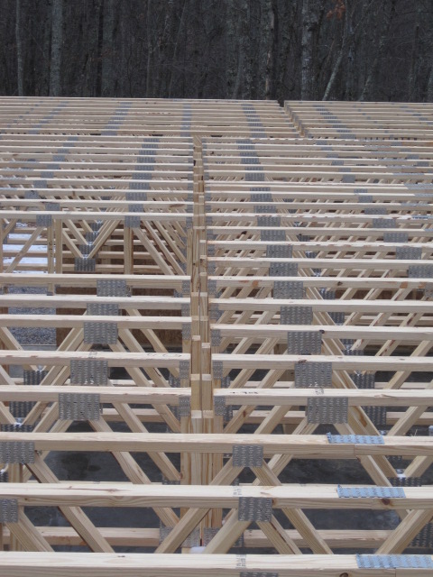

I spoke to the truss designer today about bracing. Bracing is accomplished in 3 ways.
1. The ends of the trusses are notched to accept a 2x4. You can see the notches in the first picture. The second and third pictures show trusses that have the 2x4's installed in the notches.
2. 2x6 strongbacks will be nailed to the uprights in the trusses at 10' O.C. The strongbacks might not be installed until after the ductwork and plumbing has been run.
3. 1x4 boards will be nailed to the bottom chords at 10' O.C. to provide less vibration when walking on the floors for a sturdier feel.
Diagonal bracing is not required according to the truss designer. The Advantech subflooring is tongue and grove. The subflooring will be glued and screwed. Glue will go under the flooring and also in the tongue and grooves. The truss designer said that the trusses will be in good shape using these steps.

This picture shows the trusses sitting on the center bearing wall. Note the notches at the ends of in the trusses where the 2x4s will be nailed. You are seeing 2 trusses that meet in the middle where the center bearing walls are underneath. Our center bearing wall has a couple zags to accommodate the future basement floor plan.
