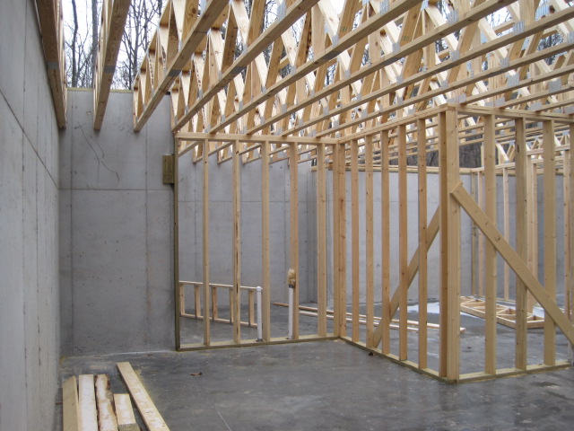

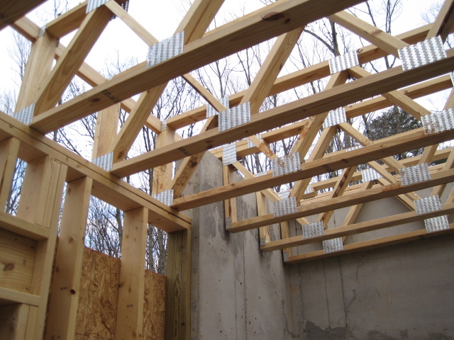

The trusses on the end of the house beside the main floor garage are top chord bearing. The concrete walls at this point are 12' high in order to get the garage slab on grade with only a 7" step into the kitchen. The top chord bearing trusses hang on the walls by the top chord. The rest of the concrete and framed walls are 10' high and have bottom chord bearing trusses sitting on top of the walls.

With your 19 inch centers, what will you use for the ceilings? 1/2 inch or 5/8 sheetrock? or are you using sheetrock?
I like the trusses. I've never worked with that style of truss, so I'm finding them to be very interesting. Did you compare them to engineered I beams? Just curious what the difference was that made you decide on this type of truss.

Eddie, when we finish the basement we'll put in a drop ceiling. I like having access to the plumbing, etc. so prefer to avoid sheetrock in the basement ceiling if possible.
These trusses make it easy to run plumbing, ductwork, electrical, etc. through the trusses. While I'm not a builder, it seems to me that running stuff through I-joists would be harder because you have to cut holes in the I-joists to run things through them. We specified 24" trusses in the house plans to give ample room for running ductwork, etc. Do the I-joists come in 24" heights? The ones I've seen aren't that tall.
