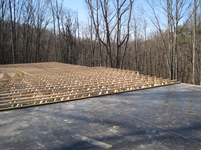

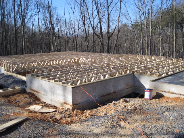

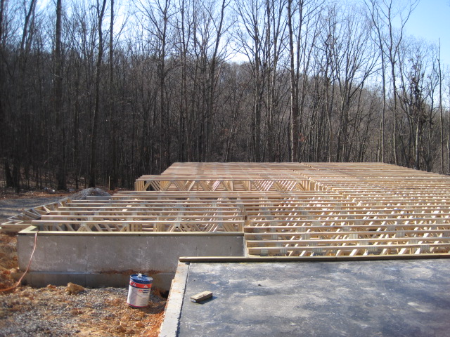

Here are some pictures of the floor trusses that were taken last week before Thursday's snow. Not much has happened since. The Advantek subflooring will be installed tomorrow.

Pics look good Obed, you went 16" centers?

Great looking house. Glad to see the headers were added on the end walls. I still don't get the truss spacing though, I would have went 16" oc, and would have used a beam instead of load bearing wall on a slab. Hope the leveling works for you. I hate squeeky floors, and I have them. I glued and nailed my subfloor, wish I had screwed it. Whenever I need to replace carpet, I will go back and put in some screws.

The joists are looking good. I'm also comfused by the 19.2" spacing. Although, I just did the math and it does work out for 8ft sheets. Must not be a 4ft offset between rows.
The trusses look nice. There is a certain amount of beauty in seeing them all ligned up when they are installed.
What did you use to shim them?
I'm unsure, but when looking at the pictures, I didn't see any diagnal bracing from the top of each truss, to the bottom of the one next to it. The pictures don't show between them, so I might not be seeing it. I've never heard of them not having diagnal bracing, so it's something that I'm curious about.
Will they block the space between the trusses before putting down the decking? or will that be left open and covered by the siding? I always block between so I have a solid support from the concrete for the walls to rest on.
Or did these things get done after the picture was taken, and before the decking was installed?
