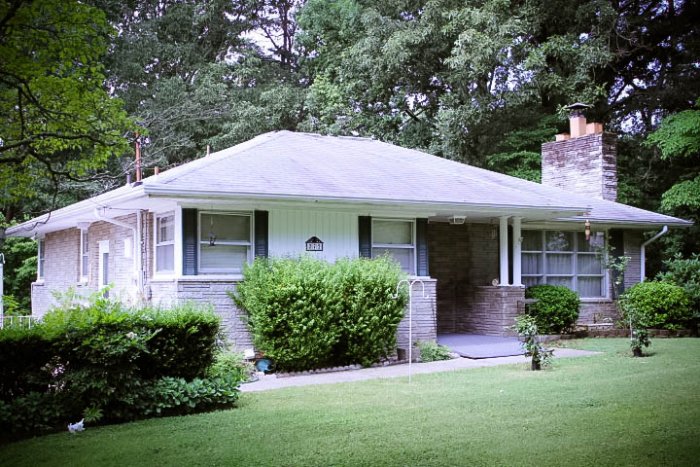

We bought a rental house. That's been keeping me busy. The house is less than 2 miles from our property.
   / At Home In The Woods #5,432
That is a nice looking place. I used to rent a couple of our houses. It can turn into a major PITA. We have sold one, and may end up selling the other. My advice is to charge enough rent to weed out any trouble makers. Good luck.

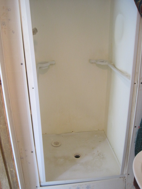

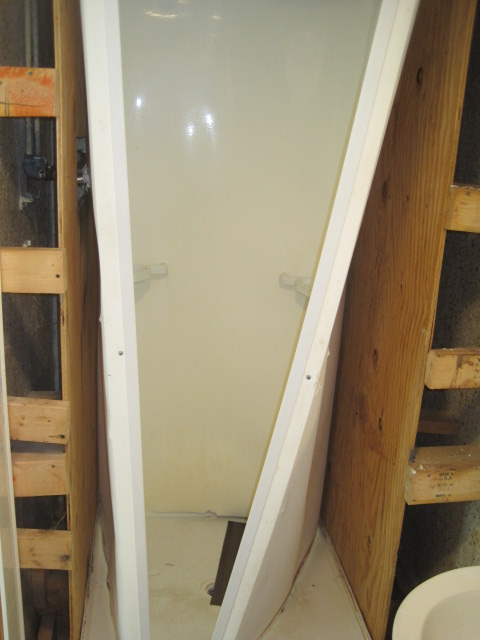

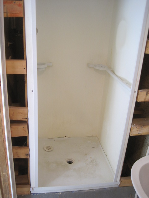

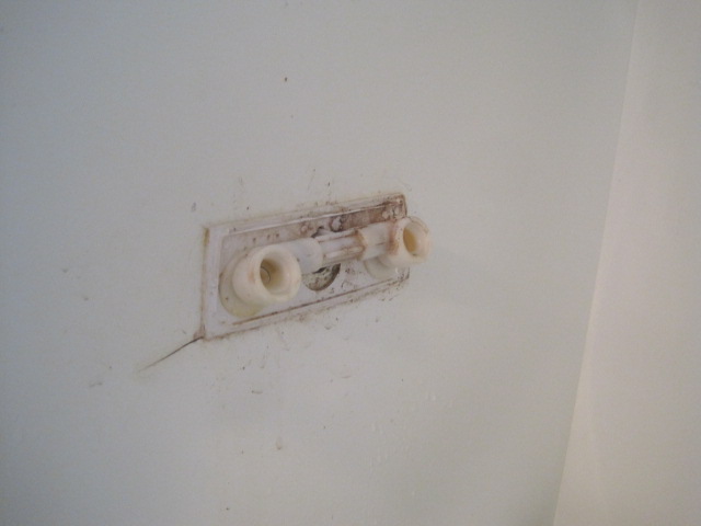

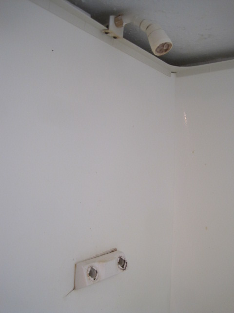

This shower has been quite a job. The shower is a cheap plastic insert that was placed inside an existing concrete block walled shower in the basement.

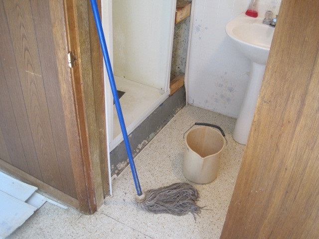

The shower pan was cracked so I had to remove the entire shower. When I removed the shower faucet handles and parts, I didn't realize I was actually removing the under water pressure valves. One of the valves popped out and water started spraying everywhere. I had to race to the street to turn off the water.

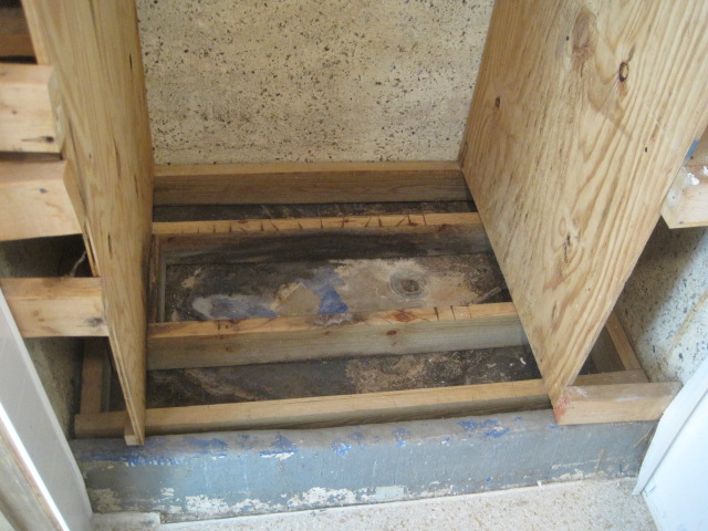

The original framing for this shower insert was a real hack job. Many of the 2x4s were just screwed to the plywood on one end but there was nothing attaching the other end of the 2x4s to the contrete wall. The farthest ends of the plywood were just hanging in mid-air without anything attaching them to the concrete walls. I debated over and over whether or not to improve the framing. I finally decided to fix the framing which increased the size of the job.
The plastic shower pan was sitting on a 2x6 frame sitting inside the old shower. The plastic pan had very little support which probably caused the cracks in the shower pan.

BTW, a plastic shower base, or a better fiberglass base, ought to be placed over a bed of mortar mix/quickcrete, (something along those lines- I can't remember the correct mix at this moment) to keep it solid and quiet, and from cracking/breaking.
You get what you pay for in a shower surround and base. Cheap crap is NOT the way to go. Shutoffs, easily accessible in the house, close to the shower too. And if you do any toilet replacements use 1/4 turn shutoffs NOT faucet type knobs; they, 1/4 turns are the cat's wiskers- all my plumbers switched to them, and have never looked back.
