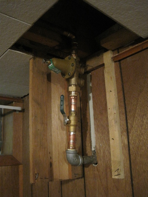

The next door neighbor to the rental house is a plumber and seems to be a really good chap. I paid him to install a pressure reducer and put in a new cut-off valve where the city water enters the house. The house had no pressure reducer and was exposed to whatever pressure was at the street. That made me nervous.

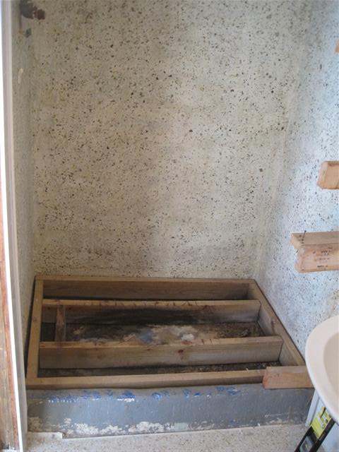

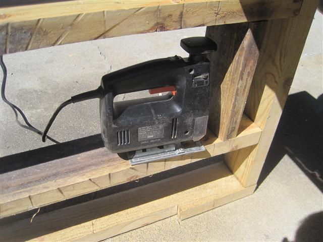

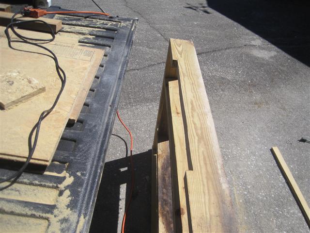

The framing around the rental house's basement shower was not very good. I debated whether or not to reframe it. I really went back and forth. However, end the end I just couldn't leave the framing like it was. I removed most of the framing and started from scratch.
The framing under the shower gave inadequate support to the shower pan which is probably why the shower pan cracked. I decided to put a piece of Advantak under the new pan. I had not room to raise the height of the shower so I had to notch out the floor joists and in order to recess the Advantak flush.

I screwed some pressure treated 2x4s to the concrete block walls using tapcon screws. The original shower framing was not attached to the concrete; it just had some 2x4s resting against the concrete but not attached.
