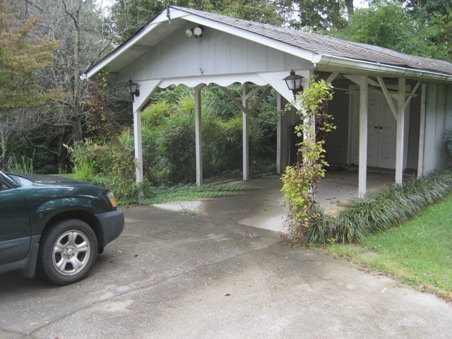

   / At Home In The Woods #5,457
I observed that rain runs from the concrete parking pad into the carport. As a result, the bottom of one of the wood carport walls gets wet when it rains. I need to divert the water. Does anybody have any suggestions?
Obed
Here is a quick and easy way to remedy MOST of the problem.
First: clean out the joint between the driveway and carport pads (using a grinder if needed).
Second: cut some rubber strips (3/4 - 1" wide depending on the depth of the cleaned out joint) from some rubber inner tubes, e.g. They don't have to be one piece long enough to reach
across the whole length of the joint but can be overlapped.
Third: put some silicone caulk into the joint and imbed the rubber strips on edge into the silicone (overlapping if necessary.) This will leave only about 1/2 inch or so protruding above the concrete.
This will be enough to effectively redirect the water to the side if there is some fall, which there
appears to be.
This thin barrier will go unnoticed when one drives over it and it is resilient enough to return to the upright position after being driven over.
I have even used just the caulk in a 3/8 inch bead to do much the same thing but the rubber would work better in your case, I believe.
HTH
Arkaybee
   / At Home In The Woods #5,458
Hi
I can't speak for how well this idea will or will not work BUT... Do not use a car or truck innertube. After a year in the sun or light, the UV rays will deteriorate the rubber and it will start to break down. If you want this to be a success find another material to use instead of car innertube. :)
Cheers :drink:
Don
   / At Home In The Woods #5,459
Obed
appears to be.
HTH
Arkaybee
Hi
Cheers :drink:
Don
conveyor belt is a good choice long life not normally tire rubber and will last a while it can be used in short but most use a 10" piece of belting with PT 2x6's on both sides and bury in a trench with the top an inch above grade and angled int the direction down hill. The 2x6's kep it in place as an anchor.
tom
   / At Home In The Woods #5,460
concrete hump at the edge or somewhere to divert the water whereever it comes from.
