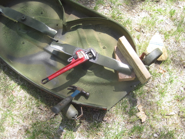

Today I decided to sharpen my Kubuta mower blades.
I didn't have a wrench big enough for the bolt head so I used a pipe wrench. I couldn't break loose the bolt. I even banged on the wrench handle with a hammer to no effect.
So I got out my torch. I'd heard you could break bolts loose with heat. I didn't have a clue what I was doing. I put some heat on the head of the bolt and tried banging on the wrench again with a hammer. Nothing happened. There's probably a technique to heating the bolts which I don't know.

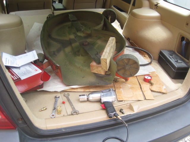

I remembered that last time I was trying to remove a rusty bolt, you guys told me that I need an impact wrench. So I went to the box store and got this 300 ft-lb impact wrench. The box store didn't have sockets big enough. So I went to Andvanced Auto and bought a 30 mm socket $9.
I hooked the wrench to my little air compressor and charged to compressor to 100 psi. Unfortunately, when I tried to remove the bolt with the impact wrench, the bolt still didn't budge.
So I went back to the box store and exchanged the 300 ft-lb wrench for a 500 ft-lb wrench. When I got home, I couldn't find my 30 mm socket. I occurred to me that I might have left the new 30 mm socket on the wrench I had returned to the box store. I called the store, asked them to look in the box. Sure enough, my 30 mm socket was in their box. It's a 20 minute drive each way to the box store. It was now 5 PM. I had made that drive twice already today. Time to quit for today. Tomorrow I'll go get my 30 mm socket and try again.

Sure you're turning it the right way? Just sayin... BTDT :eek:
There are a combination of techniques that work for stuck bolts.
1. Penetrating oil, and let it soak for a while
2. Heat, and lots of it. This can break loose rust, especially once it starts cooling back down
3. Impact tools. Sometimes you have to spend a lot of time banging away with the impact to loosen really frozen fasteners. You need a compressor that can keep up, or give it time to recover. I once spent 45 min on and off to get a crank bolt loose from a Honda civic...
4. Breaker bar. With pipe extension as required. Sometimes lots of leverage and a slow push does better than an impact. Sometimes not.
The more direct you are, the better - no socket extensions or universal joints, if at all possible as they add flex to the system and soak up energy. Sometimes unavoidable, but something to be aware of.
Dave,
My compressor will not keep up. I had to give it lots of time to recover before trying again. I can't say I want to take 45 minutes to break this bolt loose.
I noticed an air leak sound from the Husky impact wrench after I hooked it to the hose. Is that normal for impact wrenches? Or is Husky just a cheap brand from the box store. After I removed the wrench from the hose, the air leak sound stopped.
Obed
   / At Home In The Woods #5,640
It is probably the quick connect fitting on the hose that is leaking. Cheapo fitting or bad o-ring. When you disconnect it the oring does not do anything as it only seals to the fitting on the tool. Small leak - probably not worth it. Bigger leak, just replace the fitting. Make sure the male fitting on the tool is smooth and doesn't have any major dings on it, as that could be the source and could damage the o-ring.
And of course, it is quite obvious...you need a bigger compressor! "Honey?.... The guys on TBN said..." :devil: But seriously, if you don't have enough air delivery, a bigger wrench won't help as it will have the same air limitations. Bigger compressor, or more storage volume (extra tanks ganged together) plus a decent sized hose - no 1/4" air nailer hoses for this. 3/8" for sure. Impact wrenches need some decent air for any use beyond simple lug nuts. Doesn't mean you need a 50A/240V 80gal 2-stage compressor, but the more the better. A pancake compressor made for air nailers just wont' work. Trust me. I've tried it... What do you have?
Get a 1/2" drive breaker bar and a pipe that will fit over it. Easy does it as you can break stuff this way and get hurt. 2-3' pipe is usually plenty, but you can always choke up on a longer pipe. The bigger problem with a long pipe is enough room to swing it. Probably not a big issue on a mower deck like that, but often is for car work. Plus you need to secure everything from moving on you - the deck and blades. You will need to wedge it against something solid or clamp to a sturdy table.
