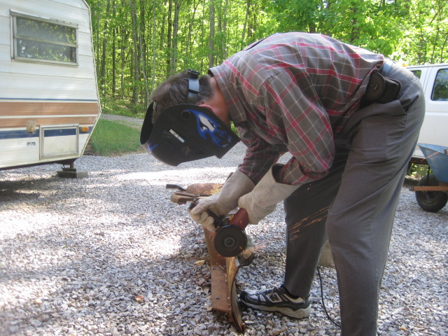

I used the angle grinder to sharpen the mower blades. That angle grinder certainly has been useful. Thanks for the suggestion guys!
Obed, Though one can sharpen blades on the mower it is best to remove them and sharpen them in a vise, then balance each blade on the little balance tool found in any hardware store. When you sharpen freehand there is much greater likelihood of being out of balance. Also while the blades are removed you should be checking each blade for straightness by laying one on top of another to start, and then if one seems bent check all closely. Also check for cracks in the metal or excessive gouges/cracks in the cutting edges. Do NOT attempt to straighten a bent blade, toss it/them and get new ones.:thumbsup:
   / At Home In The Woods #5,659
Very thorough coyote! You forgot to tell one important detail!!!! Turn the motor off!!! Today you can't be too careful! Lol
