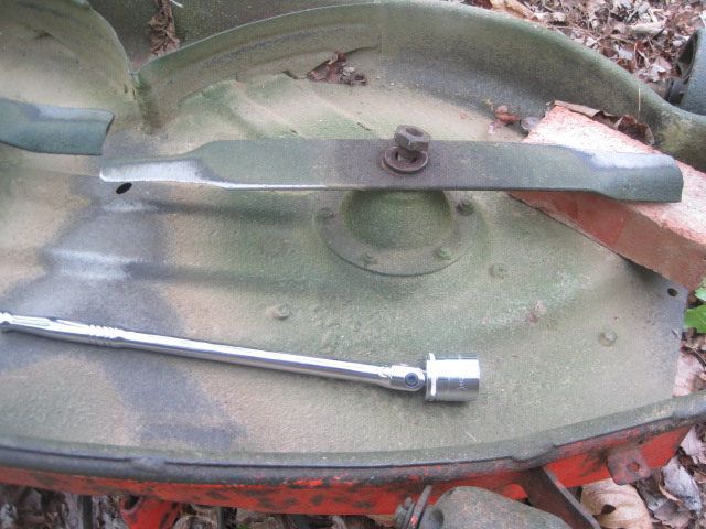

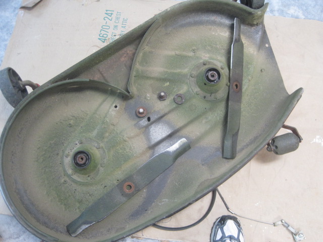

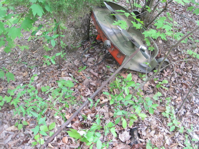

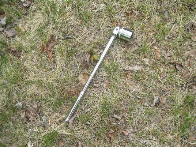

Success!
I ditched the impact wrench and bought a 15" breaker bar today.
I wedged the mower deck between two trees. I attached the 30 mm socket and slipped a 4' steel pipe over the breaker bar handle.
The bolts broke loose easy without any issues. The bolts really weren't that rusty; the threads look to be in good condition. After removing the mover blades, it became apparent that heating around the bolt to break it loose would be fruitless. The mower blade and cup that surrounds the bushing would obstruct any heat from reaching the threads.
One win from this endeavor is I now have a 1/2 breaker bar and a 3/8 breaker bar, both which I bought today. I probably will look into getting an electric impact wrench for tight spots for which the breaker bar won't fit. My air compressor is not big enough to power an impact wrench. I might like a corded electric impact wrench. Or if I could get a reasonably powerful battery impact wrench that is also a drill, I might consider that.
