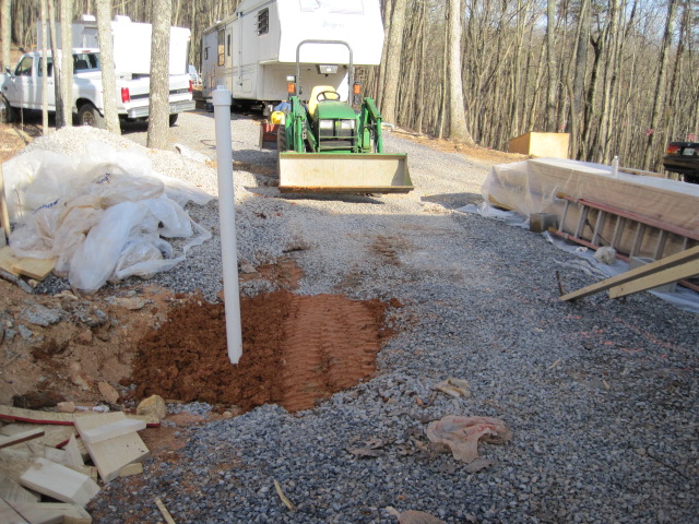

Here's a cleanout for the septic pipe that runs from the camper to the septic tank. When I installed the cleanout (http://www.tractorbynet.com/forums/projects/157965-home-woods-7.html#post1816307, I purposely did not fill the hole around the cleanout. I figured that by leaving the hole open, I might minimize the chance that a construction or delivery vehicle might back into the cleanout pipe. About a week later, the gravel delivery truck dumped gravel beside the cleanout and filled the hole with gravel. So much for my plans. Unfortunately, I had not glued the verticle pipe that connects to the cleanout joint. So today I removed the gravel out of the hole with a hand shovel and glued the verticle pipe to the cleanout. This picture shows gravel around the pipe before I started today.

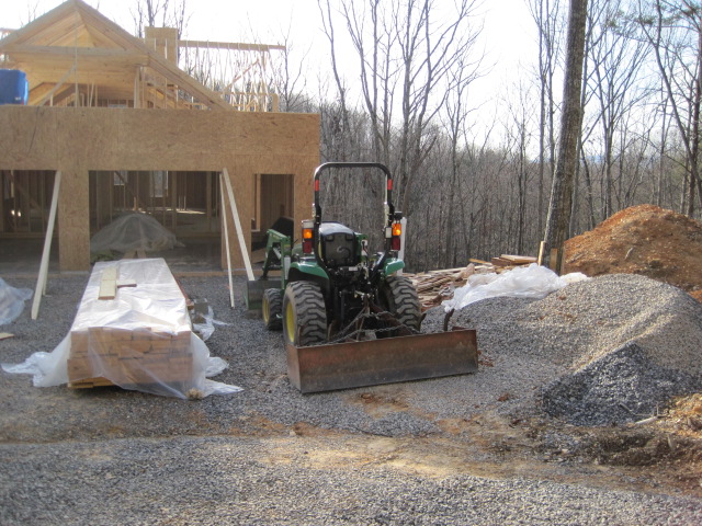

   / At Home In The Woods
#806

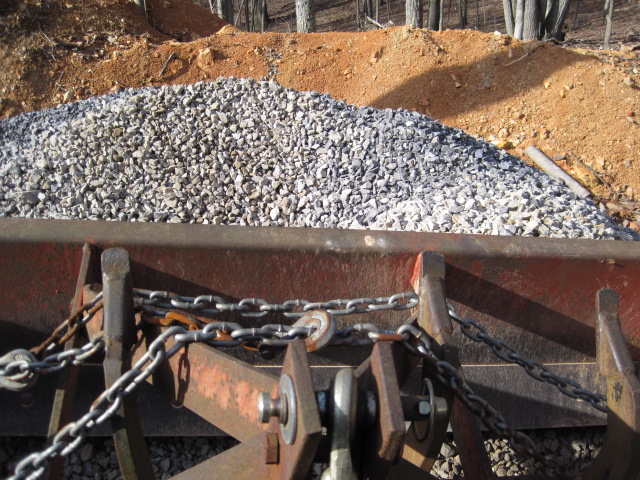

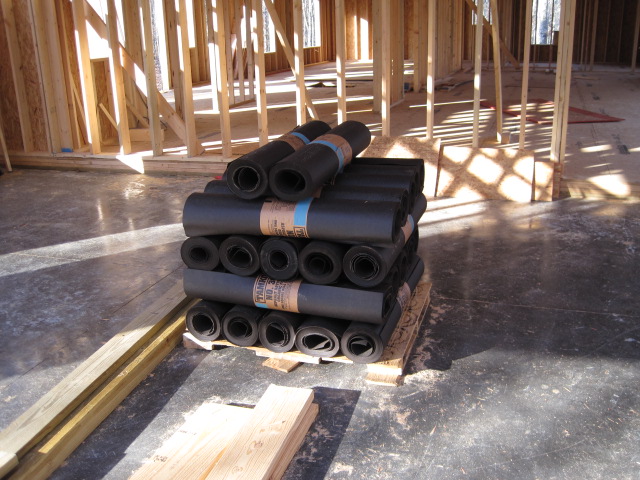

The first thing I did was move this load of roofing felt. I had do move it by hand, one roll at a time. I moved the felt into the garage where it would be out of the way.
I've had a constant challenge with the building supply company unloading materials and blocking access to things. I wasn't able to get the tractor to the gravel pile near this pallet of felt for several weeks because of lumber that got unloaded in front of the gravel pile. If I'm at home when I hear the backup beeping of the delivery man's backhoe, I always run out there and make sure they leave room for parking our cars and leave a turn-around spot in the driveway. We have plenty of room in front of the house for materials but for some reason the delivery trucks keep dumping stuff in a spot that cuts off access to the front of the house. Then there's very little room to unload subsequent deliveries.

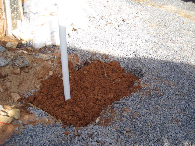

#807
Here's the hole after I removed the gravel with my hand shovel. The picture doesn't look like much but that was a lot if hard digging. My back is tire this evening.

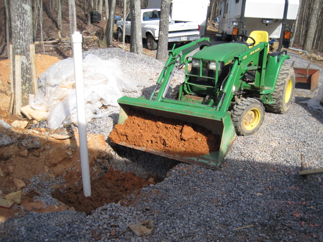

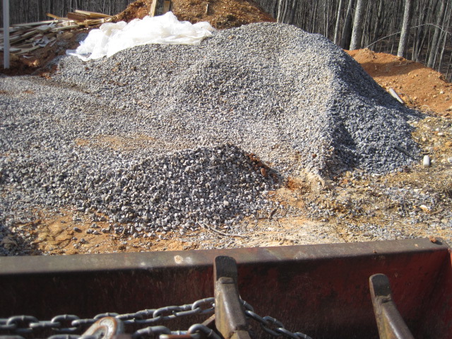

#808
The wife gave me orders not to refill the hole with gravel but to put dirt in it. There were several inches of gravel beside the hole that I drug away with the boxblade. I used the boxblade as a bulldozer to push the gravel onto the gravel pile. The pipe is leaning over some; that's the way it was originally. Some pictures make the lean look worse than others because of the angle of the camera.

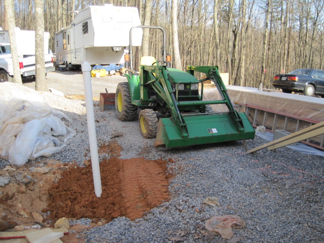

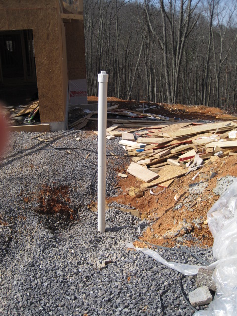

#809
Here's the finished product. It doesn't seem like much but this project took several hours due to all the hand shovelling and a flat right front tire. I had to pump up the tire with a bicycle pump at the begining of this project. I left the tractor parked there to prevent building materials from getting unloaded at that spot again. This next weekend I need to grade the area where the back porch and deck will be located. I would have graded the porch and deck area weeks ago except I couldn't get my tractor to that spot because of the building materials.
