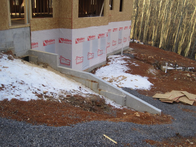

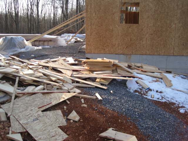

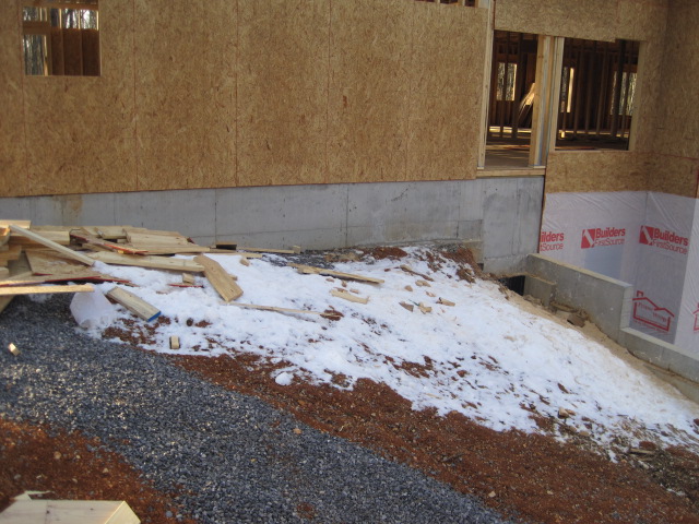

#813
These pictures are of the back of the house/garage. Along this wall all the way to the retaining wall will be a screened-in back porch and deck. The back porch will be to the left of the retaining wall from the perspective shown in the pictures. The far right wall of the porch will sit above the retaining wall. The deck will be to the left of the porch. We've asked the framer to remove all the wood waste this week so I can grade the dirt under the deck and porch. this weekend. I would like the dirt under the deck (and porch) to be at least 12" below the bottom of the porch framing to mimize water damage by rain splashing off the dirt.
Next week two footers will be poured, one for a corner of the deck, another for the corner of the porch.

   / At Home In The Woods #814
Obed,
One of the things that inspectors look at is how clean the jobsite it. A sloppy jobsite indicates other issues. A clean site sends a very strong signal, and one that you may want to consider.
I know allot of home owners will save money by doing all the clean up themselves, and it's a good idea that I support, but it has to be done almost daily to avoid injury and delays.

   / At Home In The Woods #815
As cold as it's been here and in TN I can't believe there is any scrap wood on the ground. When I help my friend frame houses during winter break (2 weeks at Christmas) we burned every scrap piece of wood to stay warm. We had a burn barrel that we burned the scraps in. When we would get cold we'd go stand by the burn barrel.
Chris
   / At Home In The Woods #816
I used a custom builder (he was a trim carpenter who had been a framer) to build our last house. He did a lot of the cleanup himself to keep costs down. As the dumpster filled I would tamp it down with my backhoe to maximize its capacity. I would gather up all the usable "scrap" for my own later use. I'd kid the builder that all the scrap up to 8 feet was mine, he wanted to return all unused material for credit. When the house was complete, he wrote us a check. He came from the old school where he mismanaged the job if the customer owed him money at the end of the job.
   / At Home In The Woods #817
One note about the scraps. Be sure to keep enough around for the electrician, plumber, HVAC, etc. to be used for blocking as well as toe boards for the roofer. If you don't they will go after the good stuff.
And, as for blocking, you might want to be considering blocking for towel bars, hand rails, curtains, blinds, and such. Get them in place before the trades. It's easier to run a wire around a block than a block around a wire.

Shane,
Great suggestions. I went out this evening and pulled out a bunch of scrap wood that could be used for blocking. I put aside boards that were at least 15" long that would fit between the studs.
