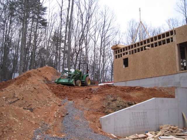

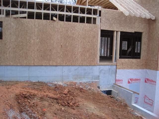

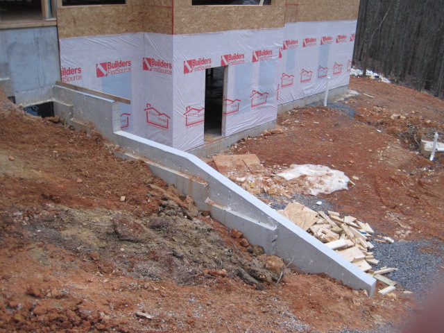

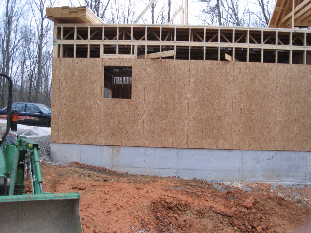

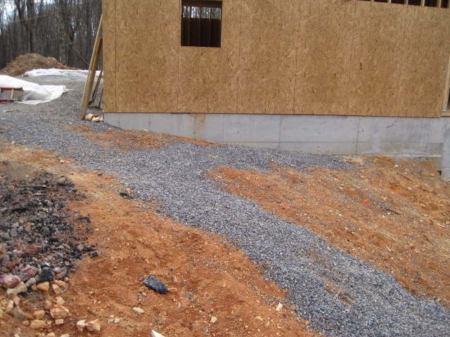

The first picture is the "before" shot. The other pictures show how far I got today. I doesn't look like much from the pictures but I did make progress. I was hoping to finish it today but it was just too difficult to quickly dig that hard clay. It was amazing how slow it was to remove 12" of that hard clay. I have removed most of the necessary dirt. Tomorrow I plan to remove the remaining extra dirt and work on smoothing and sloping away from the house.

I second Curly Dave's position on stone and fabric for drainage. I would not be concerned about splashback onto the deck boards or support structure. What you use for deck support will be PT anyway so its not a big deal and if you use Azek as I suggested earlier you will have no water dripping down off the decking onto the structural lumber underneath.
What needs to happen is to keep ALL water running away from the house on its own power, ie. gravity and proper grading.
I would run continuous 4" perforated pipe from the highest point, covered in a filter sock- available in 100' lengths from HD, etc. The perforations need to be pointed DOWN to the ground so any ground water goes into the pipe and follows along to daylight. I would also cover the pipe with stone, after laying it on a bed of stone along the entire foundation perimeter. You may already have footing drains along the perimeter and along the retaining wall but with clay, read zero drainage factor, having a close to surface drain to keep any water from getting between the wall and the clay can't hurt. Now is the time to make it happen; too difficult and inaccessible later.
