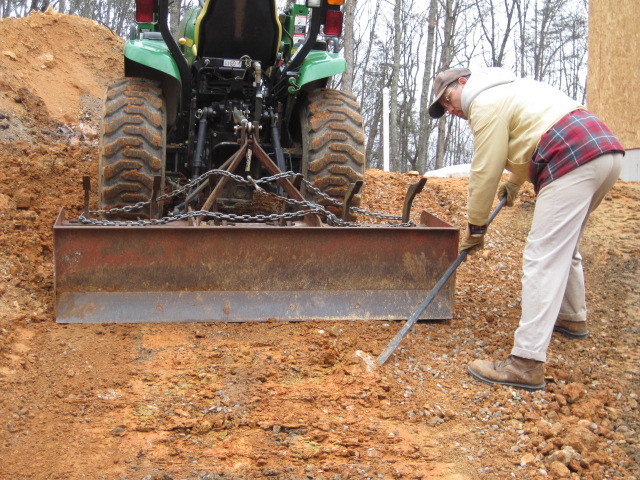

This area was filled with red clay by the excavator last fall. I'm not sure why he added fill here. He was not supposed to add to the natural grade and doing so here would just made the slope behind the house steeper. He added a good 12" of clay to this area. The clay has packed incredibly hard and has lots of rocks in it. I went back and between using the FEL and the box blade for digging the dirt. The tractor had an extremely tough time cutting through the clay. It was slow, slow, slow work. Often I would have to get my 6 foot steel digging bar and pry a rock out of the clay because that was faster than getting the rock out with the FEL. The boxblade was useless for digging rocks larger than a softball out of the packed clay.
The wife asked me why I did not use the scarifiers on the boxblade to break up the hard packed clay. Actually, I did not think of using them. However, upon reflection, I'm afraid that I would break them when they would inevitably catch on one of the rocks.

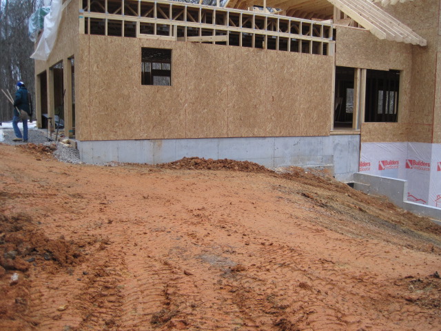

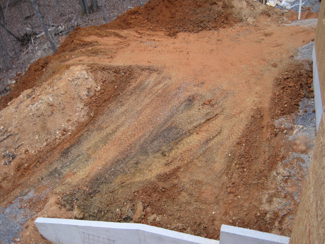

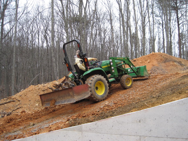

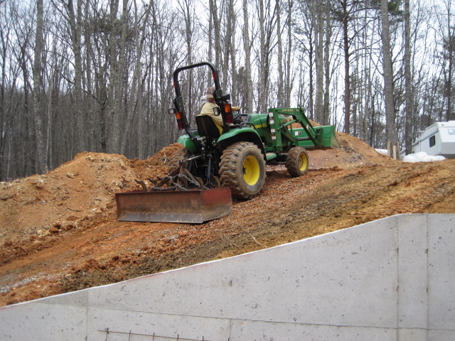

I spent today finishing the grading for the back porch and deck. The weatherman didn't quite get it right. Today's forecast was a high of 45 F and partly sunny. It was overcast all day with a high of 38 F. Grading this steep area was nerve racking.
I'm thrilled I got this task done. I've been concerned about the grading of this area all winter but haven't been able to do anything about it because building materials have blocked my access to this spot. It took two days of work but it's now done. I'll have to fine-tune by hand the areas next to the concrete when the brick gets laid.

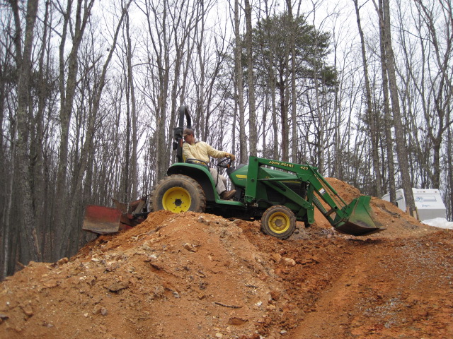

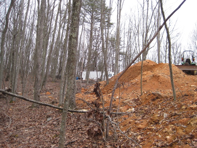

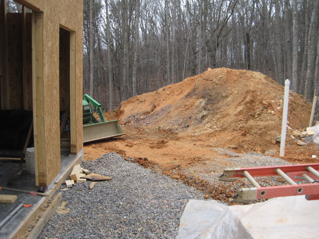

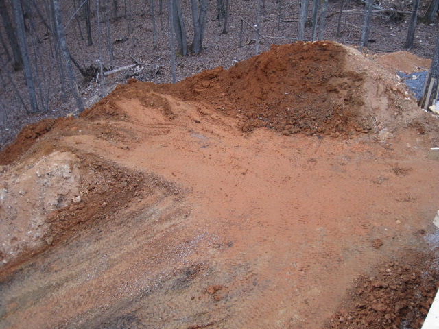

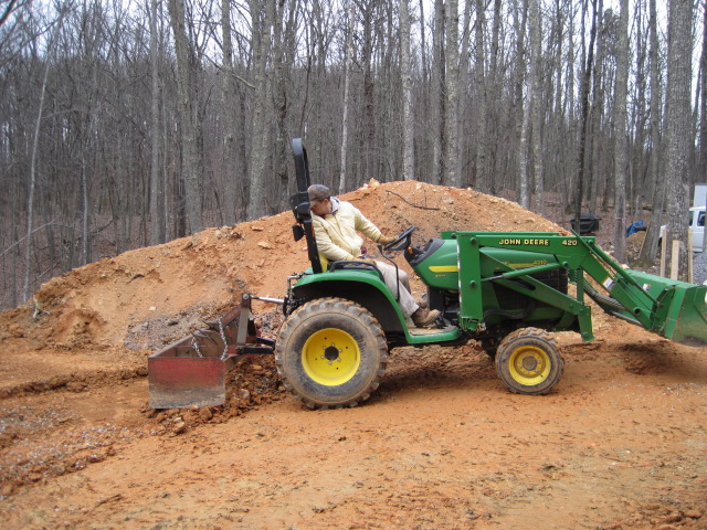

After finishing the grading today, there was one more task I needed to perform. I'm thinking that at a later date I might rent a skid-steer to push these massive dirt piles behind the house down the hill and taper them down. However, once the deck construction begins, there wouldn't be enough room between the deck and the hugh pile of dirt to get any machinery around the deck to access the dirt. The picture shows the tractor is sitting where the deck will be located. These are the "before" pictures.
So I moved a WHOLE BUNCH OF DIRT with my FEL and dumped it down the backside of the dirt pile. I have no idea how many buckets I moved. I was very uncomfortable driving the tractor on top of the new dirt I just put on the back of the dirt pile in order to dump the next loads of dirt over the back. Fortunately, it went without mishap. I now have enough room to get a skid-steer back there after the house is finished.

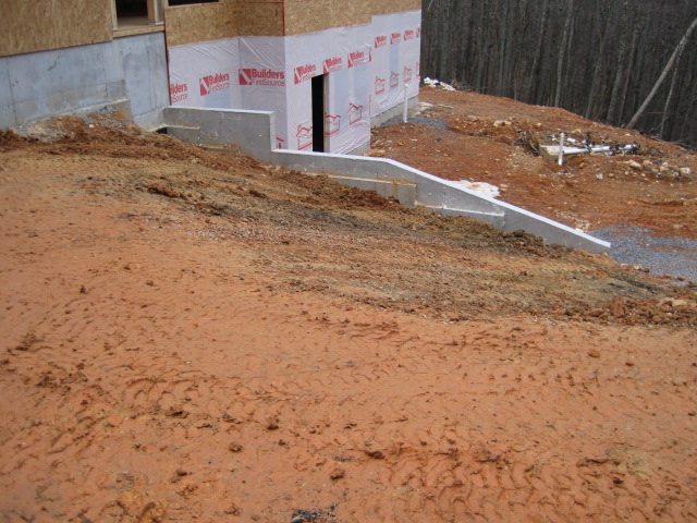

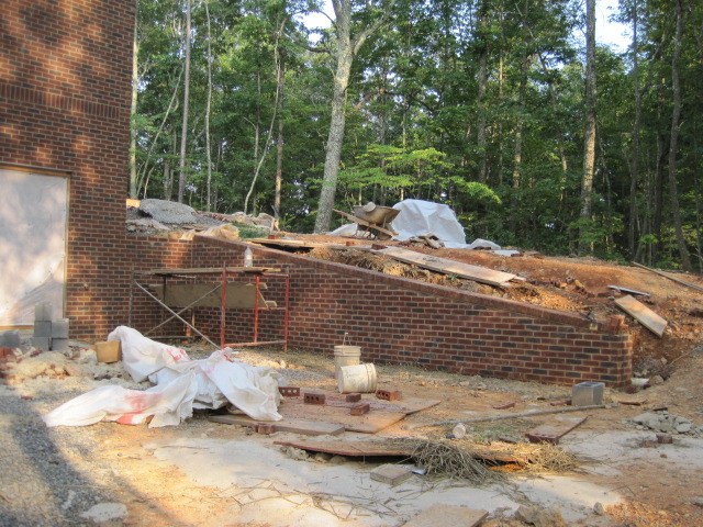

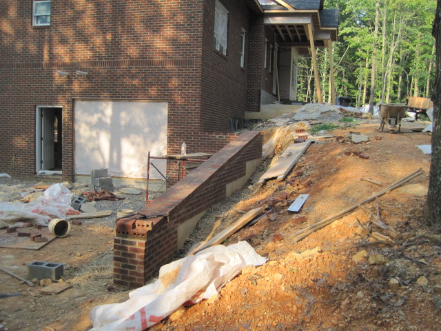

These pictures show the area after I finished. I now have enough room to get a skid-steer around the deck after it is constructed.

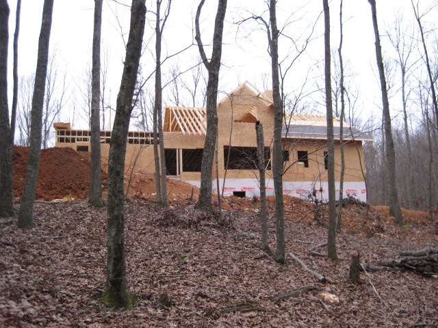

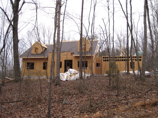

Here are the latest house pictures. The roof work has gone very slowly. However, we have some felt on some of the roof now.
