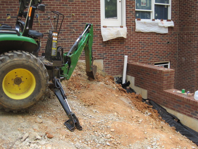

Equipment dollies are nice. With my subframe backhoe, I get close enough to it to connect the hydraulics, then use the bucket, dipper arm and stabilizers to get it into position. If done patiently at a low idle, it works. Biggest challenge I have is getting the weight balance correct to remove/insert the subframes pins easily. Almost always takes a few hammer hits for those.

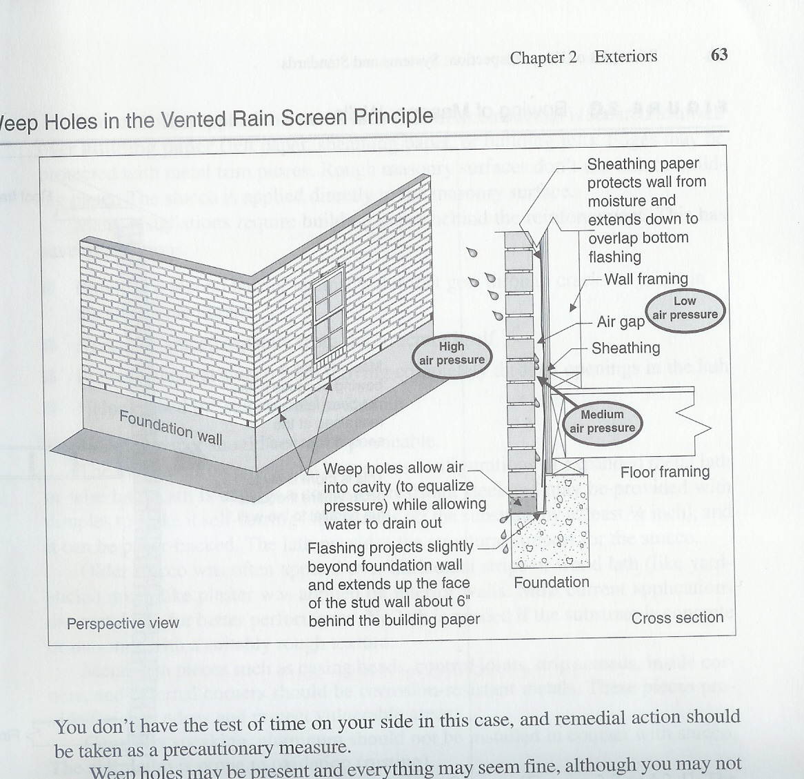

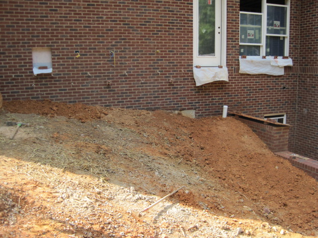

1. Our house is on a slope like the majority of houses in our region (i.e. hilly). The brick ledges on our house are all below the final grade which means the 1st course of brick will be below grade. How should the weep holes be done in this case?
2. Also, could you explain what you mean by "thru wall flashing"?
3. What do you mean by "flashing at deck"?

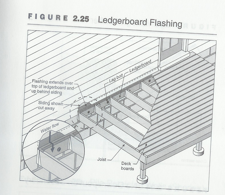

In your case I would expect to see a brick shelf cast in place in your foundation, I believe you said that that is what you have. Determin what the distance is from the top of the brick shelf to the top of the foundation where your wood walls are resting. This will determin how many courses you can have burried. Normally if the first course or so of bricks are going to be burried you move the flashing that goes between the bricks up so that the weeps are not below grade. You need weeps at the top of the wall as well! The thru wall flashing as the picture shows is to allow water that will get through your wall to escape. I like to see the thru wall flashing come thru below the bottom of the wood wall sill plate. This is so that in case there is a back up of water you are more likely to not get any inside the house. The thru wall flashing should extend out past the front face of the brick by about 1/4 top 1/2 inch. A good mason will fill in between the brick and the foundation with mortar to create a solid surface to support the thru wall flashing. another important piece is the mortar net used behind the first couple of courses of brick that are on top of the thru wall flashing. this is used to make sure the mortar that falls between the brick and the wall does not plug up the weep holes and trap the water.
The flashing at the deck is to protect the ledger board and I think with the picture is pretty easy to understand.
I hope that helps and does not confuse further. i'm happy to answer any other questions you might have to the best of my ability.
remember that water and wood are a bad combination pay special attention to roof flashing and wall flashing this is an area that is typically over looked by the different trades as it really is a responsibility of more than on trade and so each assumes the other will do it. just make sure one of them does it.
think like water, and remember that capilary action can cause water to go up hill as well.
