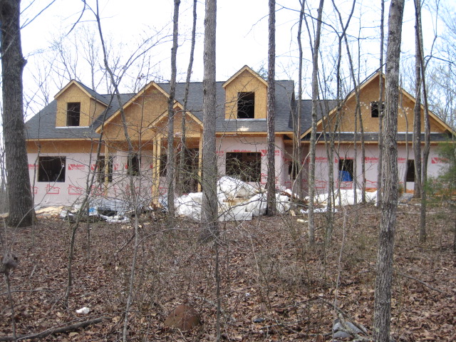

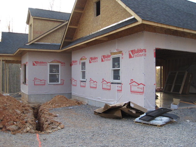

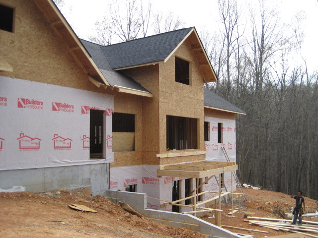

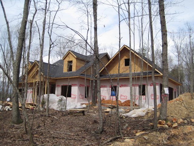

The roof is on!
attachment.php
The roof on the back side of the house still needs some step flashing around the chimney and sidewalls of the back dormer.
A section on the back of the house only has felt on it because the porch and deck on the back side of the garage and house has not yet been built. They will be built after the brick has been laid.

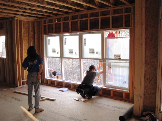

Windows installations began today.
attachment.php
This is the living room window on the back side of the house. It is made of four 3' wide windows that the factory joined together. I took Eddie's suggestion and made sure we have the good window tape. The wife and I verified the windows are square by measuring diagonally across the window from corner to corner to make sure both measurements are equal (within 1/8"). I saw the installers reading the Anderson Window installation guide as they were installing the windows. That made me happy.

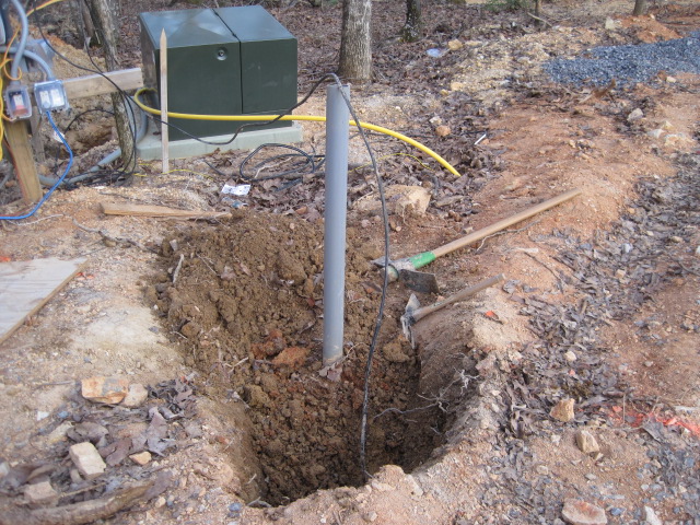

Dilemma
attachment.php
From the street to this point is about 900 ft. The natural gas line and phone line have been run in the same trench. The problem is the phone line (black) shown in the front of the picture comes out of the ground at a different place than the natural gas line (yellow). Ignore the grey conduit; it is empty and will not be used. I don't know why our road contractor brought the phone line out of the ground at a different place than the gas line. The gas company will dig the trench between the yellow gas line in the picture and the house in order to connect the gas to the house. But I don't want the phone line (which is also our internet line) to get cut.
So I started digging along the phone line by hand to find where it meets the gas line. But this is taking forever because I'm afraid of cutting the phone line and I can only remove a handful of dirt at a time.
Does anyone have a suggestion on how to find where the phone line runs between where the gas line comes out of the ground and where the phone exits the ground? This distance is approximately 10 feet.
This is a job for what is called a "line locator".
It is two devices. One puts an RF signal on any of the wires in the phone cable, even an unused one, and the other is a receiver which allows the operator to trace the cable.
Both the phone company and the electric company have them and skilled operators. Try calling the phone company and see if they will trace the underground cable for you.
