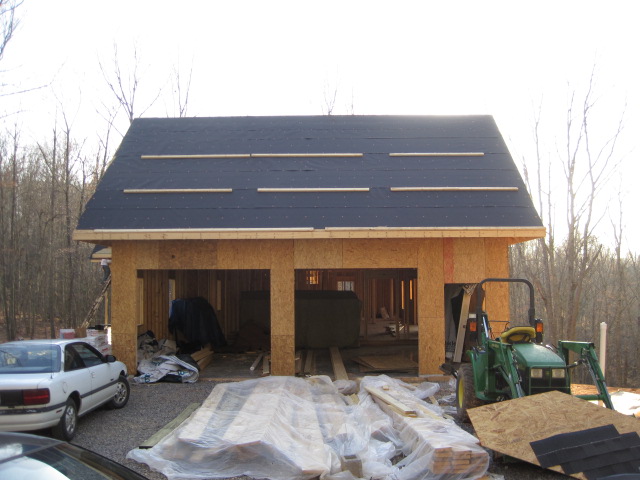

Today the new framing crew started. They fixed the height and width of the garage doors. The previous CM had made the garage door openings 7 ft high even though the house plans said 8 ft high. The new crew had to build a temporary support wall before tearing out the garage door openings because the wall that contains the garage doors is a load bearing wall. You can see the temporary support wall behind the LVL in the picture.

I really like the new framer. Tonight I talked with him about how to fix some of the issues. He seems very easy to deal with. We worked out some solutions together. He observed that our exterior doors were framed 3/4 inches too short and is raising the headers above the doors. We did not know know there was a problem before the framer brought it to our attention. He found that issue and is fixing it and isn't charging extra for it. Keep in mind that he must have gone around measuring things to make sure they fit the house plans.

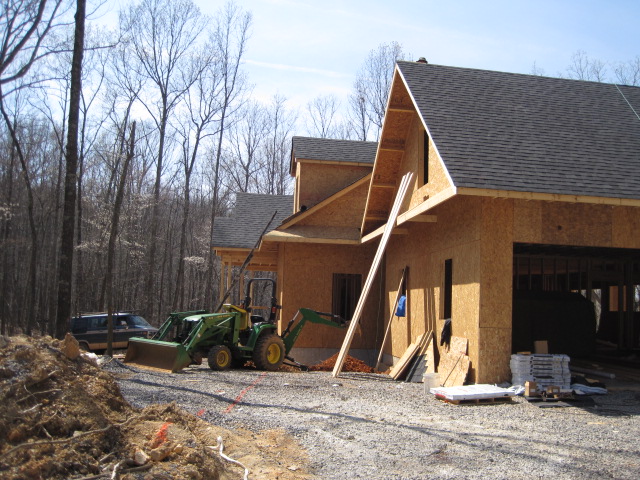

Today is the second day the new framing crew has been on the job. They worked Monday then went to finish another job and were back today (Thursday).
attachment.php

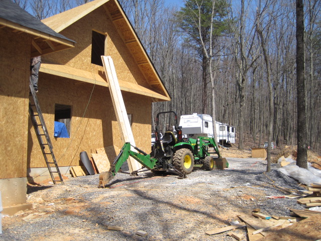

Yes those are shingles! The back side of the house still has felt. Sheathing on half the garage roof and on the portion of the roof that joins the garage to the house has been removed in order to redo the rafters so that the upstairs will accommodate the floor plan.
attachment.php

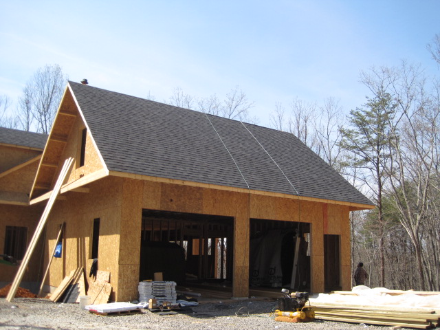

This picture shows the overhead garage door openings that had to be redone in order to match the house plans. The door openings are now 8' 1 1/2" tall to fit 8' high doors. One door opening is 10' 3" wide to fit a 10' wide door. The other opening is 9' 3" wide to fit a 9' wide door.
Tomorrow morning will we meet with the truss guy to try to come up with a plan to fix the trusses that are in the wrong place and interfering with the fireplaces and chimney.
We are also meeting with the electric company in the morning to discuss where to put the cut-off panel that will be near the transformer. We will be installing a 400 A panel outside beside the transformer so that we can so that we can cut off all power to the house. That way I will be able to do work in the 2 electric panels inside the house without having to call the power company. I intend to dig a trench between the outside cut-off panel and the house in preparation for running two 200A lines to the house.

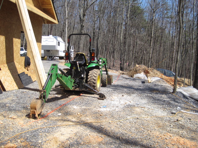

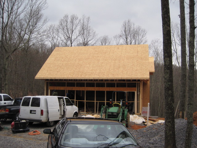

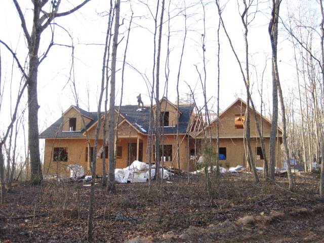

The framing and sheathing for the roof got finished today. Felt is covering the roof except for the eyebrows. Some more shingles got installed today. The roofers had to quit because they ran out of Ice & Water shield. My wife went to Home Depot this evening to get another roll (Home Depot brand) so the roofers can continue their work tomorrow.
attachment.php
Today I started digging the trench for the electric line between the pedestal cut-off/transformer and the house.
attachment.php
Painted a line then started digging beside the line.

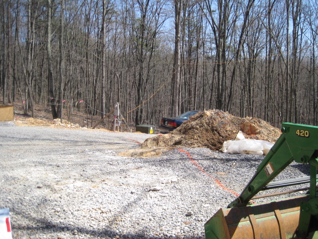

You can see the temp elec. pole and transformer in the background. We will install a pedestal a few feet behind where the temp pole is. The pedestal will hold the power meter and a panel with two 200A breakers. Each 200A line will each run from the pedestal to its own 200A panel in the basement. One panel will feed the basement; the other will feed the rest of the house.

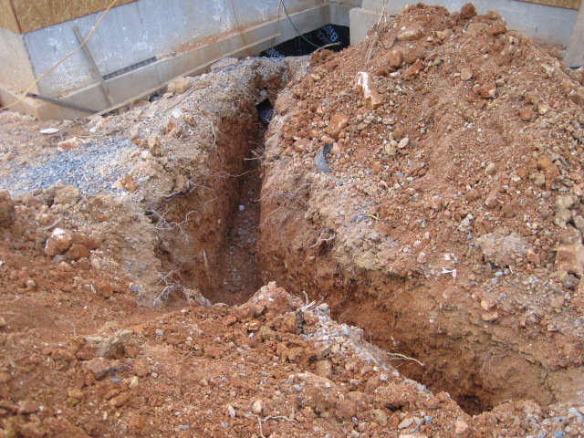

I dug the initial part of the trench so it will be 4 feet deep below the final grade. We need a 2 ft separation between the electric line and anything that crosses it. Unfortunately, the water line from the well and the gas line will both have to cross the electric line in order to attach to the house at their designated spots. So in order to run the water line 2 ft deep for freeze protection, I had to make the electric line 4 ft deep where the two cross near the house. I'll dig the electric line 2 feet deep the rest of the way.
attachment.php

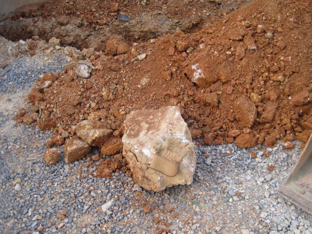

As you've heard me say before, digging here is tough. I hit this rock during the 1st 5 minutes of digging. If you look closely, you can see a glove on the rock for perspective. It took quite a while to get this rock out of the ground.
attachment.php
Here's how far I got on the trench today. It took me about 3 hours to dig this much. I hope I make faster progress tomorrow.
