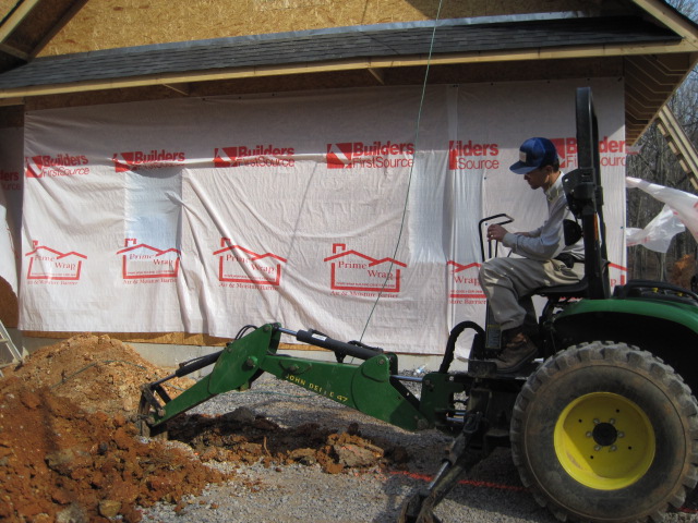

Obed, two thoughts here. Since digging is so hard why not rent a large tractor loader backhoe to dig the trench and also use it to dig out the area next to the retaining wall. You would be able to position the tractor parallel to the retaining wall and extend the hoe out far enough to dig to the bottom and end of the retaining wall. And it would be a lot safer than the way you have your deere perched on that slope. Also with the larger tractor you could use it for other small projects at the house.

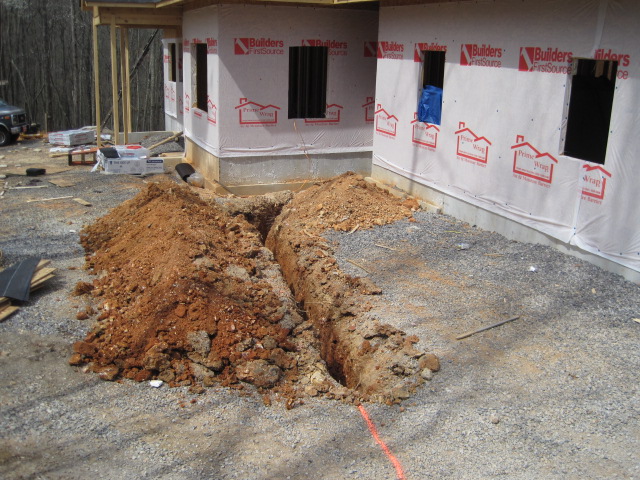

No, No, No! Put the the water down at 4' and run the electric at 2 feet. I know you're in Tennessee, but if the frost ever goes below 2' and you have a water leak then you'll be kicking yourself. And fixing a water leak in a trench that shares electric and gas lines in winter- you DO NOT want to go there.
My master electrician stood here and told me to tell you that as we looked at your pics.
He also said: ask him why he needs 200 amps for just the basement? What are you going to be running that you'd even need 400amps to a residence?! Are you going to be launching space shuttles from your basement?!:laughing:
Here's what I'd do in your situation. Complete the 2' deep section from your poles or pad location where your electric will be feeding to the house. Then dig your 4 foot deep section for the water run. Lay in and pressure test the water run for possible leaks with compressed air. Once you know it does not have any leaks you can cross it with your electric line at 2' deep. Where your gas line crosses your water line set it in at 2', (or deeper, if required). Have your gas supplier do the testing so if there are any problems they are discovered BEFORE you bury the pipe. It needs to be sized properly to your appliances and intended usage. You may be required to use sand for the gas line trench as fill around and over the pipe- talk to your gas company first!
You must flag your gas line with special gas warning tape in the trench.
Take measurements off non-movable objects, like the corner of the house, to record exactly where everything crosses and runs for future reference. Hopefully, when everything is tested for leaks and hooked up you will never have to dig any of it up to correct or modify anything.

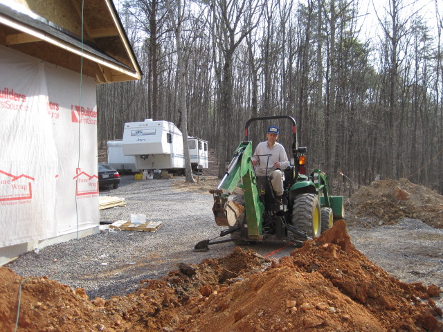

We plan on running gas, water, and electric all in their own trenches although they will need to cross. The wife is going to get some estimates on getting someone to dig the trenches for us. I just don't have enough time to dig them all. Each trench is about 80' to 100' with a bunch of rocks. I got about 1/3 of the electrical trench dug this weekend myself.
attachment.php
Here's how far I got. I'm sure that others could dig faster than I can, especially with a bigger machine.

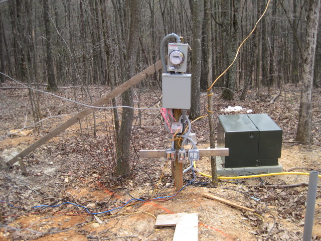

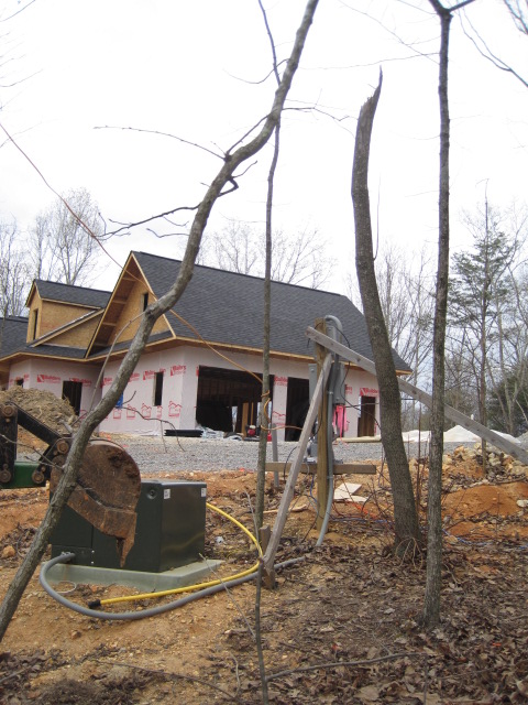

Today, after digging some of the electrical trench at the house, the wife suggested that we get some estimates for someone else to dig the trenches (electrical, gas, water). So I then focused on prepping the area where the electrical pedestal (holds meter and two 200A disconnects) will go.
attachment.php
The pedestal will go just to the left of the temp pole and a few feet behind it.
attachment.php

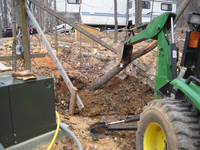

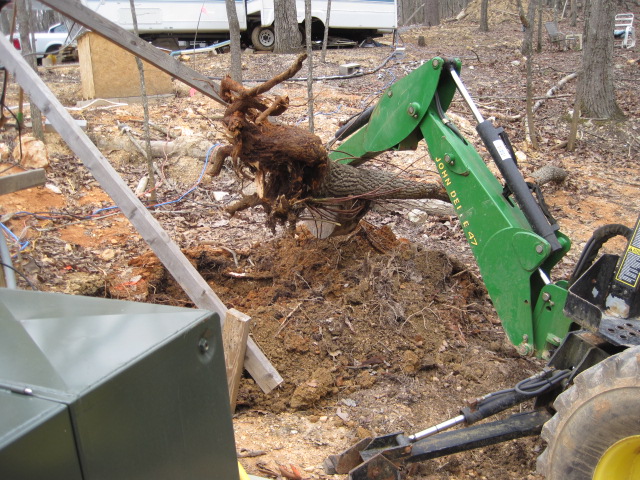

I needed to get rid of the broken off tree.
attachment.php
The backhoe comes in really handy for removing trees.
attachment.php

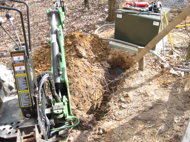

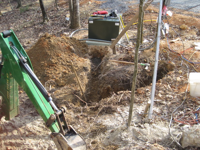

As part of prepping the area for the pedestal, I shortened the braces for the temporary electrical pole to make way for the trenches and conduit.
attachment.php

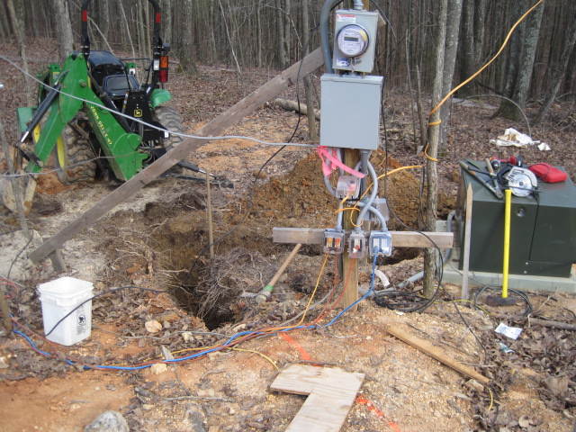

I dug a trench between the transformer and where the electrical pedestal will go in preparation for the electrician's conduit.
attachment.php
I then started the trench that runs from the pedestal to the house. I dug the trench to the temp pole brace. The excavator should be able to dig from the other side of the brace and finish the trench to the house. Where the two trenches meet is where the pedestal will be located.
attachment.php
