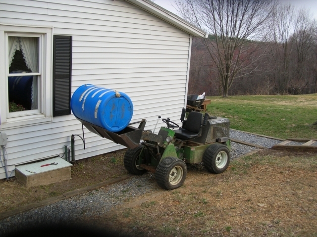

I came across this photo of early springtime when I was emptying some barrels of heating oil I got for free from a friend. Could it be the first time a PT delivered heating oil?
