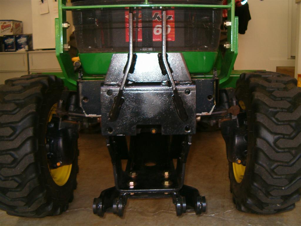

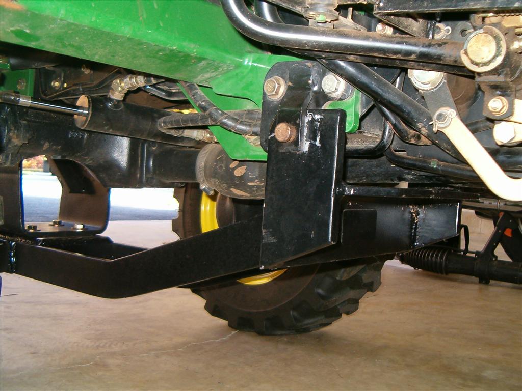

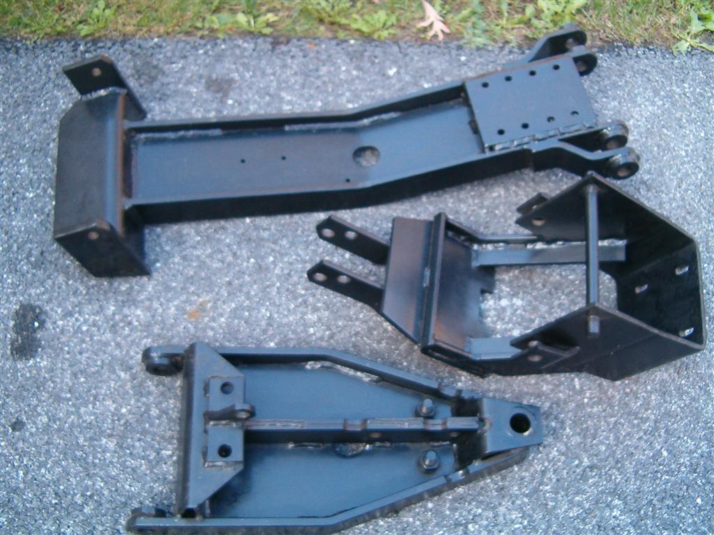

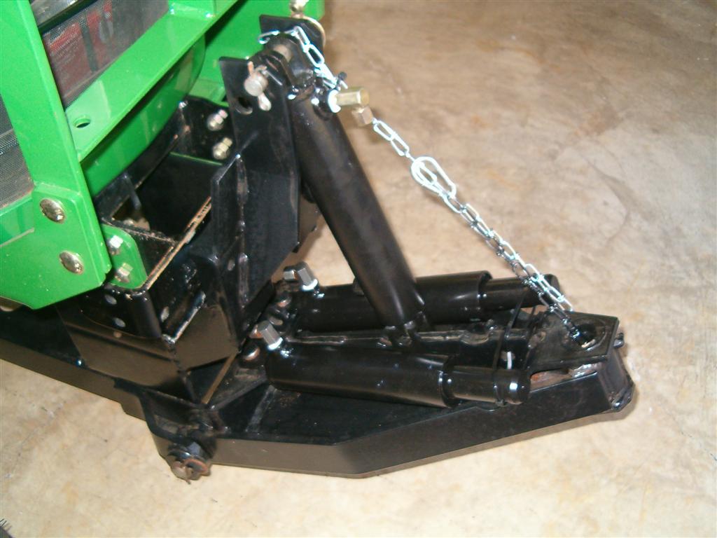

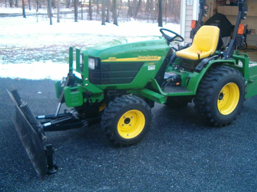

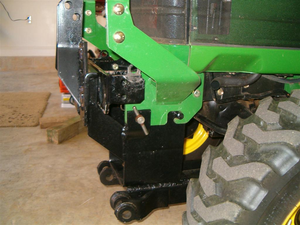

   / Attaching Meyers plow to the front of my tractor.. #7
The second picture is from user "beenthere", he will be along shortly I bet. His type of setup is the best for a homemade approach.
When you stated:
I would like to use my FEL arms to do the heavy lifting - if possible
What exactly did you mean?
I have an older JD #380 plow adapted to my machine, it has the subframe to the mid section like JD755 mentioned. I will post pictures below. I have recently installed a Meyer plow on a JD 2320, but used the factory quick hitch. Thread here: Meyer's plow on a JD 2320 - TractorByNet.com
What other hardware did you get with the plow?
