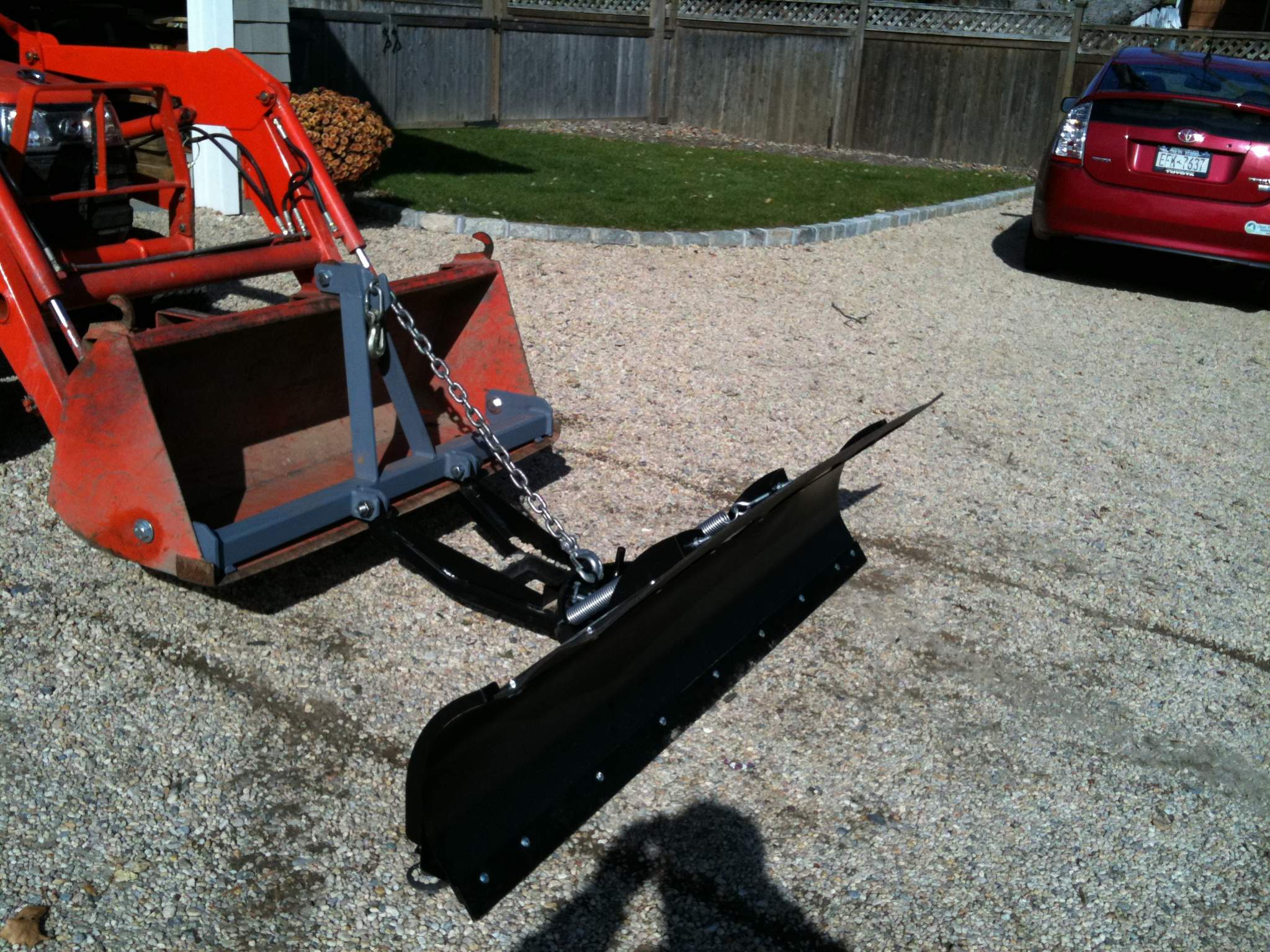

Looks good. My preference would have been attached to the loader for high snow stacking ability. I plow with my Jeep but when the banks get too big I use my little tractor with a home made snowpusher attached to the bucket to push it back.

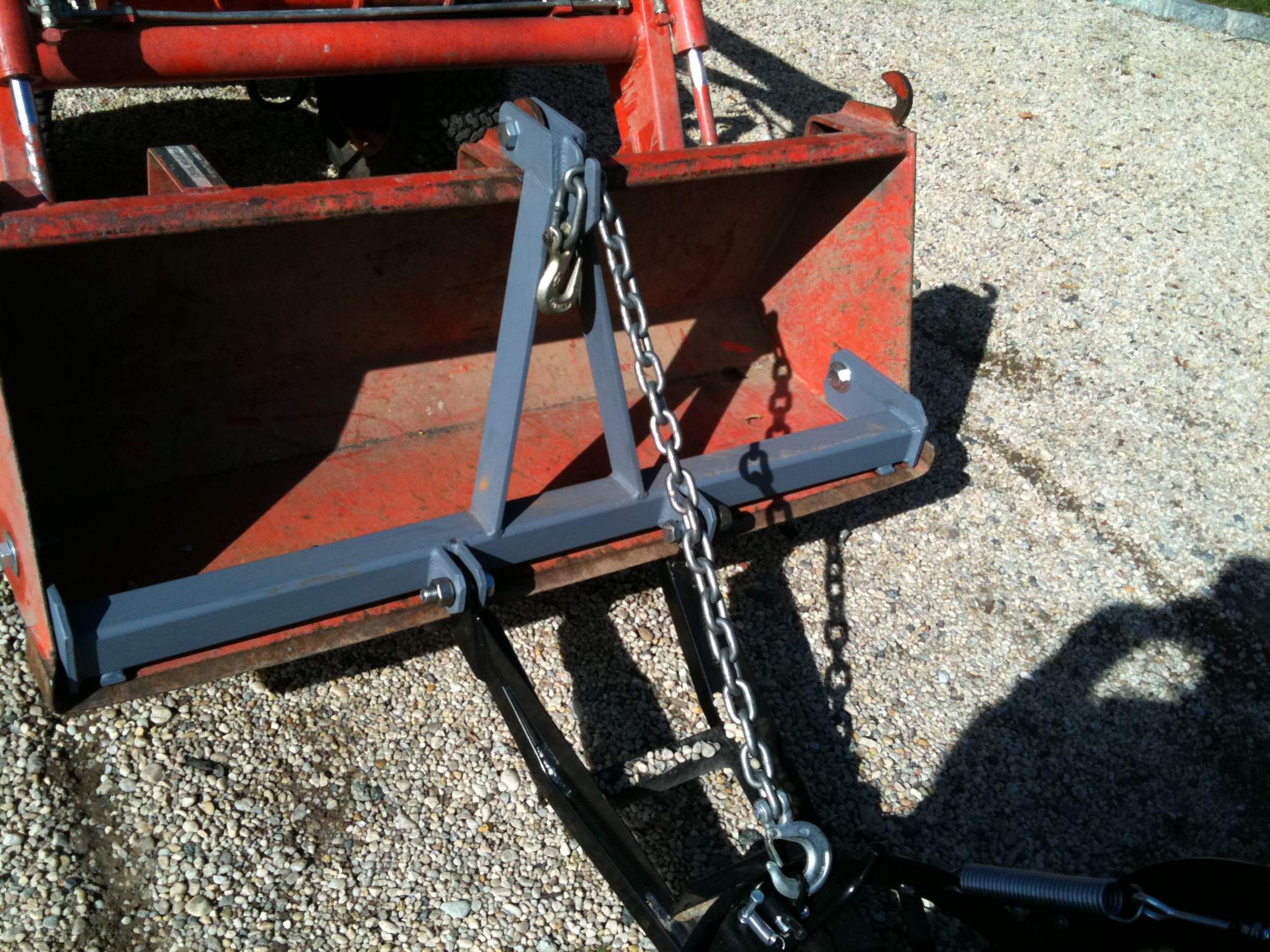

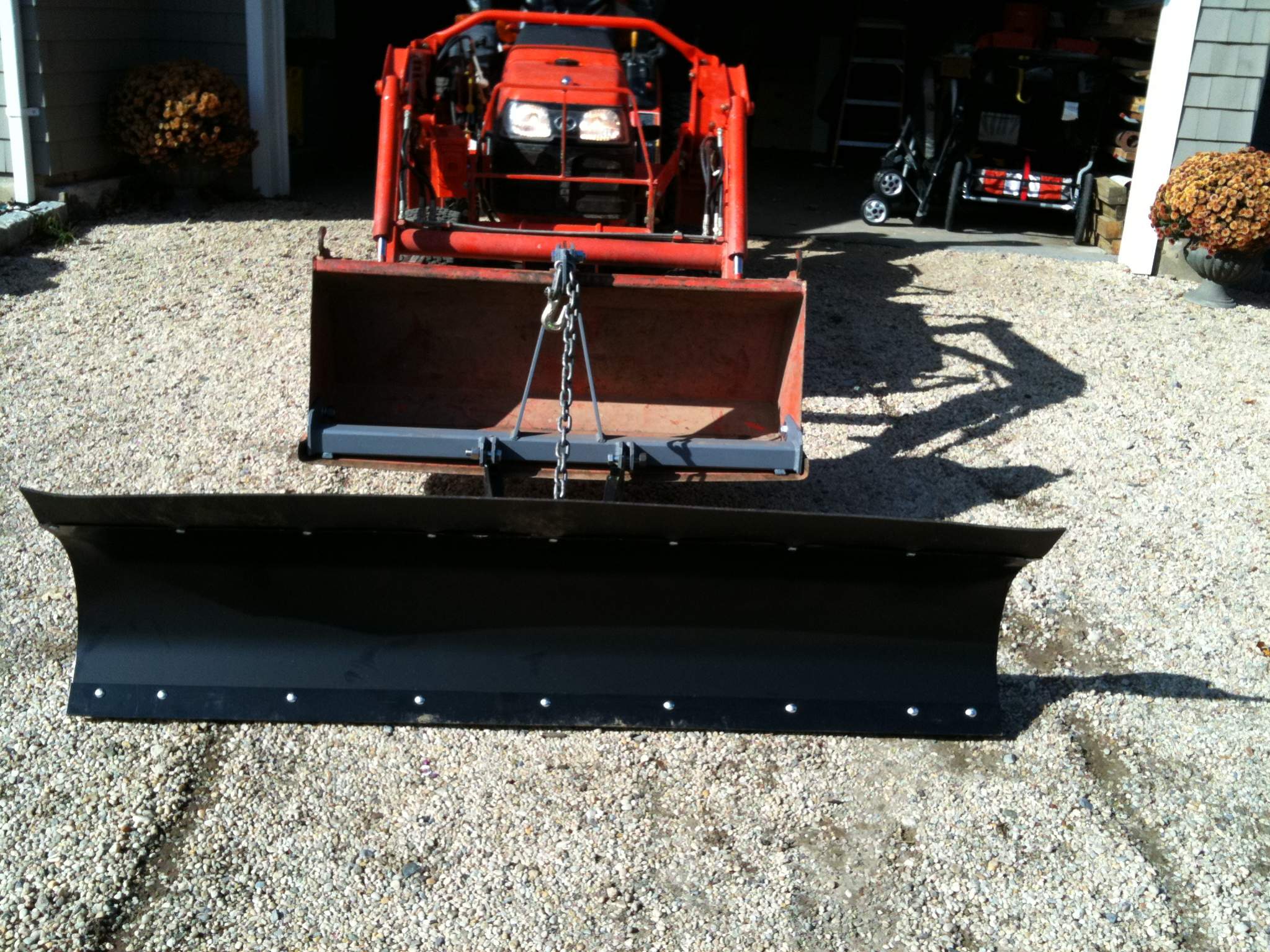

I bought a set of mounts from a Western ( same size as Myers) and had them welded to a plate. I then bolted the plate in the bucket of the loader. I have a hook on the bucket for the chain. The snowplow mount stays in the bucket (but could be removed) and is quick on/off. (two pins and the chain) I used a manual angle so a third hydralic valve wasn't needed. You shoud have the plow frame as deep into the bucket as possible as there is less strain on the loader.
   / Attaching Meyers plow to the front of my tractor.. #40
wetstuff, looks good. I have almost the exact same tractor setup without the loader. I could be wrong but yours looks to be 2 wheel drive? I have been wanting to do this for some time now but was concerned about traction with the 2 wheel drive and turf tires. It doesn't even look like you had chains on or rear ballast. This gives me a little more hope and maybe I will finally get to that project.
