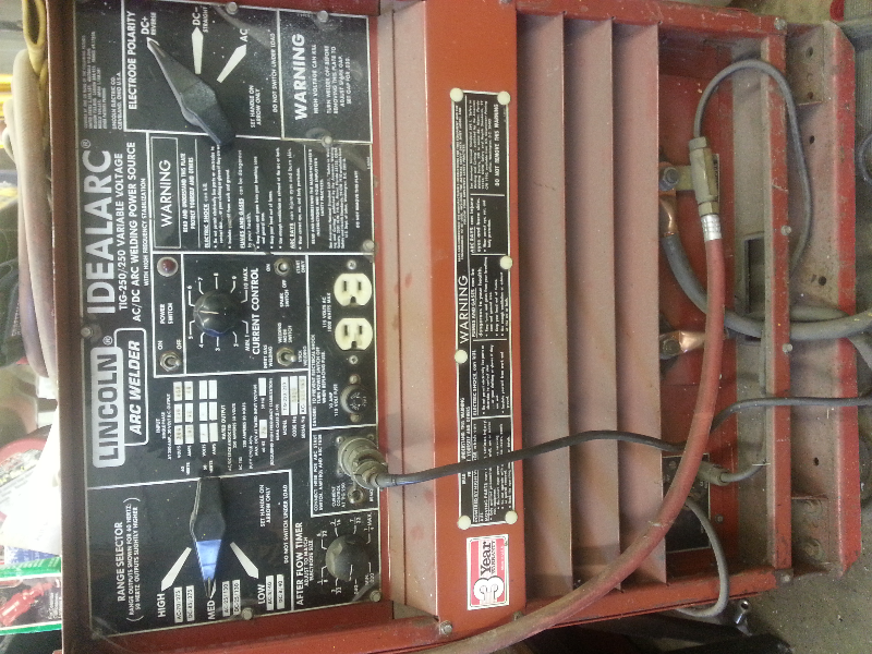

Is this what your welder looks like? This is mine and if it looks like this it is definitely more than 10 years old. I think lincoln may have some info on their site.
Yep that is pretty much the same machine I have. I gave $1200 for the machine and it came with 50ft of leads, tig torch and foot petal and a bottle of gas, a ton of rods and tungsten. I got it from the guy that bought it new, but the machine sat in a corner covered up for several years. It looks new. It has now sat in my shop for a year and except for a little practice with the tig, I havent used it at all. The old tombstone has been pretty reliable and adequant for 99% of all the welding I do. The 175 mig does the other 1% and does a pretty good job up to about 1/4in. I have done thicker metal with it, but I usually reserve the thick stuff for the tombstone. The 50ft leads on the idealarc is the primary reason why I havent used it much. I dont need that much leads inside my shop, but I hate the thoughts of cutting the lead, never know when you have to weld something that wont fit inside the shop. I could take the leads off the tombstone and put on it, thought about it several times, and considered just buying some new 25ft'ers and setting the long leads back incase I do need them. And i could just buy some connectors and cut the leads I have. Just havent gotten around to it. Usually any welding I do is on the spur of the moment when something breaks. Aint got time to run to the welding shop then, so just keep on doing what I have been doing with whats already hooked up.
Project I am about to start will require a ton of welding which is the reason I am considering doing a little swapping around with welders before I start. Would like to have a all in one machine, stick/tig/mig. That way I dont have leads from different machines crisscrossing across the shop floor in a tangled mess. I figured if I could find a wire feeder to work with the idealarc, problem solved. Sounds like my ideal wont work so, I'll use what I have and be happy to have it.
   / Attaching wire feed to a stick welder #22
Voltage sensing wire feeders will work on CC machines but you need to be over a certain amount of volts. Usually around 22-24 is the minimum they will work properly. That's why it was mentioned you need to stay in spray transfer. To get the higher volts. you'll need a higher wire feed speed(amps). If you are doing lots of wire welding, you'll need to consider the duty cycle of the machine. Being it's a TIG machine I don't know if I'd want to run a lot of high amp wire with it. I'd e-mail Lincoln and see what they say. Does the project you're doing require high strength welds, IE/ 7018? Hobart Fabshield 21B is a general purpose flux-core wire. The flux-core wires for higher strength, 7018 like, welds are pricey! If you want more production and don't need 7018 strength, get some 5/32" or 3/16" 7024 and go to town. 7024 is/was the go to rod for production stick welding. There is also 7028 that is a higher deposition 7018 but both these rods(7024, 7028) are for flat or horizontal welding only. The other option is renting a CV machine for your big project.
As far as machines, you have a good AC/DC TIG welder with high frequency. The so called all-in-one welders are very misleading. They are only DC and can't TIG weld aluminum. I think the machine you have would be a much better TIG welder and probably stick as well. I would guess it uses the same or very similar components as the standard Idealarc 250 which is an outstanding machine.

The project is a firewood processor. Most of the high strength welds will be the cyl mounts and the wedge, which I planned to stick weld anyways. Everything else will just be tubeing and angle iron, so I can get by with what I have. I have never even seen spray transfer, done a little reading on the subject but dont have the machine to try it. I appreciate the replys from everyone

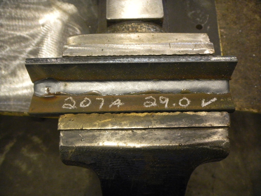

I played around with spray just to see what it was all about. I rented a bottle of C-10. 10% CO2 / 90% argon. I understand that if you use 98% argon and 2% oxygen you can get into spray faster. Some people like C-5 over C-10.
In my opinion if you're not in a really high production mode it is not worth the trouble! The metal has to spotless! I'll take dual shield over spray any day of the week.
Here are the results I got with spray.
