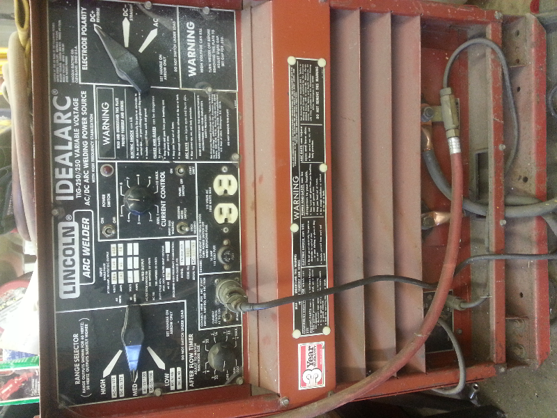

Is this what your welder looks like? This is mine and if it looks like this it is definitely more than 10 years old. I think lincoln may have some info on their site.

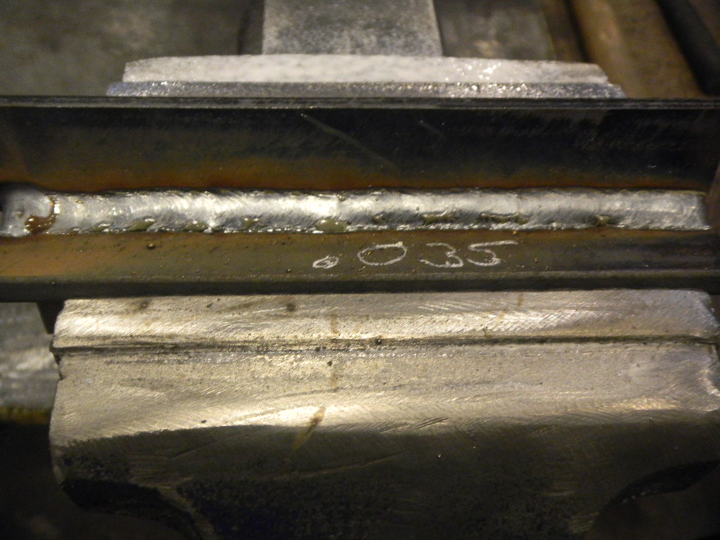

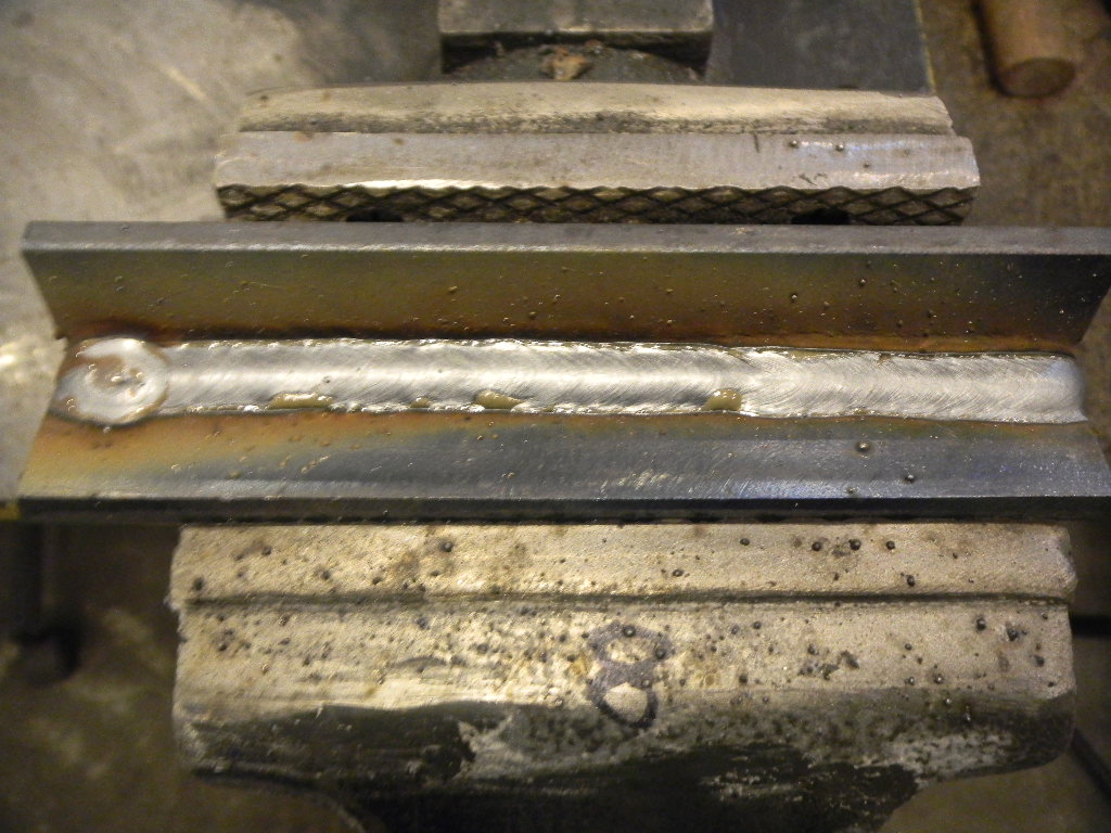

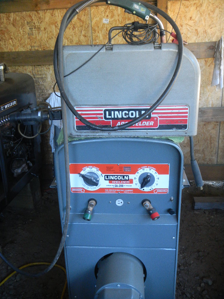

I've always heard you can't run Mig on a CC machine. I wanted to see what happens, so I gave it a try. This is .035" Lincoln L-56 wire, with C-25 gas. Ran it on the same 1966 SA-200 Red Face CC only engine drive, with my LN-25.
   / Attaching wire feed to a stick welder #17
You heard right didn't you? ;)
   / Attaching wire feed to a stick welder #18
And you call yourself a welder....
:laughing:
