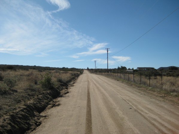

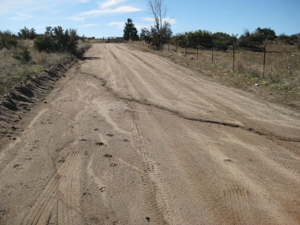

Just an update regarding the last time that I graded my road and wash outs. We had about 5" of rain and a couple inches of snow in a 7 day period. I had 2 places that water ran across the road. the picture shows the worst washout, about 2 1/2" deep. I guess that the ditch needs to be a bit deeper. The next time that I grade it, I might go ahead and throw the dirt back onto the road and see how that goes. I just hate to cover the long established road by putting fill on top of it.

I build up the road base with the ditch materials prior to adding basecourse and gravel where possible. Can't tell from the picture but if you have hauled in good gravel I can understand your concerns.
My point was that you are better off with the road bed elevated and the ditches clean and deep.
