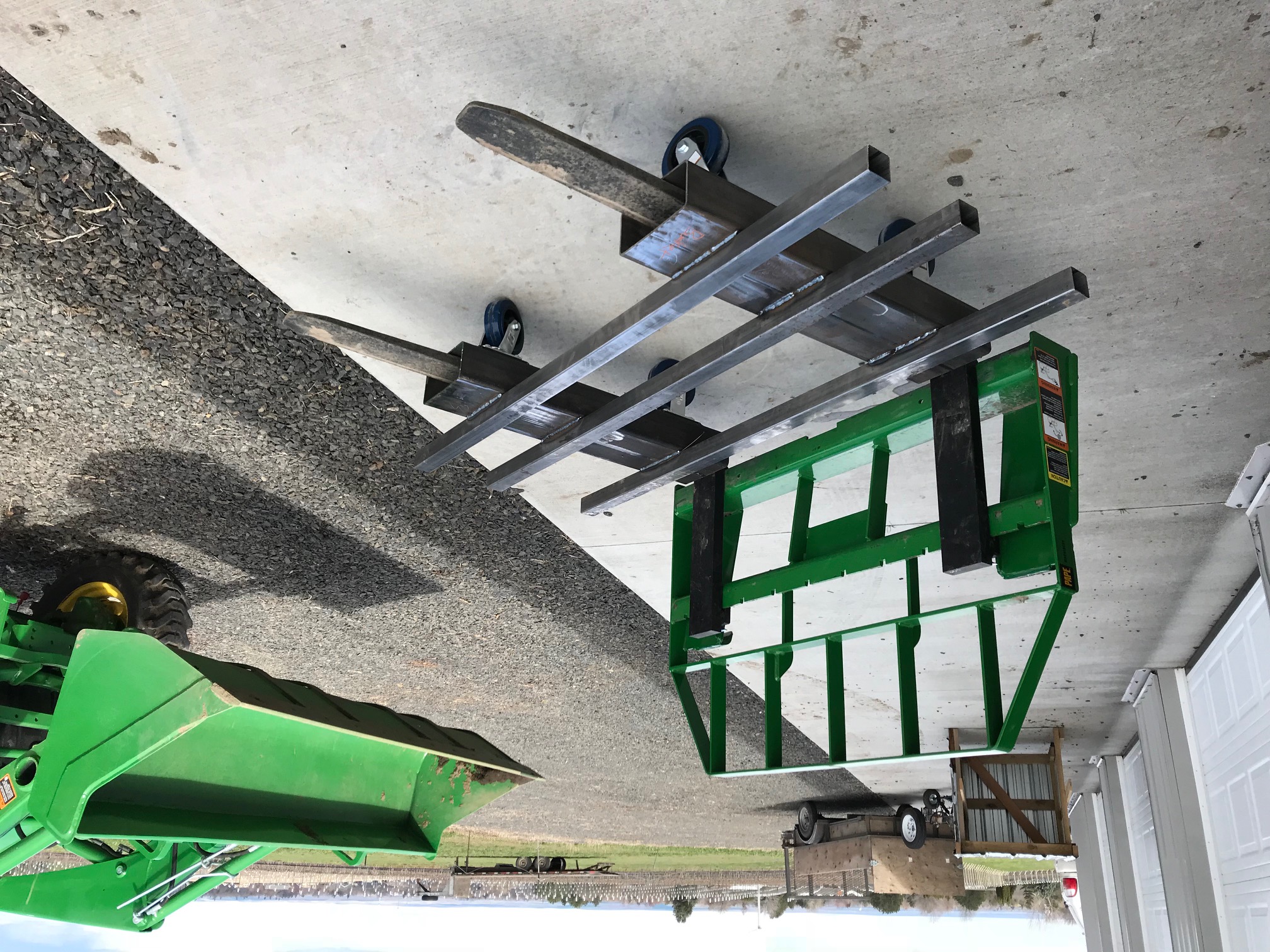

I agree with the previous comments about storing implements under cover. I have trouble moving them around my shop and have already broken a Harbor Freight dolly. I built this dolly to store my pallet forks and loader bucket [attached] IMG_4119.jpgIMG_4121.jpg (photos open upright) and modeled it after this product [Fork and Bucket dolly Storage Solutions ]. I made it heavier to accommodate larger implements.

I agree with the previous comments about storing implements under cover. I have trouble moving them around my shop and have already broken a Harbor Freight dolly. I built this dolly to store my pallet forks and loader bucket [attached]View attachment 546414View attachment 546415 (photos open upright) and modeled it after this product [Fork and Bucket dolly Storage Solutions ]. I made it heavier to accommodate larger implements.

Nice DIY dolly! I need to build a couple for a few things now that I have forks!

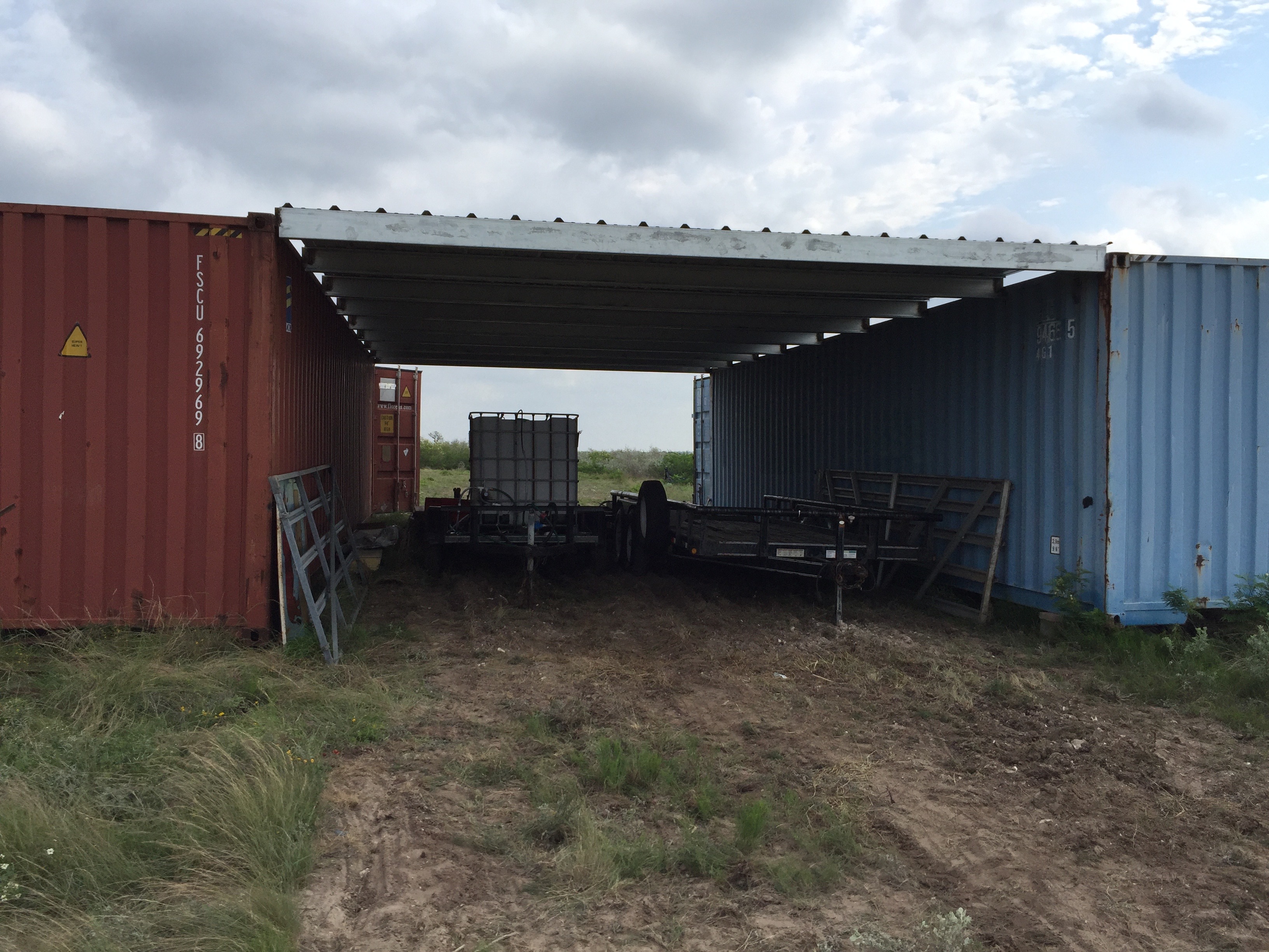

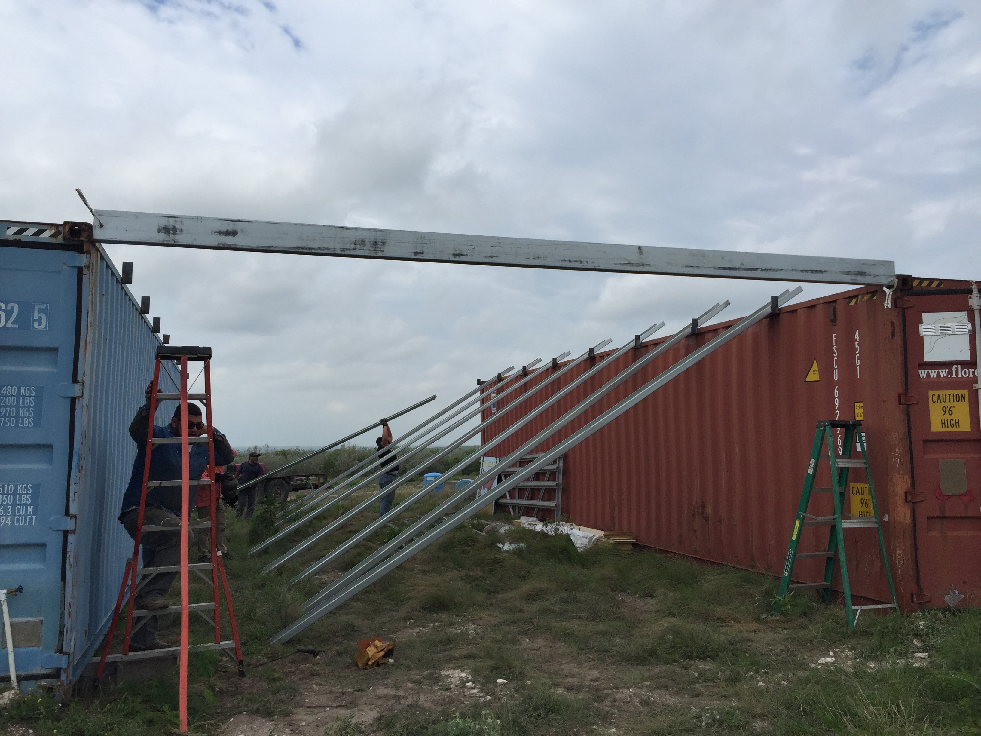

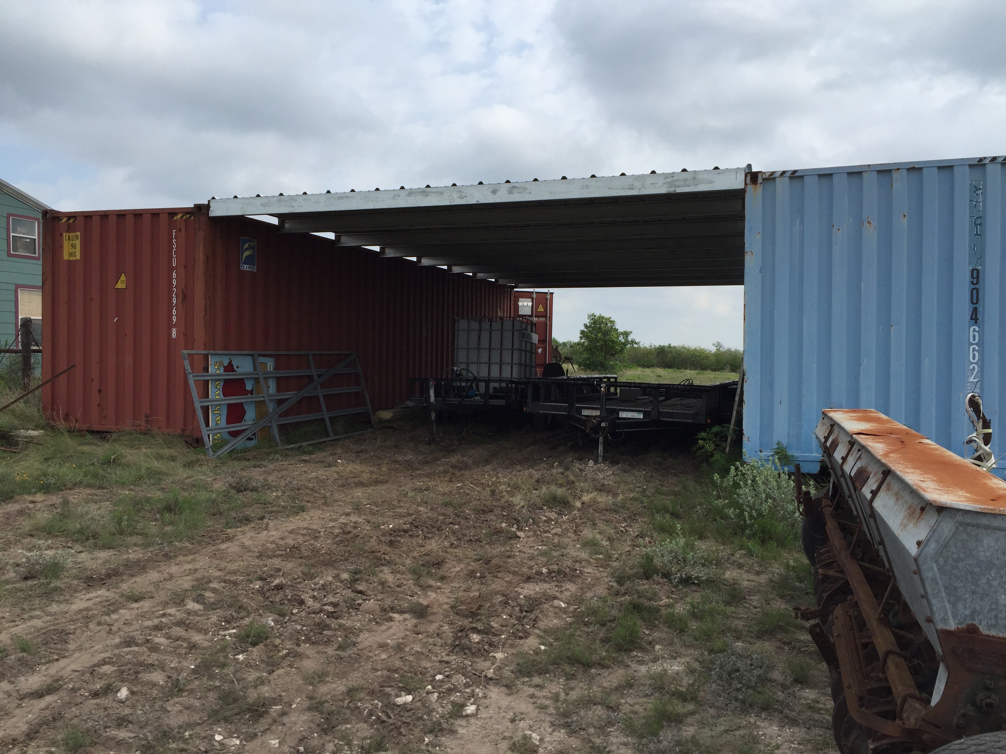

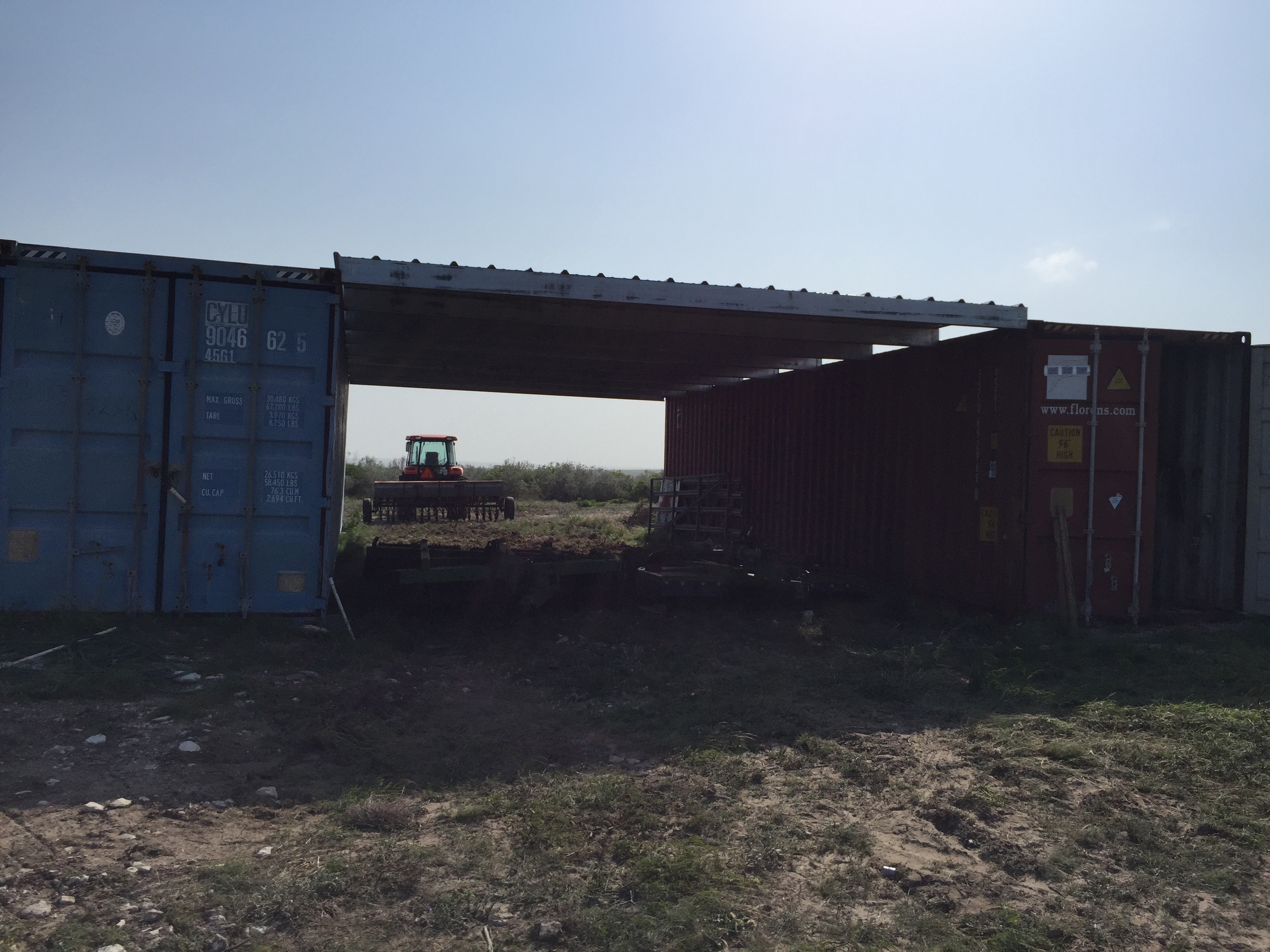

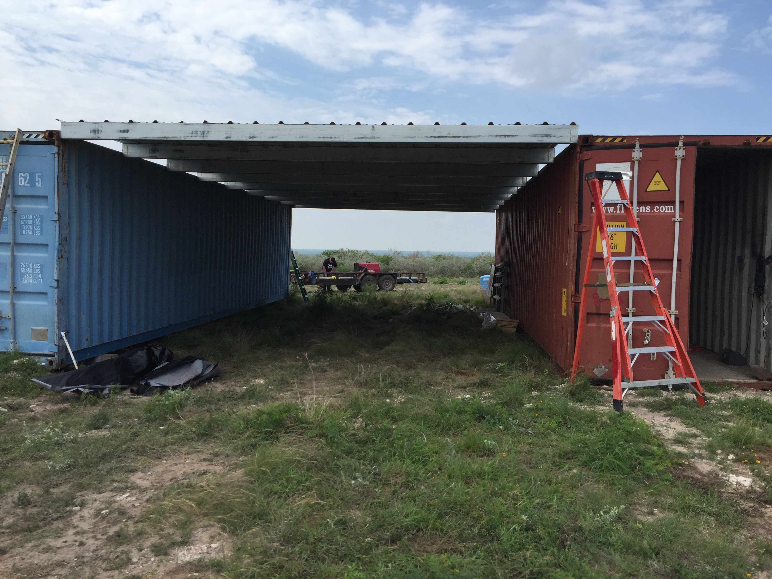

EF1924AE-BC32-4F45-A208-FB8EA2D22B33.jpeg7AF84B53-720E-4C5F-A74D-542370A5D23D.jpeg77375AC2-2501-4713-9FC5-FA92C6C51334.jpeg73E3A917-1157-4E83-98C6-38BCBDEC35F1.jpegECE405A1-B150-42DE-8D61-F0E46FF6BB83.jpegEF1924AE-BC32-4F45-A208-FB8EA2D22B33.jpeg7AF84B53-720E-4C5F-A74D-542370A5D23D.jpeg77375AC2-2501-4713-9FC5-FA92C6C51334.jpeg73E3A917-1157-4E83-98C6-38BCBDEC35F1.jpegECE405A1-B150-42DE-8D61-F0E46FF6BB83.jpegEF1924AE-BC32-4F45-A208-FB8EA2D22B33.jpeg7AF84B53-720E-4C5F-A74D-542370A5D23D.jpeg77375AC2-2501-4713-9FC5-FA92C6C51334.jpeg73E3A917-1157-4E83-98C6-38BCBDEC35F1.jpegECE405A1-B150-42DE-8D61-F0E46FF6BB83.jpeg
My implement shed..40 x 20
Dirt floor ( for now )
