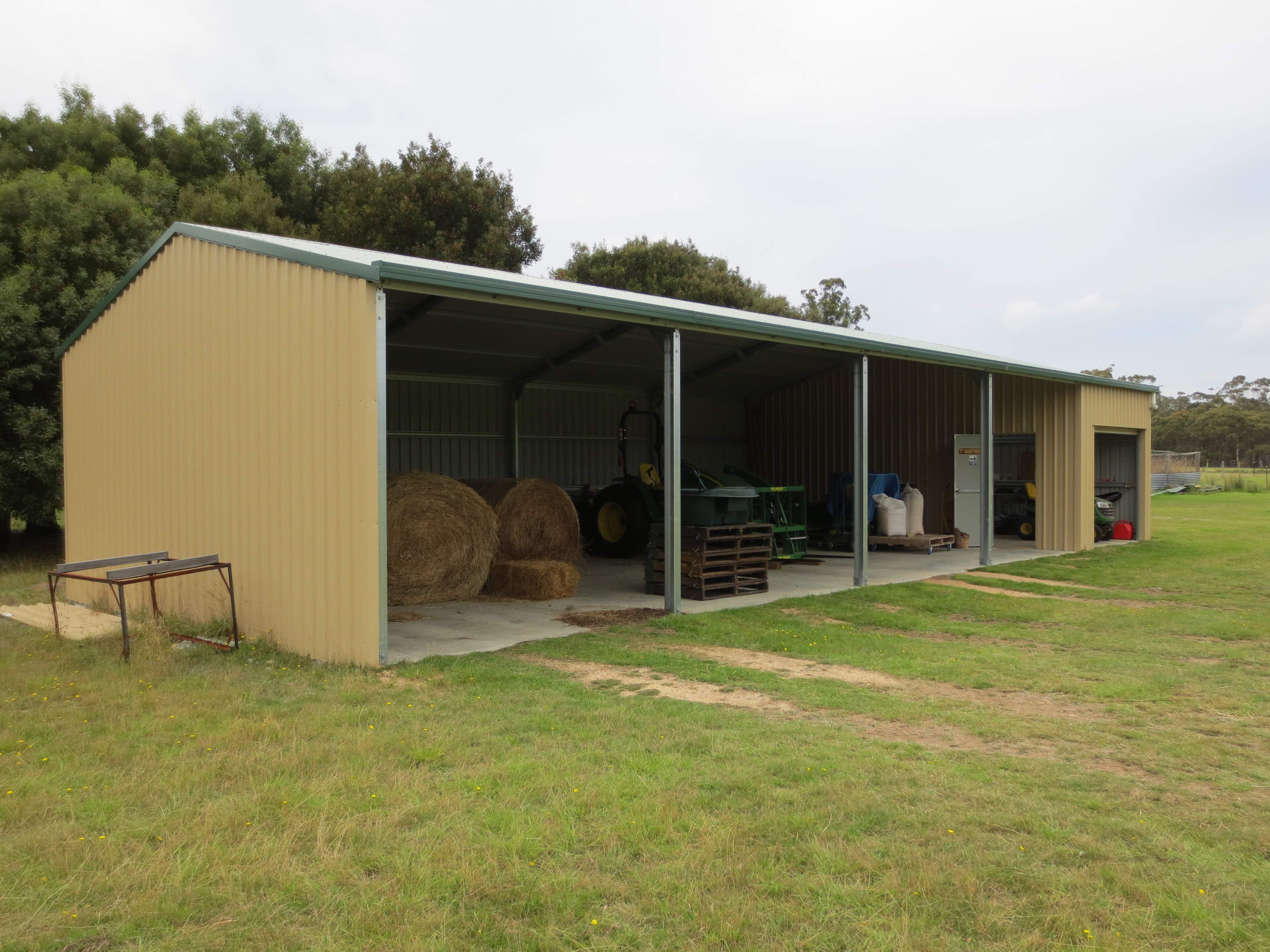

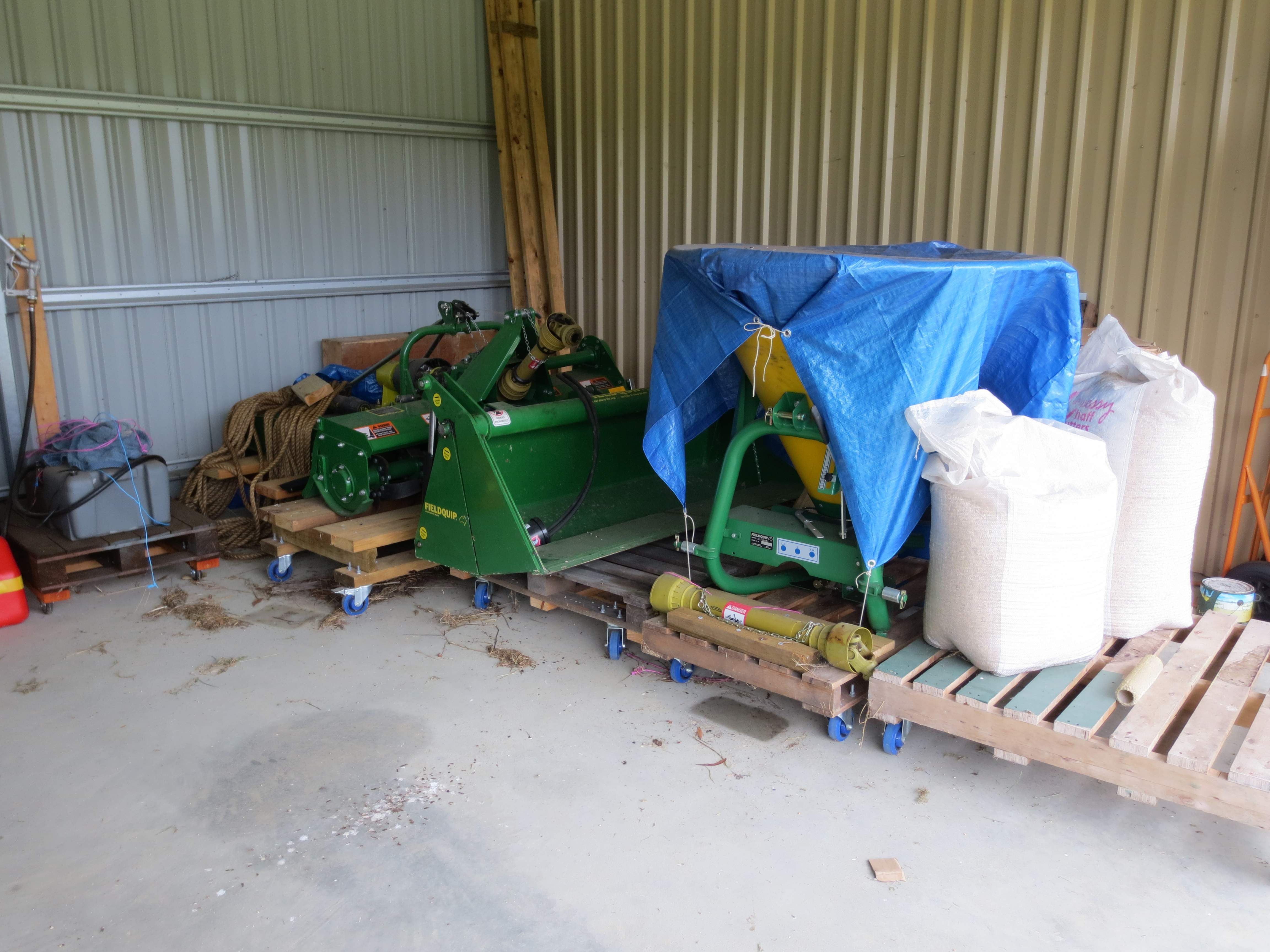

Suit yourself... but a concrete floor (along with your implements on dollies) will maximise the number of implements that you can store in a single bay. In the first picture (below) there's a slasher, then a tiller, the 4-in1 bucket and a fertiliser spreader... all 'scrunched' together, yet easily accessible.
Also, putting in a concrete floor before building the shed is less expensive (and less of a hassle) than doing it after the fact.

Where did you get your wheels for the pallets, what is their capacity, size, etc?

Ta Mate! I purchased the wheels from "Bunnings", which is an Aussie large homeware/hardware store. I believe that you would call them a 'big box store'. I just found the relevant aisle and bin... plastic wheels and the 'load capacity' was written on the bin. I went for the maximum. 3 of the four wheels are free-wheeling and the 4th is lockable (brake) although I've rarely had to employ the brake. All of the wheels are 360 degree (ball bearing) swivels.
I just wandered out to the shed and the only markings are on the blue wheel - 100X36... what ever that means. :confused3:

Thanks for the info! "100x36" perhaps means the diameter (100 mm) and wheel width (36mm)?

I have to agree - a concrete floor will be GREATLY appreciated in the future. You will want to insure a slight slope away from the building your shed is built against though - think building a front sitting porch on your house. Nice way to handle the attachments BTW.
Also - as with many of these things, you might later decide that enclosing part of the shed would be useful and you would be ready to do that. I'm in the process of enclosing 24' of mine that I find I don't need for attachments (some can be easily left outside without have (rear blade, ROBB, landscape rake, snow bucket, etc) and I could really use some extra space for my welding shop.

Was not planning on concrete. Just a gravel floor. I don't really need dollies the skid steer can move anything around either attached or with pallet forks.
I already have around 8300 SQ feet of shop space with 10' or higher ceilings. This shed will strictly be for implements, none of which are over 5' tall - most less than 4'. I certainly don't want to make a mistake and build it too short but I am not seeing why it should be taller than 7-8 foot? Also I am using steel not lumber. The sheets are ordered cut to length.
I think along your lines. A row of attachments that you can grab and go in a long narrow shed. Skid steer attachments do not need to be perfectly flat when you pick them up so concrete is nice but not required.
