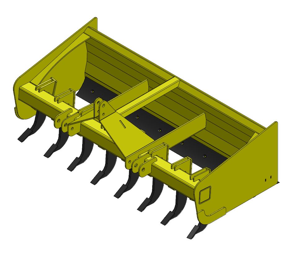

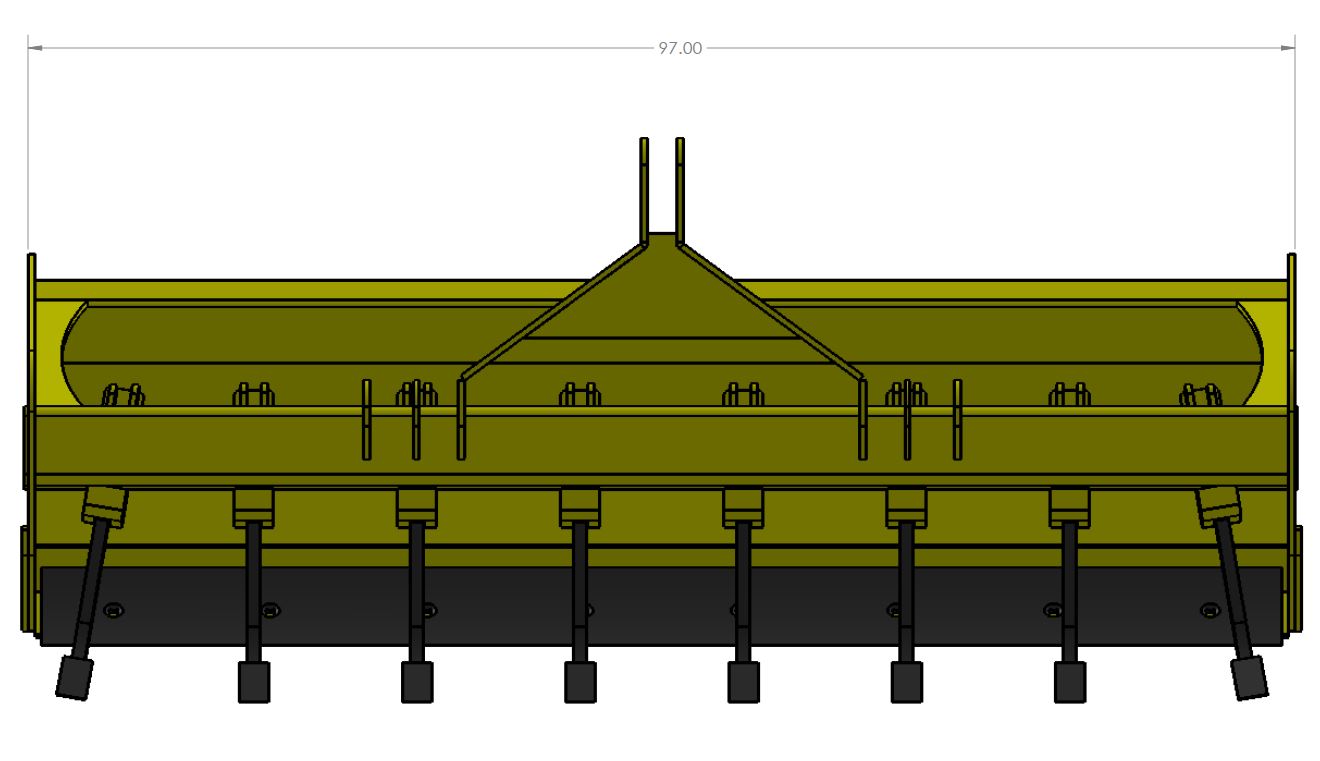

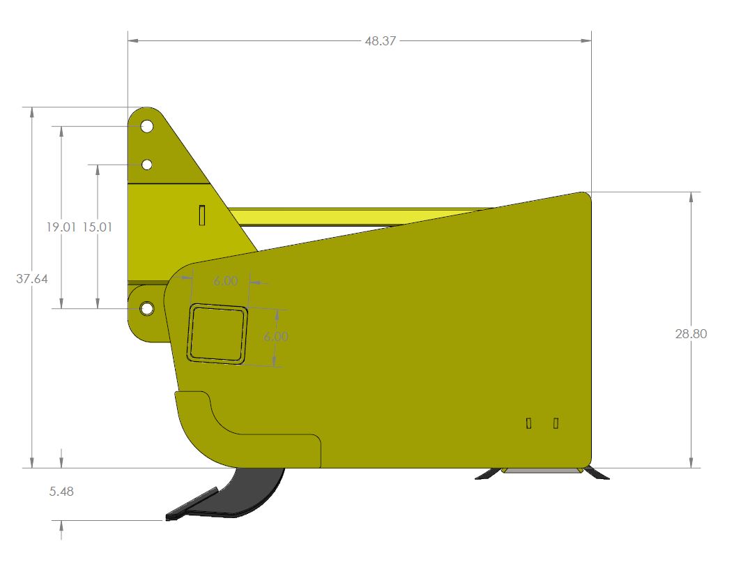

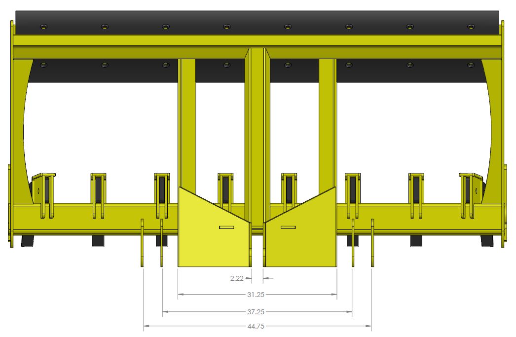

Here are the latest pics. The prototype is being cut now. 2,122 pounds, 8 scarifiers, Cat 2&3 Quick Hitch compatible.
Harry Gant's TL90 New Holland that Ted is planning to use for the video has been turned up to 108 PTO HP so we'll see what happens!!
We should be able to do a video soon.

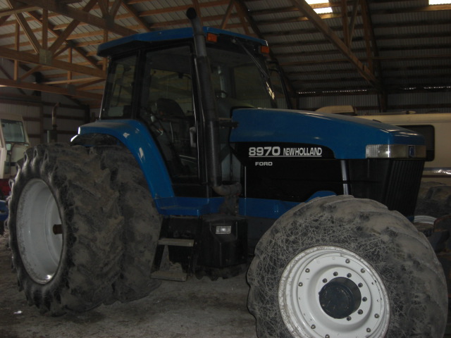

Can you get an estimate of what the tractor weighs. It won't matter if it has 2000hp if there isn't any weight to get the power to the ground. ;)
   / ATTN: Heavy BOX BLADE Experts.....Give us your opinions please.
#107
The hp/weight of the TL90 4x4 will be on the low end for this blade and the 240hp 4x4 tractor will be on the high end. These should provide us with a great overall evaluation.
#108
The TL90 weighs around 13,500 pounds and the 8970 weighs around 35,000 pounds the way they are set-up.
Here's a pic of the big one:
