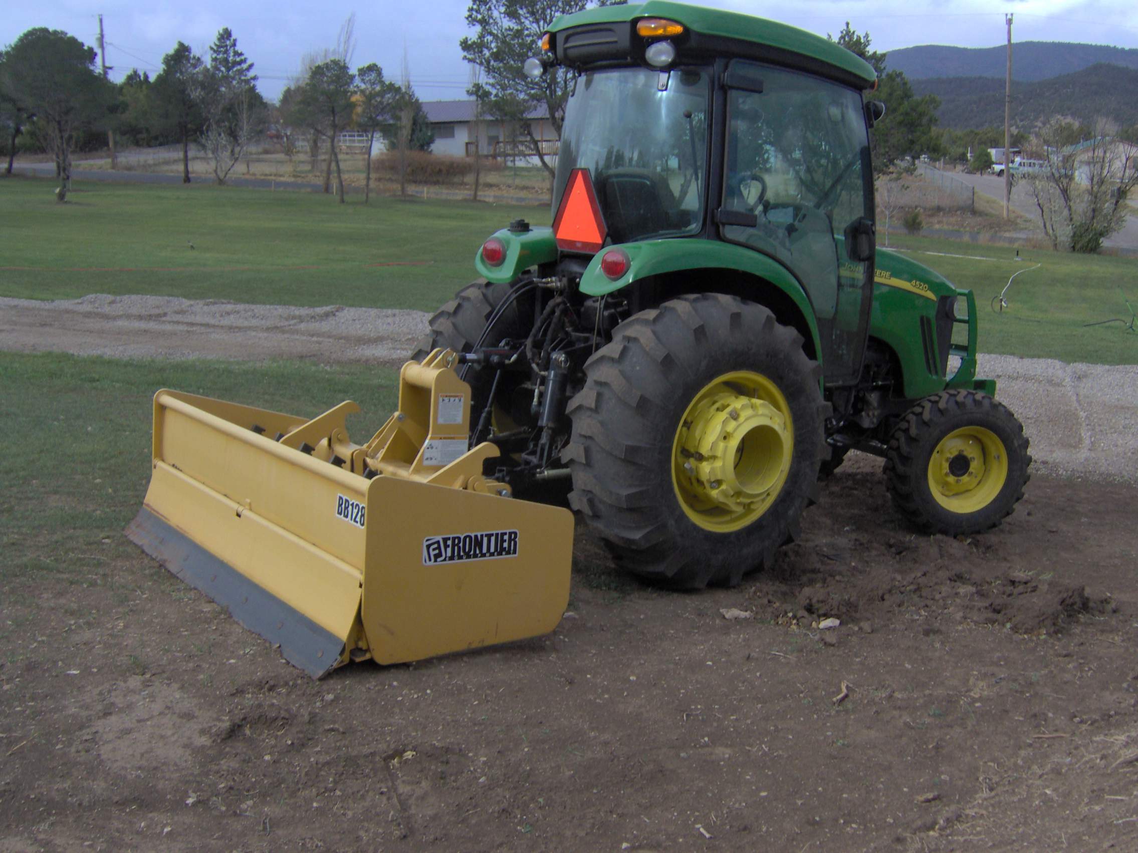

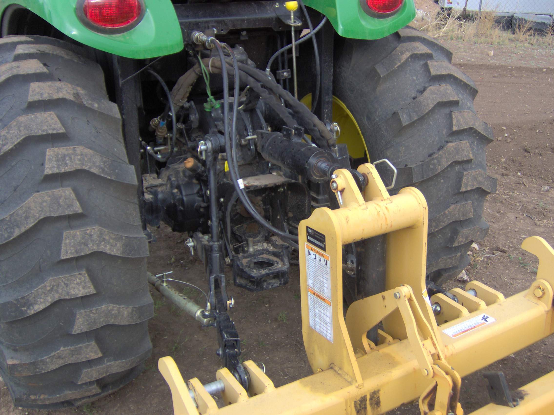

The Frontier BB1284 I have made by Woods Gannon has 5/8" plate for the mast and is mounted to 5" box tubing, this is a 1260 lb boxblade with hydraulic scarifiers. If Ted is going to build a 2000 lb boxblade it needs more mast than shown so far. I commend him for reaching out though and think pursuing this is a good idea.
