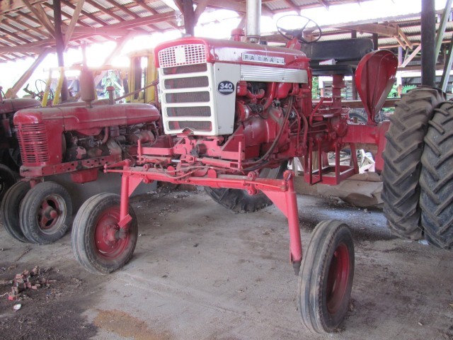

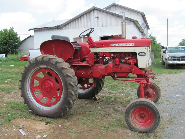

How about a high crop tricycle tractor with your box blade belly mounted?
Sure would be easy to see the blade!
Farmall 340 High Crop.jpg Farmall 340-High Crop.jpg frontends_highcrop.jpg JD-LP-HC-430.jpg
Pictures from Google Image Search. Not mine.
