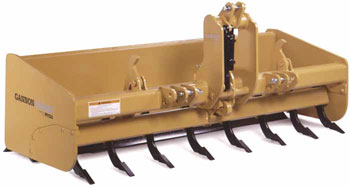

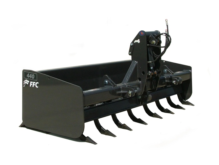

The one thing that I noticed is all of the "preferred by members" box blades including me, are High Back models. That is something for Ted to consider in his design.
Will Ted show us the design before it is finalized so we can critique it?
View attachment 332391View attachment 332392 View attachment 332393
Those are actually the top 3 that he looked at I think.
He told me this morning that he got a lot done on it yesterday, around 80%.
He may show it before it's finalized.
