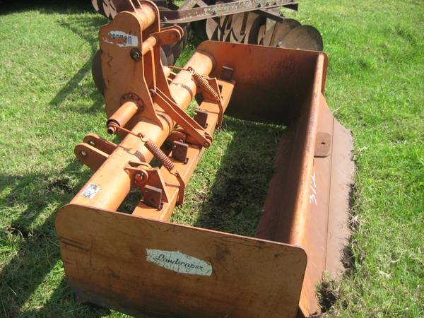

two 5 ft box blades with auto rippers
I had not heard of mechanically retractable rippers until running across this ad recently. Anyone ever used a box blade of this type.
Here's a picture for posterity:

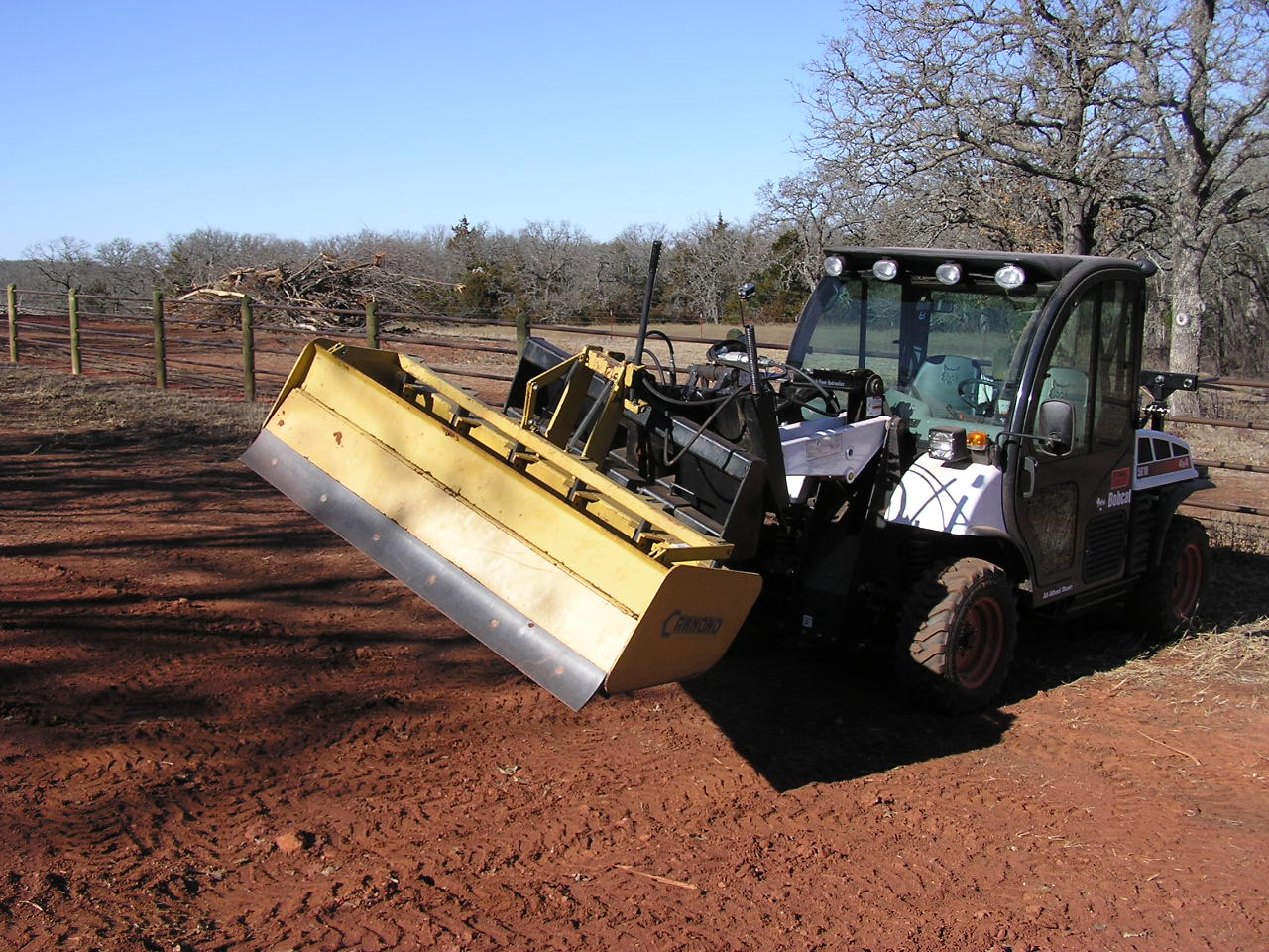

I like the lever that lifts or lowers all the scarifiers at once, like this Cammond. They raise straight up, out of the way.
I was moving silt with one that the scarifiers rotated back an up. The silt filled the BB and around the scarifiers, when you raised the BB the sticky silt stuck in there and would not fall out!
Don't need a hydraulic cylinder on the scarifiers, since I use the BB on a tilt-tach that takes the aux hydraulic connection.
View attachment 332032 View attachment 332033 View attachment 332034 View attachment 332035
This is Post # 13 of this thread. The black lever sticking up from the BB is what raises and lowers all the rippers all at once. It works great. :thumbsup:
