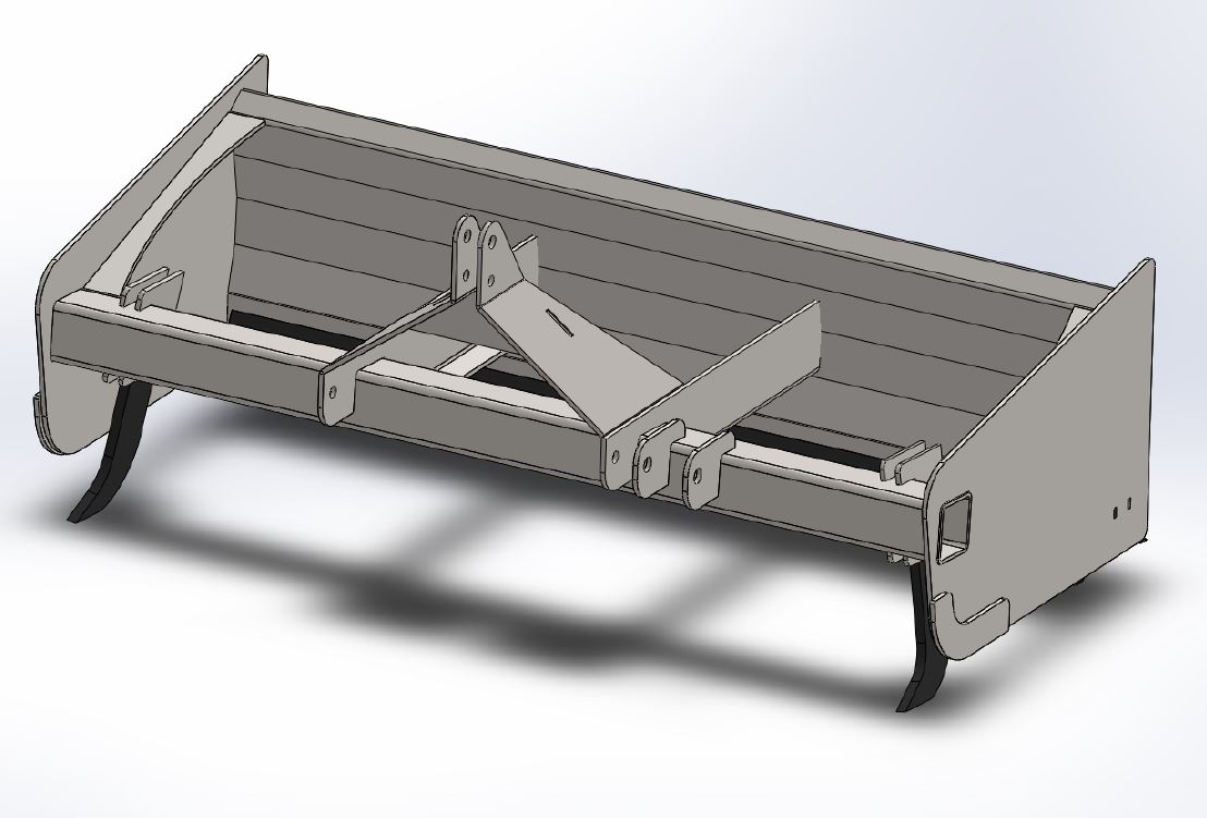

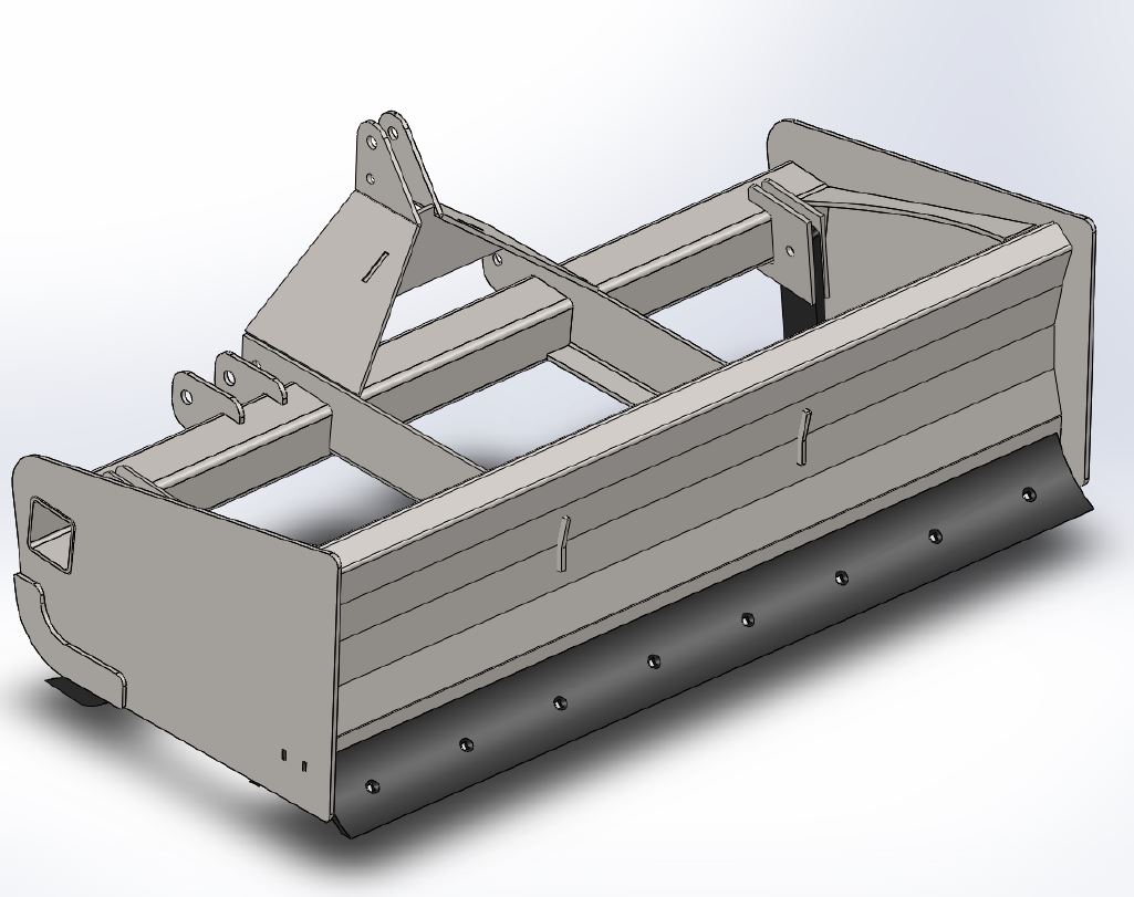

Here is THE BEAST so far.
The 96" is projected to weigh 1,900 pounds.
44" depth, 30" tall back.
Front tube is 6x6 3/8" tubing.
Category 2 and 3 Quick Attach Compatible Hitch.
Hitch and sides are 1/2" thick.
Mold boards consist of two 3/8" thick plates.
Cutting edges are 5/8"x8" viper blades...US made and largest in the industry.
Shanks are 1" thick x 4" wide and built in house. Weld on tips made from AR400
This blade will have fixed shanks. He will develop future models with retractable shanks and floating tailgate. He is starting with the biggest and baddest and will fill the gap later.
Here are some drawings. What do you think?

Questions,
Why the braces on the top inside edges? They sure are not needed. :confused:
Shouldn't you be using a tower similar to the Gannon? :confused3: What you have shown collects material and holds it in, and again bracing that should not be required.
So for this BEAST, What is the projected cost? You may have to lighten it up a bit to cut some costs. ;)
