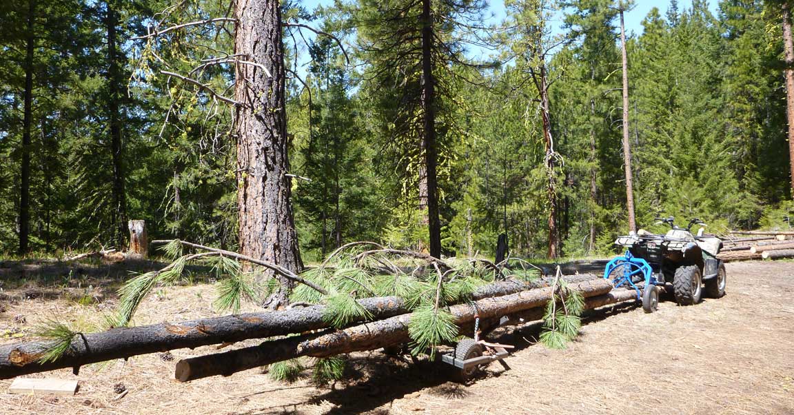

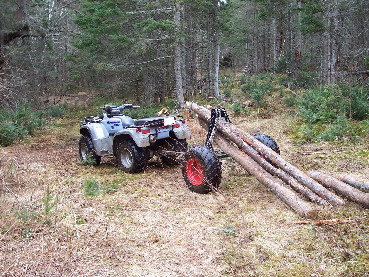

   / ATV Log Arch/Skidder #23
Found these photos, hope they help to explain. You can see the flat part at the top. That keeps the chain in place, negating a need for a catch. When you touch the brake on the ATV, the chain slides down and the log acts as a drag, slowing you down further. I have a Honda 350 and could pull a 600 - 700 lb log!

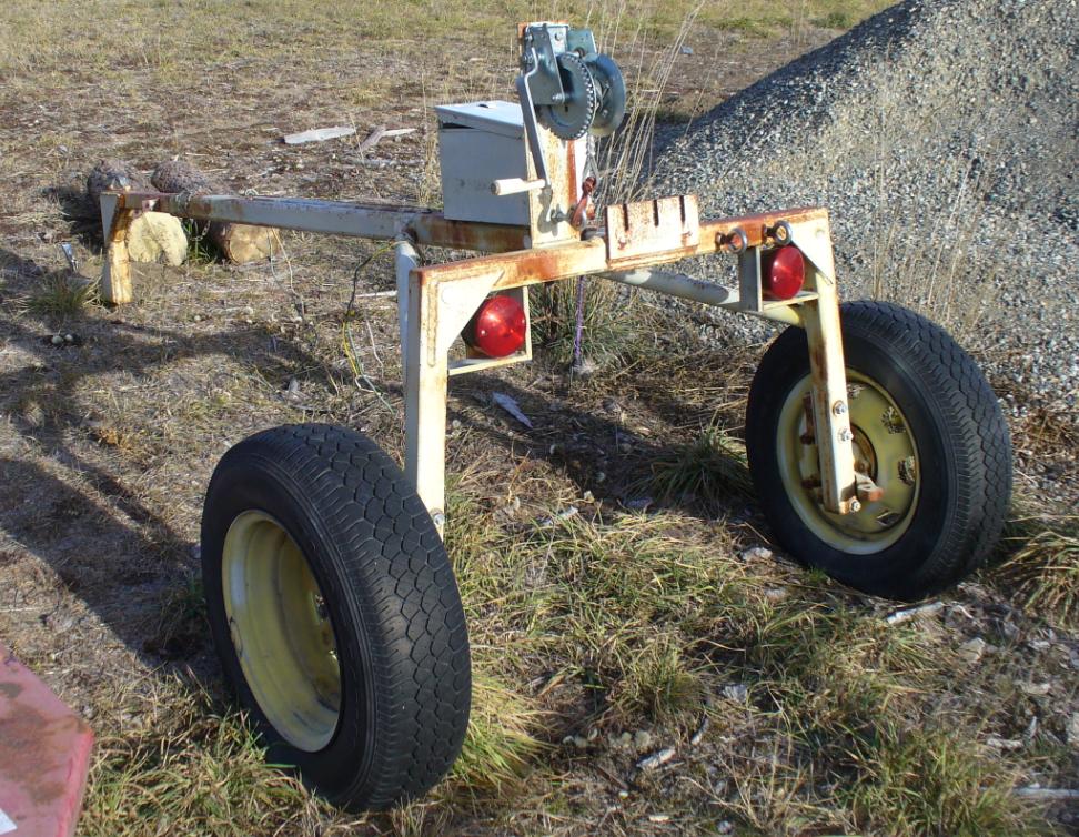

Here's something I put together some years ago (1980's) after seeing an article in Mother Earth News. I used a boat winch and wheel hubs & tires I found at the local wrecking yard. A spare ammo can came in handy for storing chains and other accessories. I even fancied it up with some running lights I had lying around.
To haul a log you positioned the tongue at one end of the log, wrapped a chain around it, then winched up the other end using the boat winch. The tongue was also adjustable for different length logs to keep the center of gravity where it should be.
It worked pretty well to haul individual logs around without having to drag them through the dirt and risk damaging the surrounding landscaping.
I haven't had a use for it since - so now it sits and gathers dust/rust.
This was before the internet but I see there is a link now to that original article.

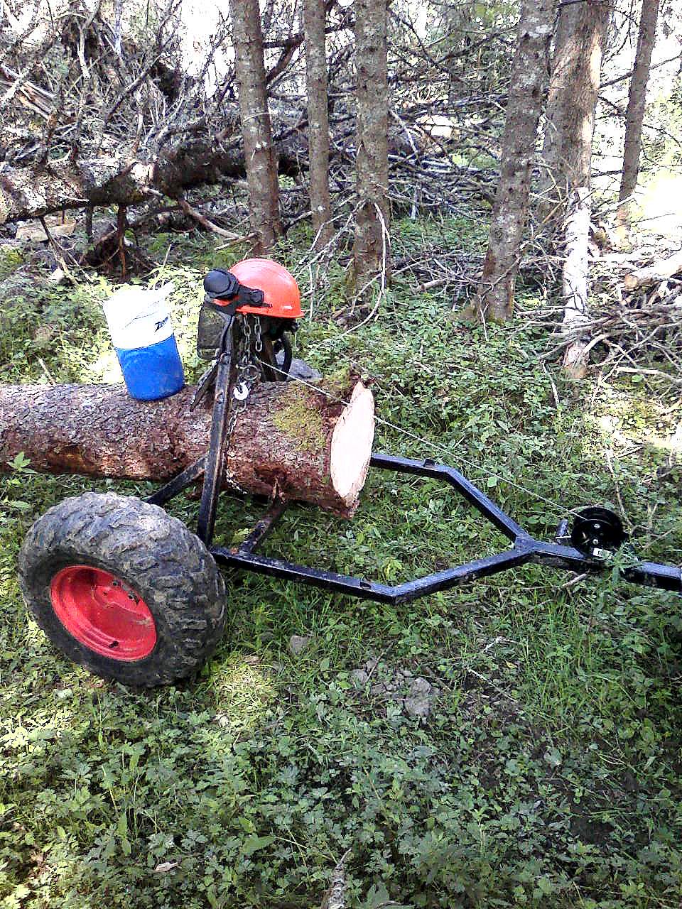

   / ATV Log Arch/Skidder #30

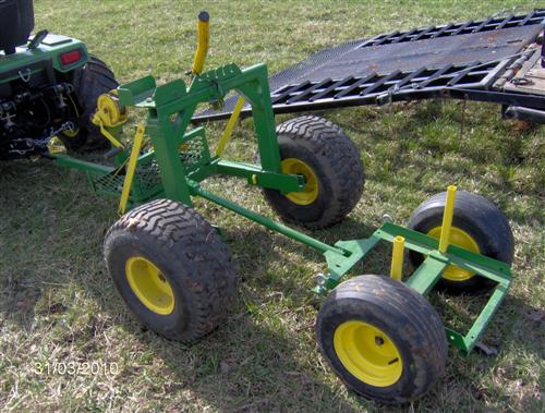

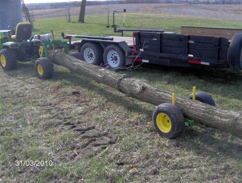

I made my own log arch from old garden tractor wheels & scrap I had on hand. Just don't use the tail cart on steep slopes! ~~ grnspot

   / ATV Log Arch/Skidder #31
Your setup would definitely work better for hauling longer logs.
Nice work.

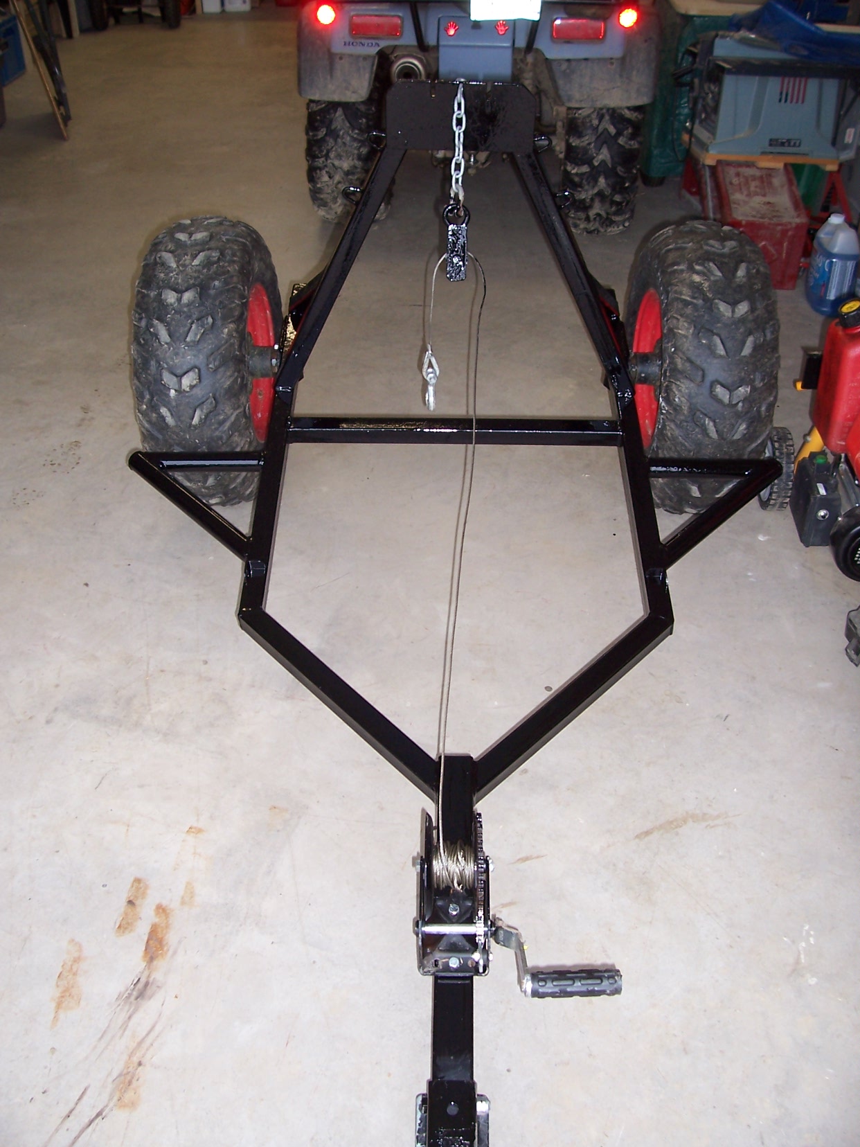

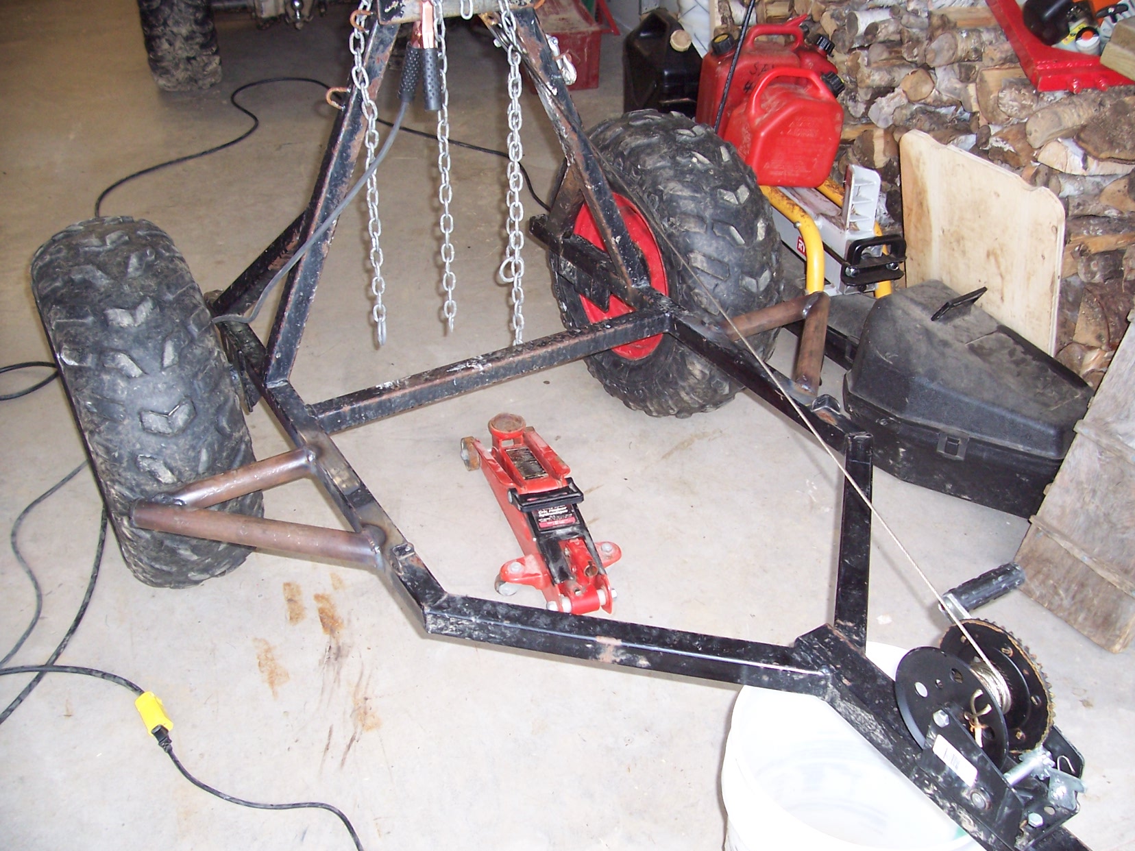

   / ATV Log Arch/Skidder #32
This setup works for me and is useful around the yard as a dump trailer. There is a flatbed that just sits on the frame and dumps with the boat winch. When using it for pulling trees, just connect the winch to the c frame making a tripod and pick up the tree with the winch.

   / ATV Log Arch/Skidder #33
grnspot I use a setup similar to yours. Sometimes with a heavy log I have to put the dolly on the log upside-down, and bind it onto the log, then upright it (tip it over) with levers. Then hook onto the front with the log arch and drive away. For that reason it's good if the dolly doesn't have a wide stance.
plumbstraight I like the dual use of yours. The 'arch part" looks is a lot 'skinnier' than the arch that I got from Northern tool (which is mean to be used by hand). But the drawbar pulls directly on each wheel. I'll have to think about that for a little while?

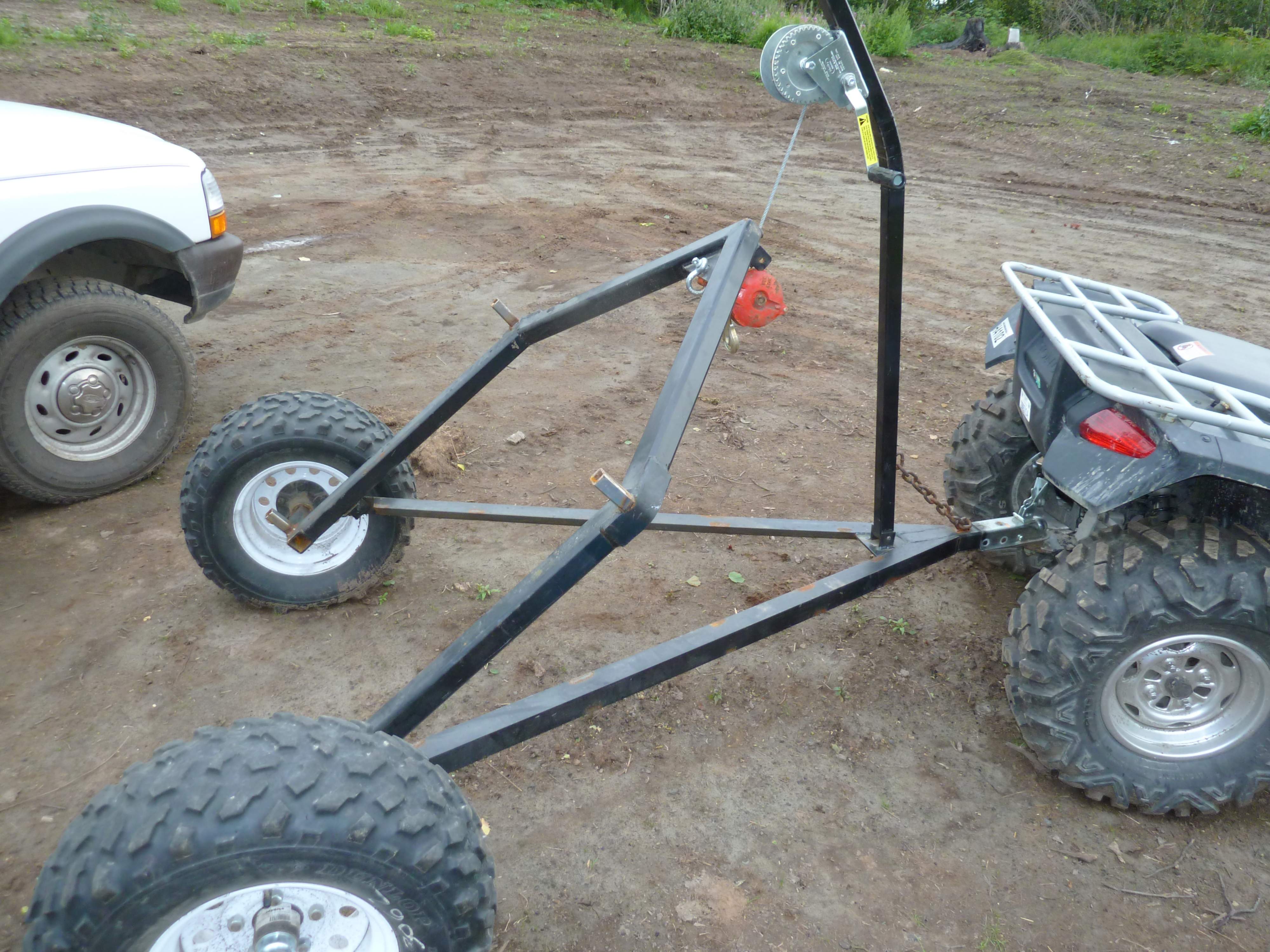

Here's mine... the fenders/deflectors got added after one too many times coming to an abrupt stop going around a corner and hooking a standing tree. Mine's hauled quite a bit of wood, everything from fence posts to larger trees. You can unhook from the ATV, back the arch over the tree lying on the ground, hook the choker up and then use the tongue as a lever to pull the tree up and then re-attach the coupler. I usually just either muscle the tree up or use the winch if it's a bigger stick.
Lawn tractor rims, ATV tires from a dumpster, Chrysler FWD rear stub axles (Spirit I think it was), 1200 lb boat winch, and some steel tubing. I use a 400 Honda Foreman, if it'll fit in the arch the ATV will haul it. I usually cut sticks between 12 and 16 feet long, any longer and it gets awkward making corners.
This one got entered in Miller's Weekend Welder challenge a few years ago.
Sean
