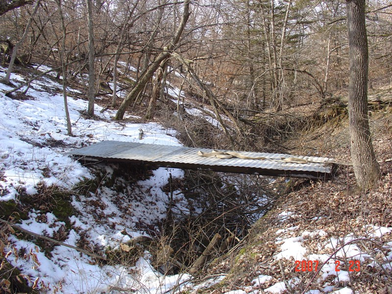

If you are asking me that question, I have two.
   / ATV/Riding Mower bridge using materials laying around...request thoughts
#22
I like doorman63's suggestion of utility poles. They'll support a lot of weight, and will likely outlast you before they rot, unlike the fir.
As far as center support (should you go that route), how big is the stream at its highest? A strong current or high level is going to put a lot of stress on those supports unless they're well anchored.
For the center of the stream and possible supports, the water will not go much higher than the picture. I picked this spot because the water will rarely even get close to the bridge itself and usually will be halfway or less up to the bridge itself.

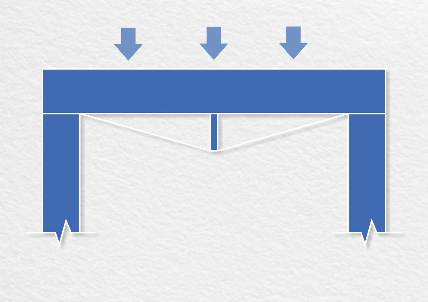

An inverted king post bridge design will add strength, even if the post is 1 foot. More is better if you can keep it out of the water.

   / ATV/Riding Mower bridge using materials laying around...request thoughts #26
Bruce
I’ve considered doing something similar with 1/4 or 3/8 aircraft cable and 2 short pieces of tube steel if the bounce is too much. I have most of the materials on hand.

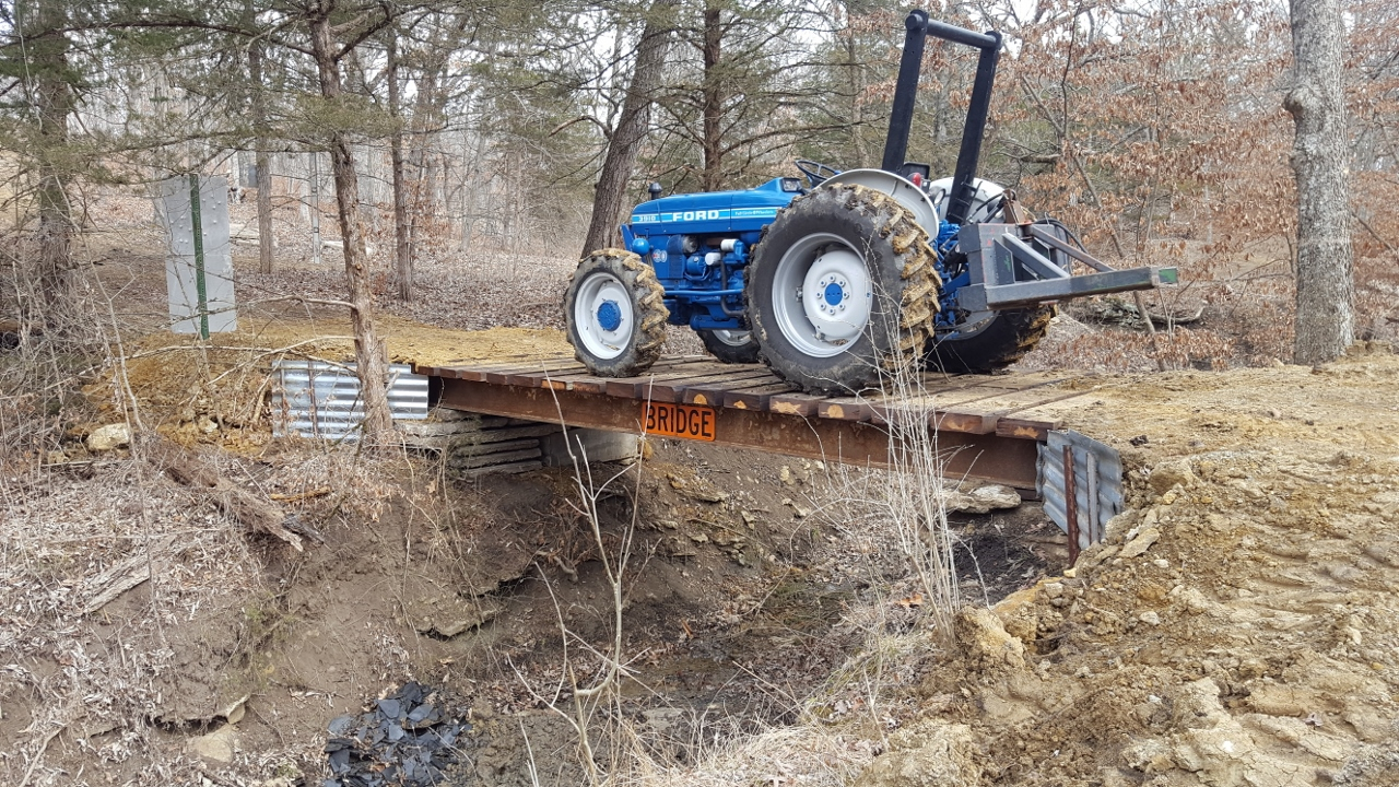

Yep. That was my thoughts with my "ATV" bridge. A Jeep or tractor won't fit on it. Same with Doorman's design.
   / ATV/Riding Mower bridge using materials laying around...request thoughts #30
My next one is gonna be for vehicles…..I have all of the steel tubes/angle iron. Most of the 3x4 decking. May not run the Kubota over it…….
