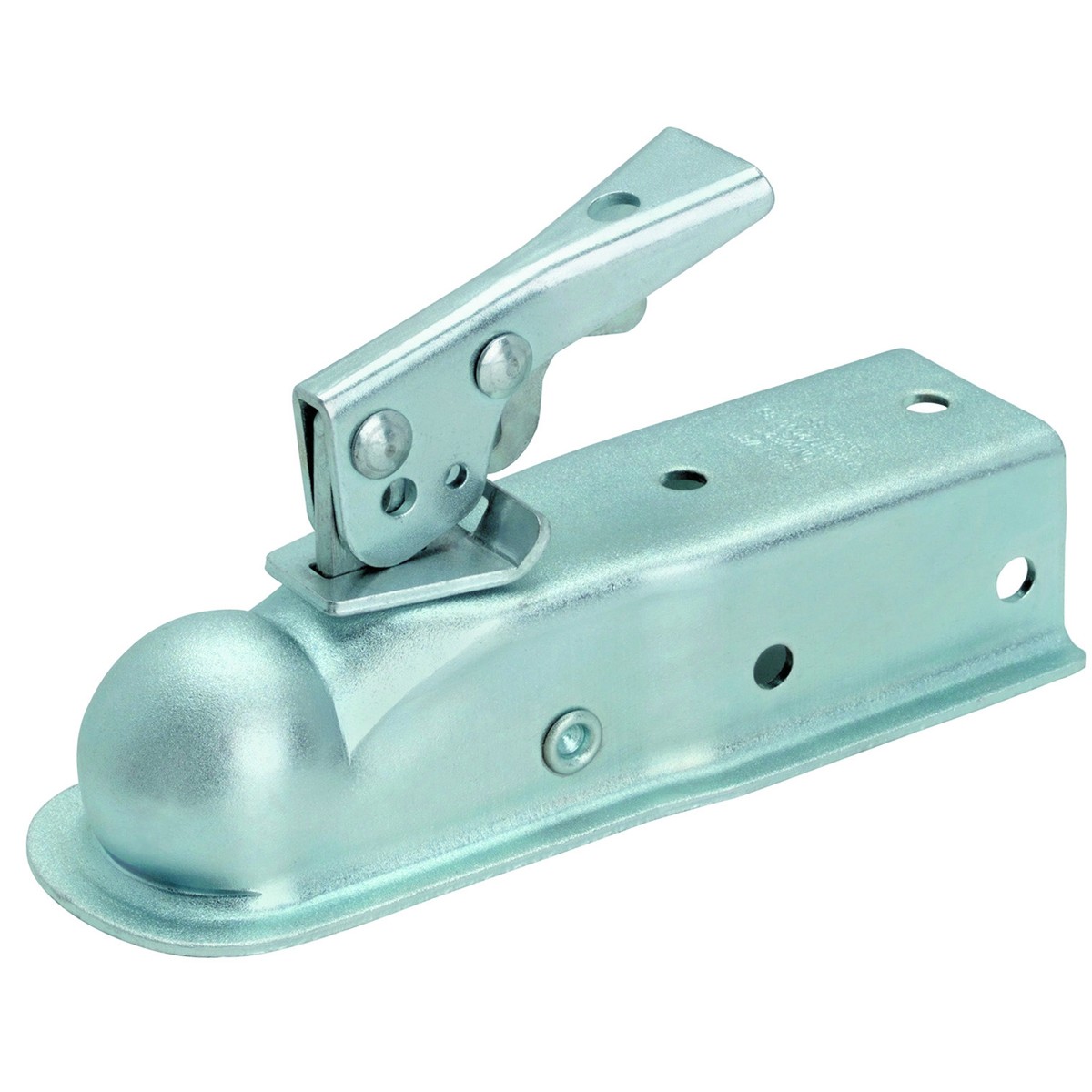

The trailer tongue is 1 7/8" OD, and the ball connector will be for 2" OD tubing. Would the correct wall thickness be .065" for the 2" square tubing? I am figuring 2 -1 7/8" and splitting the difference. Comes out to .062 but I think .065 is closest I will get.
/ ATV Trailer build #51
/ ATV Trailer build #52
What configuration is this stuff going to be? I'm not following what you're trying to say.
/ ATV Trailer build
#53
Sorry. The trailer hitch is for 2" square tubing, and the tongue is round, so I will need to adapt the round tongue to the square hitch connector 1-7/8" x 2" Ball Coupler.
I figured using a 2" sq tube piece slid over and welded to the round tongue is the easiest to adapt.

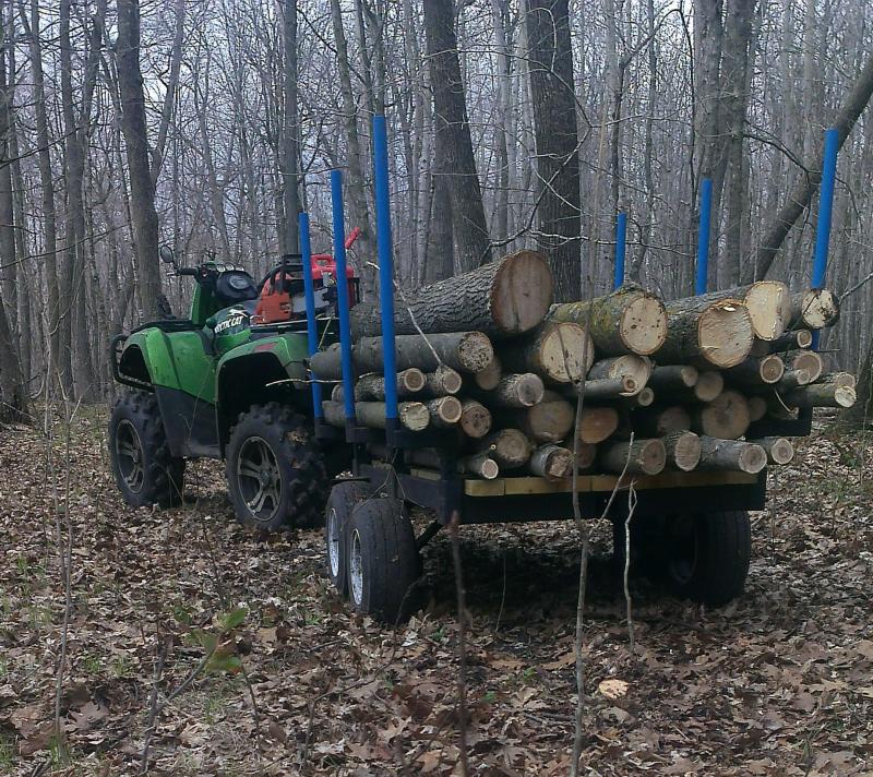

Looks like a pretty heavy duty. That build makes me want to take mine off the internet :(. Oh well it is what it is :). It will do all I need. I do not have that much property and it's pretty clean, so walking beam isn't needed at all. Won't need it on my deer cart either.
/ ATV Trailer build
#54
I like those stakes that add more width. Good idea for when you do not need all the space, to just remove them, and voila, narrow trailer. Wish I had thought of that, would have been a real nice option to add to mine.
Man I looked all over the net before settling on the body design, really wish I had seen yours first. Oh well, on with the show.
/ ATV Trailer build #55
Ah, now I get it. I was thinking you were going to add a receiver to the front of your tongue like mine and was thinking not only is .065 too thin, but you'll need a way to remove the weld flash seam. For what you're doing, that'll work perfect. You might need to smack the round tube with a hammer a little for it to slide over, or you could take the grinder to it easy enough as well. That'll be plenty adequate for your application.
Keep in mind, mine's a version 2.0 for a reason. :laughing:
I had that tubing laying around for years, so I decided I'd use it vs buying new and spending more up front. If I was to build it again, it'd be lighter. I don't mind that it's heavier though. The atv doesn't care at all, and it hauls deer really good as-is. I still haven't made my boxed sides for it and need to. I've got some firewood on the ground that'll turn punky if I don't get it moved before much longer.
I don't know if I'll ever build a dump box for it or not. I have a big Chevy straight truck that'll be getting a 5yd dump box this spring, and the tractor will hold what the little trailer will in it's bucket. Plans change and projects grow in and out of our implements. Just like we grow our skills as our passions guide us. Keep on fabricating and welding.
I didn't start out all that differently than you about 20 years ago with a flux core MIG. ;) Taking the initiative is a big first step. :thumbsup:
I've got a buddy who's talking about going to college after working on a production line for nearly 10 years and suddenly realizing he doesn't have any other skills or knowledge. I've talked to him several times a week over these years and he's always looking at dumb videos on youtube or watching tv - Top Gear or some such (not that there's anything wrong with that in itself). But there's one thing that stands out to me; he's done nothing outside of what he has to to get by. No initiative to learn on his own. Now he's talking about paying a school to teach him stuff. It makes no sense to me. There's so much information out there at the tip of our fingers, if you want to learn it, it's free! Better yet, there's communities like this one where we can delve into areas we know nothing about and get some help from folks that do. It's huge. So don't be disparaged that you don't have the coolest whatever out there. If I had more spending cash I'd be doing things differently too. :laughing: Be proud that you're gaining skills most people don't have. I've never met an engineer who said they got something absolutely perfect the first time they drew it out on paper, and wasn't lying. ;)
I'm looking forward to watching your build. :)
What I have done with round tongues, is shim the sides and bolt it on through the holes on the side.

I have done it that way before and not been happy so I will stick with the 2" tube for now. In fact, I might go with what Jim suggested by grinding some off the sides, and might even use .090 for a better weld joint. I have plenty of material on the tube and don't want a weld breaking with a big load on it. I am making this trailer to be hauled by anything with a 1 7/8 ball on it so I'll be able to load it real heavy if I want. Prob up to 1/2 ton, especially with just 2 tires. If I had 4 tires I could probably go to 1 ton.
