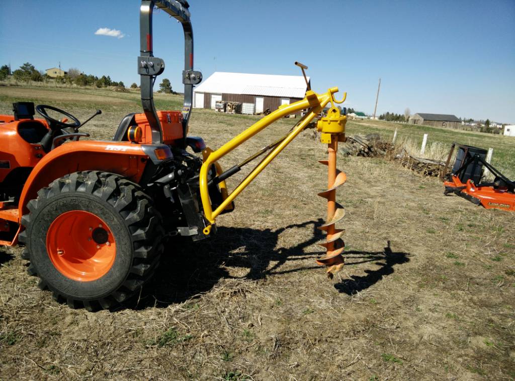

Totally spot on also ! :thumbsup: I used as good as 3 point PHD 's made except the homemade one's made from rear ends and what I can't stand is the constant turning around body and neck twisting that goes with it setting it up even with the ground marked to drill the holes .
BTW here's a pic of TBN member"s "MouseField"s home made rear end unit .
I don't think that's so much as home made as a modified Rears "Hole Hog". My brother has two of them, they're not very common especially outside of this area (made in Eugene Oregon), pretty sure they were made in the 60's to early 70's, the casting on the one we used says the rear end was a Chrysler 8.something. There's some giveaways, the U frame with the ball mount to the top link, the original loop for the bottom links, and the diff looks modified the same...
I don't have any input of the original problem, we drilled 14 2' diameter holes 4 feet deep with the ol hole hog and the only hole we had problems with had lumber in it... the clay we were digging was saturated good enough to plug up the auger quick at times.

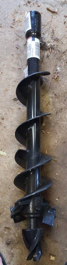

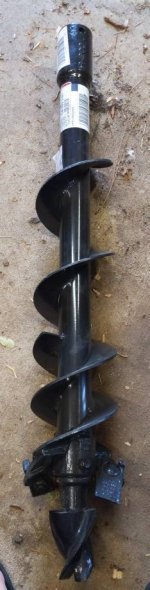

Pengo carbide frost teeth are useless in clay, ask me how I know... The ones I had were at thick & as sharp as my thumb. Doing stupid thing for a couple hundred lbs of down force did nothing. Finally got a cheap farm store 6" auger & drilled pilot holes fine. Enlarged them with the 9" Pengo. Finally wised up & replaced the teeth with relatively thin dirt teeth & it worked fine. A cheap auger with thin sharp teeth will outdig a better quality auger with not sharp teeth.

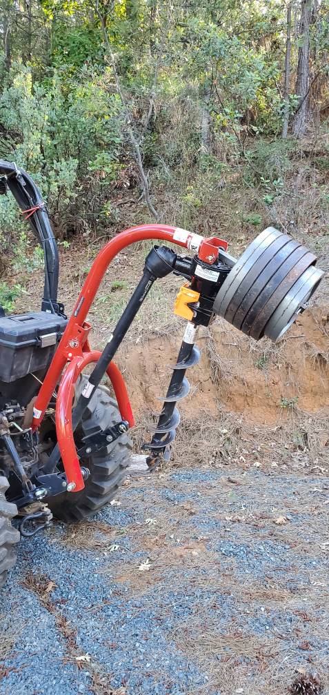

My QH mods gave me down pressure from the hydraulic toplink for a little over a foot. Not in the photo is a 200lbs chunk of steel mounted right over the gearbox held on with that handle. Both of those helped out a lot, but I upgraded to a hydraulic SSQA PHD when I upgraded to the new tractor. Not a massive increase but its an improvement in usability if not digging power.IMG_20141109_134834.jpgIMG_20150328_151018-1.jpg
