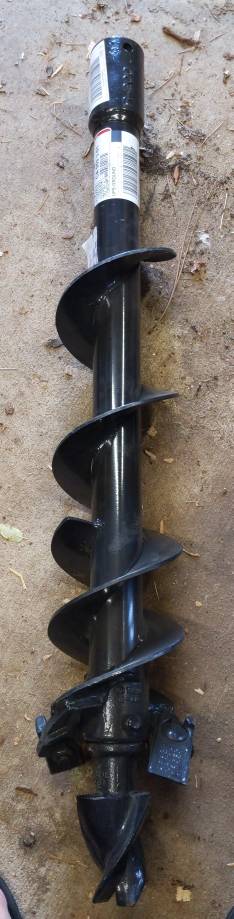

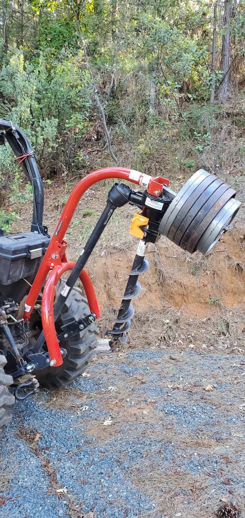

The first set of holes I dug about a month ago went great - the 9" auger sank fast and it was wonderful. Unfortunately the ground has dried enough that even two feet down there's no moisture and a new 6" auger goes nowhere.
View attachment 660599View attachment 660603
So if you can drill with the 6" why not go right back down then with the 9"???

Pour some water in the hole and let it sit for awhile. Then try to auger again.
That痴 the ticket. Soften it up.
Just don稚 let it screw itself into the ground . We have clay here and twice I致e had to unhook the auger and hand dig all the way down to free it.. not fun. If it starts screwing itself in yank it up fast and clear the hole out. Quick and easy vs. slow and miserable.
You can make your own 1/2 or larger drill bit longer by welding it to some roundbar. Used to make these all the time for drilling bridge deck to bolt together.
you'll note i said the new 6" goes nowhere. been there, tried that.
   / Auger won't drill hard clay #37
I really am at a lost for suggestions of using a PHD in hard clay. While as I commented it is similar to drilling cured concrete when baked hard—I would not recommend the hammer drill type activity on either your tractor’s 3PH or the PHD. If only a few holes, you would probably not be using a PHD to begin with, constant down pressure does little (personal experience knowledge).

I would also suspect that if you were successful and it got stuck it would be a nightmare to get out-I have experienced this . I also have hard clay and for parts that i need a hole I end up using my backhoe. Its still a PITA because the bucket will fill up with hard clay and its very difficult to clear it out.
I tried modifications with a thick wire so that when the bucket is curled full open it slices through the clay like a wire cutting cheese. So for me the best advice is to using a BH with a small bucket to get it done. Yes the hole will be bigger than what you need but it will be less of a hassle to fill it back in.
   / Auger won't drill hard clay #39
Last year I was building a leanto off of my barn and I had to drill some holes when it was super dry and my gas powered 10" wouldn't even scrape dust once it got down about 12" deep. Since it was right next to the barn I got the water hose and a pressure washer and bored them out using high pressure water. I made the hole big enough to barely drop a 4x4 in, used ,y loader to push down and bottom it out and poured a bag of concrete in. Framed up off of those posts what I needed to do and a year later they are still solid.
