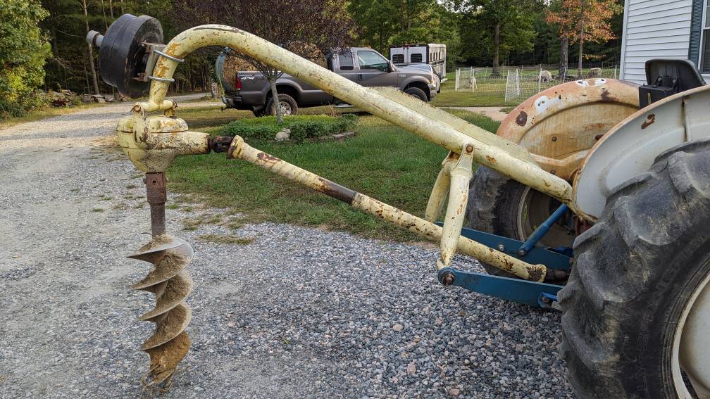

I was Rural King yesterday picking up a water trough and looked at their new post hole diggers and augers thinking of this topic. All had twist points and blunt teeth. They might dig in the valley but not on my clay hillsides. My old Ford 3pt phd will dig anything you can dig by hand, thru the toughest clay, shale and rocks. Screw point and sharp teeth. Biggest problem getting stuck by drilling down too fast. You only do this once hopefully to learn your lesson. Blisters help you learn faster. I go slow and watch the bit feed. Only speed up to sling the spoils off the flights to clear the hole.
I remember the bins of different cutter teeth and points at Co-op with knowledgeable people to help you. Not so much now. Use the right tool the right way.

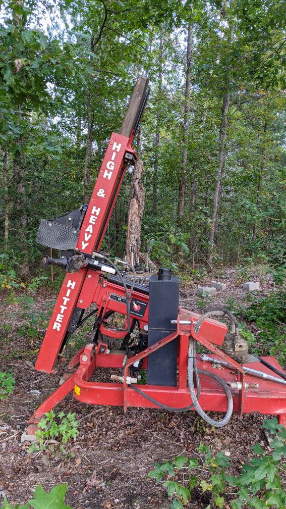

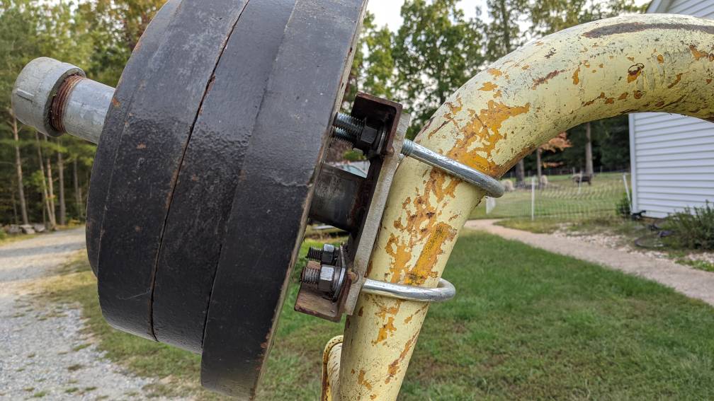

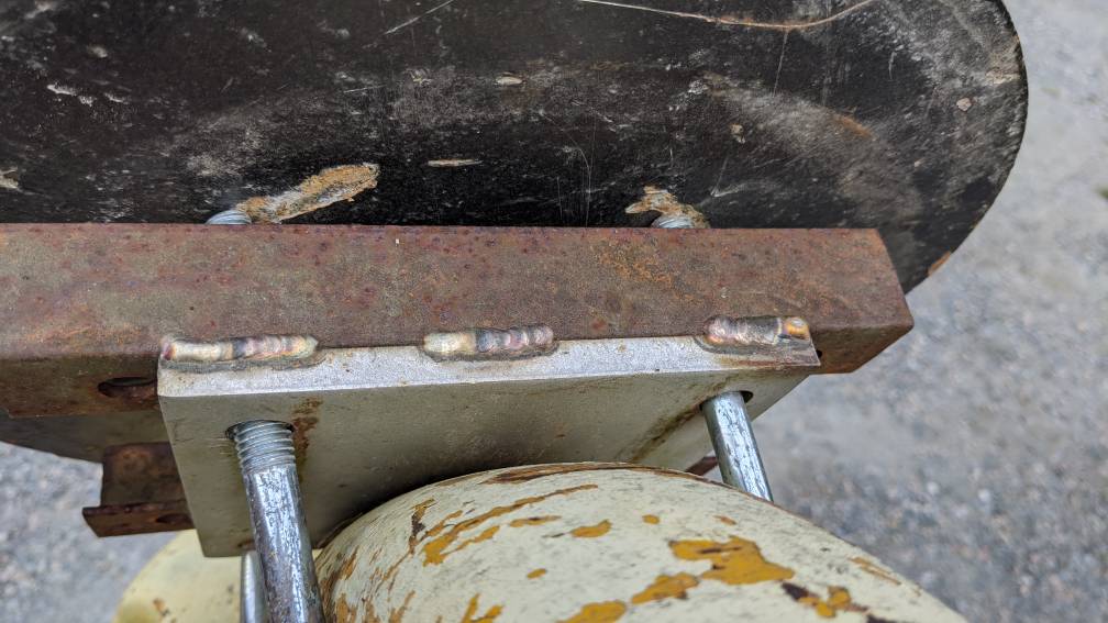

This is what I use in my hard ground. Lots of quartz rock and clay. PXL_20201004_211641262.jpegPXL_20201004_211637433.jpegPXL_20201004_211612202.jpeg
