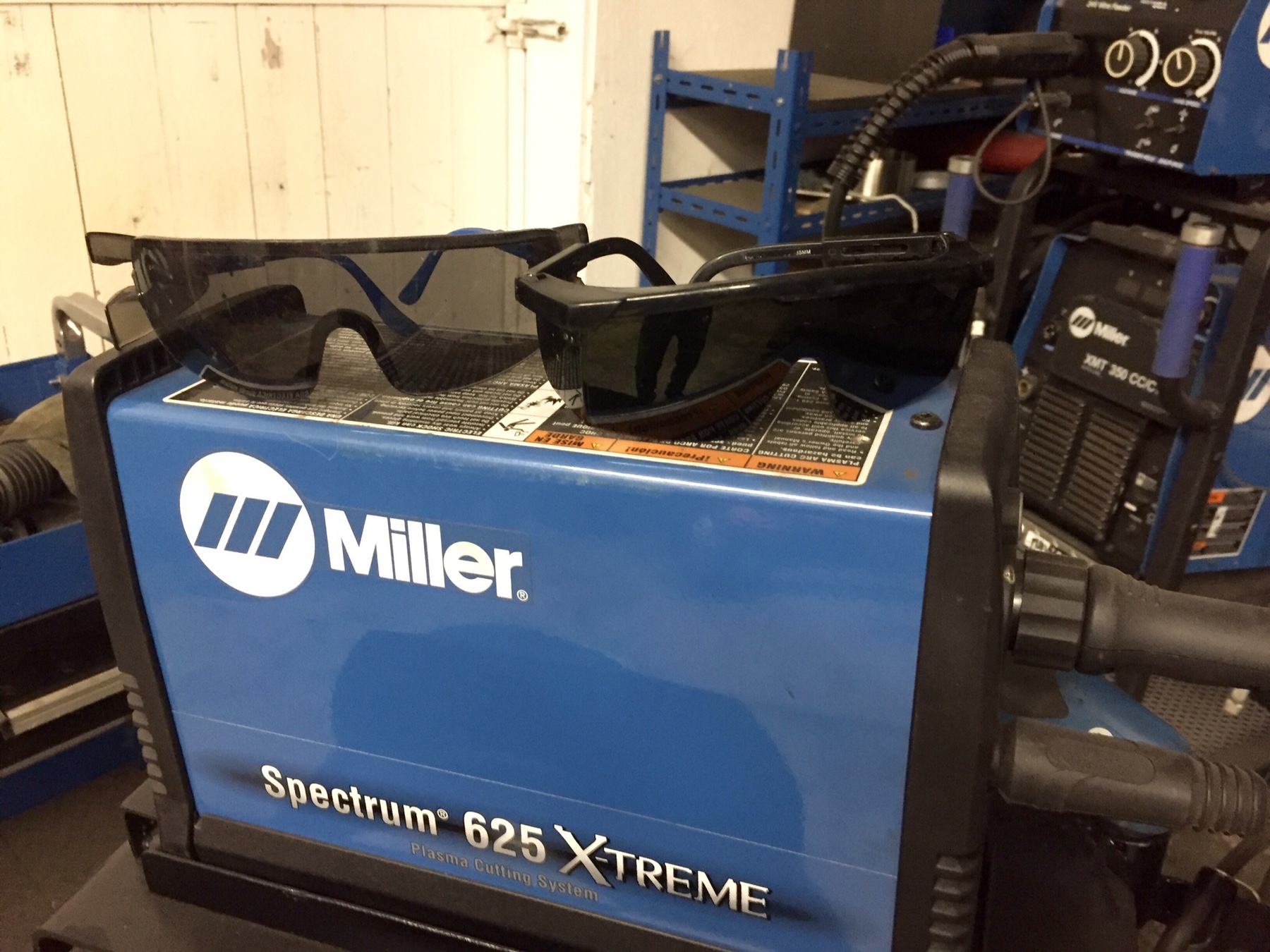

I find a helmet way too cumbersome for plasma cutting. Just buy a couple pairs of shade 5 and lighter safety glasses. Then you won't have problems with wearing a respirator.
   / Auto-darkening helmet #45
Agreed! Yeah I quickly went to a shade 5 safety glasses and started wearing my respirator when I got my plasma. :thumbsup:
   / Auto-darkening helmet #46
Thanks Big Barn and dragoneggs. Will give the glasses a try.

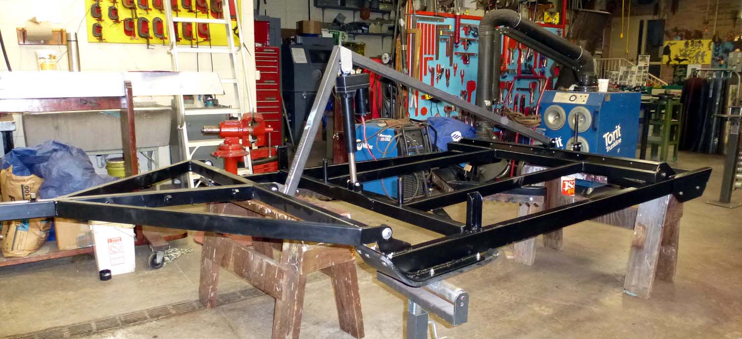

Well gee guys, this thread is spot-on for me today. I welded in the energy business for some time but left that some 20+ years ago. Today I'm back in the welding realm but in a high school shop but tired of using there poor quality, always scratched the dirty helmets and decided to buy and bring my own. I'll attached one project photo that I've done there for the folks who like visual. (I do) I'm going to look at the helmets you folks speak of and get one.
   / Auto-darkening helmet #48
Very nice! Trail Groomer?
