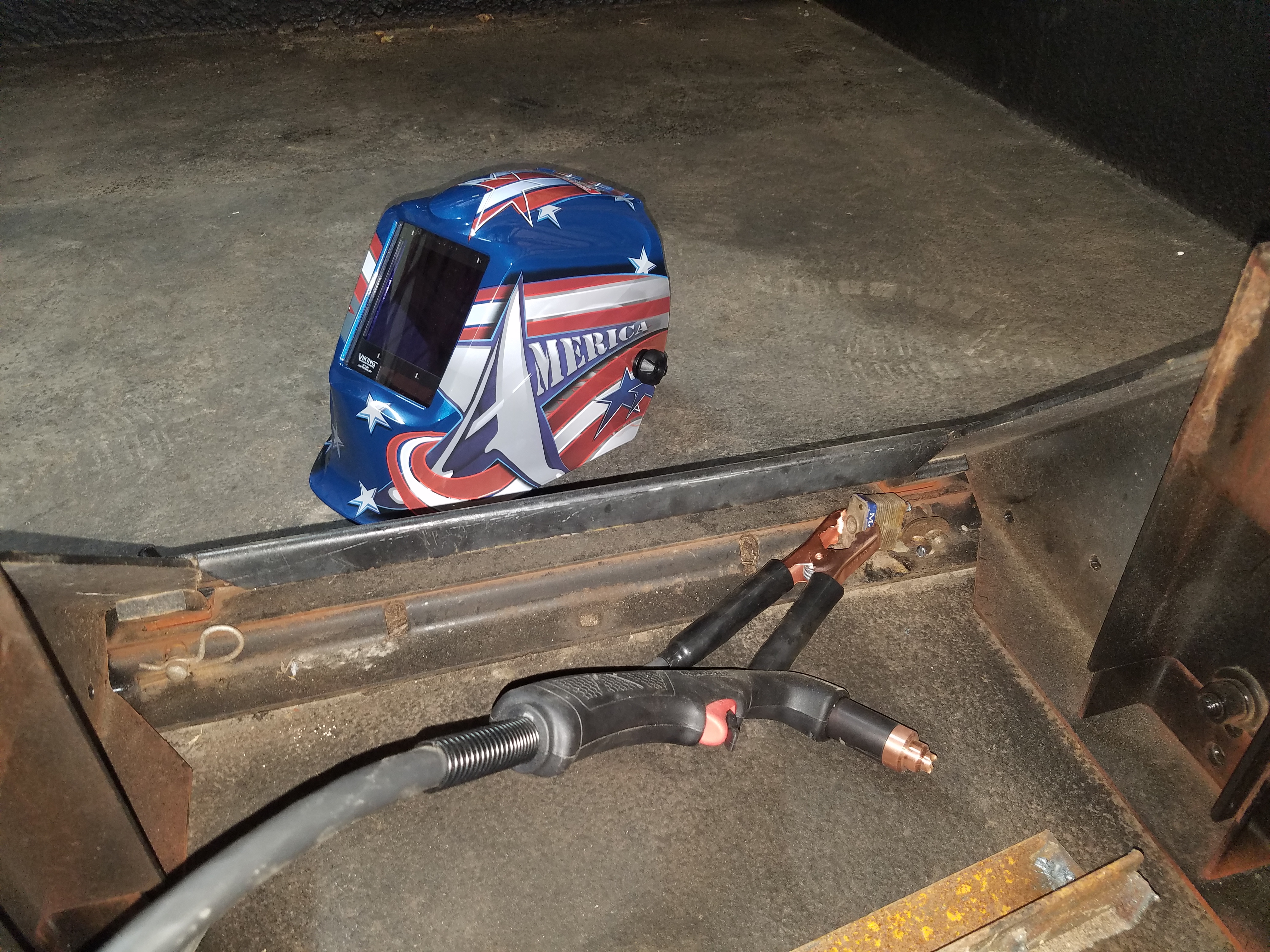

Re: Auto-darkening helmet review
Ive been using this helmet and HF ones on and off since this post was made in December. I cringe whenever I don't have this Tacklife to use. Visibility between the two is black and white in difference.
With a little blizzard happening here the past two days, this afforded me time out of the field and back into the school shop. So this is a mini review of the Tacklife PAH03D welding helmet which this thread, impressed me to purchase.
I should have got a a better helmet years ago! Gee whiz, I can see again! The Tacklife PAH03D controls are very nice, easy to use and understand, plus the helmet is quite light. There is a slight green tint when the darkening is not engaged which does not bother me. The only thing I'm not impressed with, as another responder had mentioned, its head gear doesn't appear to be very durable. I'll agree but i don't do all that much welding anyway. I added decals to the helmet, so as kids don't use or run off with it.
Hope you guys enjoyed my amateur impressions.
