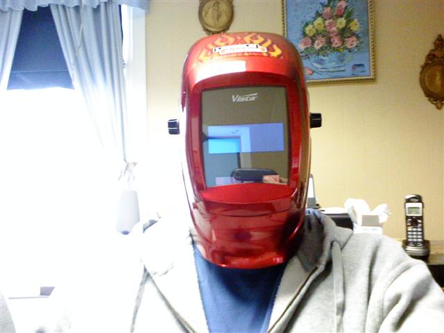

Thanks to the op for this thread. It helped me decide what I wanted for Xmas. Can anybody guess?
