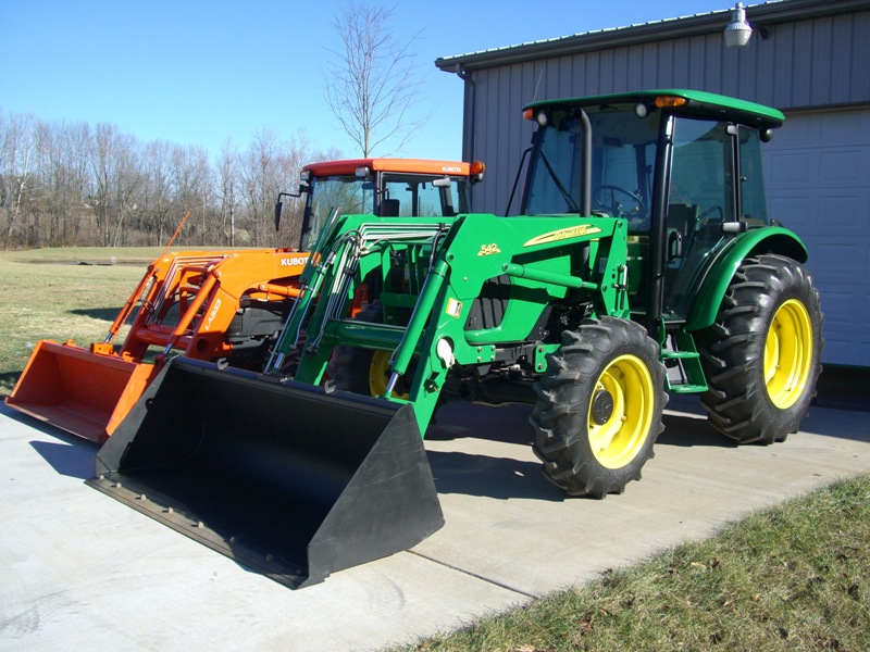

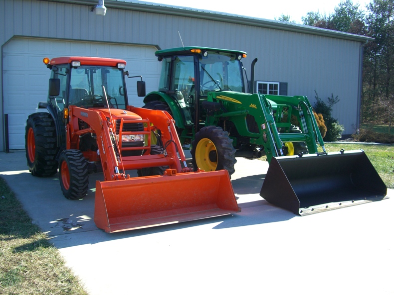

Your thought is exactly as what I was thinking. I didn't expect it to go into 4X4 from the 2wd setting, but that is what it does. And, it does not lock into 4X4 if you are only using one brake for turning. BillyP posted exactly what my choices are; thanks. I probably should have posted what my options are as you did for me.
I think I am of the mindset as most here; I like things that make operation of the tractor safer...but my little pea brain still wants to be able to override that setup if I want. For example; when I am mowing what amounts to be basically 10 acres of flat land, I don't like the 4X4 kicking in everytime I use the brakes to stop or slow at each end of the area. With loaded R1's on it, it tends to leave marks, which is why I have a thread in another area asking where I can possibly buy a spare set of rims to mount R4's on. As BillyP noted, it is a tad bit large to be a lawn mower. With the FEL, HD 84" WorkSite Pro bucket, 8' finish mower, cab and me; I'm just over 12k on the scales.
It's not just a huge amount larger than the Kubota 5030, but it sure weighs a lot more and has quite a bit more hp. The weight, the R1's and that automatic 4X4 is what is leaving marks in my yard now. Out in big open areas where I don't need to turn around for over a mile it's no big deal. Still, for whatever reason, I would like the option of disabling that safety feature. Hmm, after I put it that way, it doesn't sound like a smart thing to do... :eek:
That's a nice looking pair of tractors, especially the green one!
You finish mow with that Deere?? How big is your lawn?
