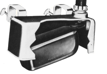

Eddie;
We installed units similar to below picture in the stalls of our 4 stall horse barn. There is a float valve behind the rear panel to keep them full and they work very well.
For the water tanks in pastures, we have water valves in each tank to keep them filled similar to below.

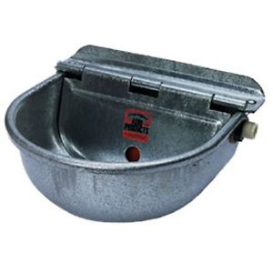

Eddie;
We installed units similar to below picture in the stalls of our 4 stall horse barn. There is a float valve behind the rear panel just keep them full and they work very well.
Sent from my iPad using TractorByNet
We used the top one of these in a barn years ago. Our experience was that if it's cold enough to freeze a pond, it's cold enough to freeze the waterer. We just use buckets now.
/ Automatic Horse Waterer Suggestions #8
I want to get one of those top ones for dogs and maybe someday goats....but TSC only has plastic ones....need to keep looking for the galv. ones. I had one years ago for dogs and it worked great.
