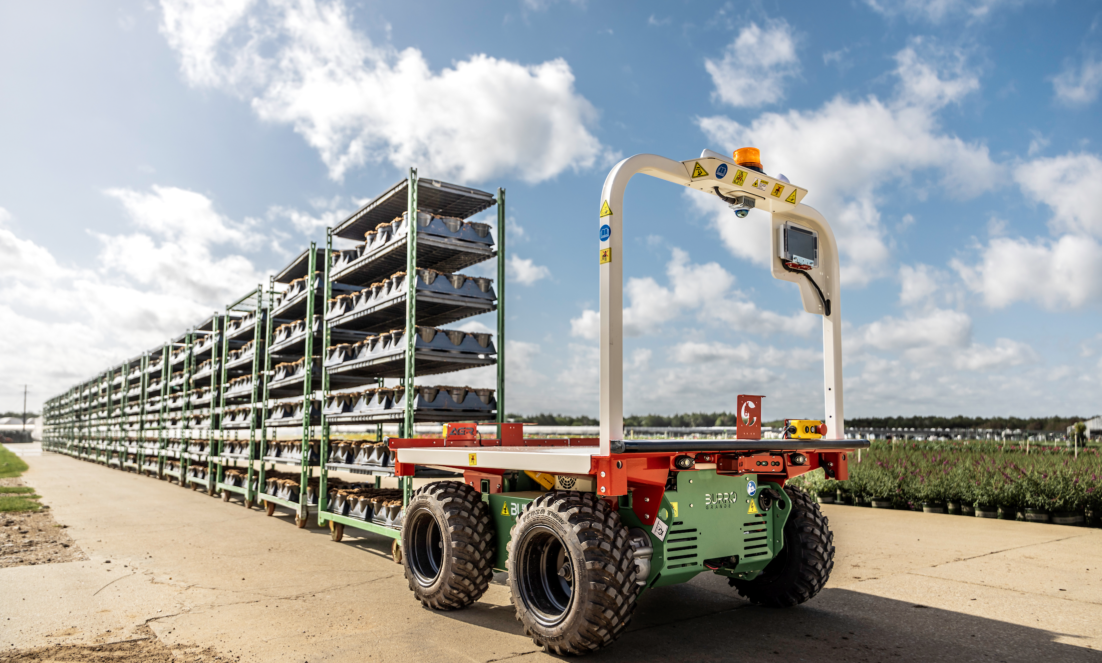

Customers of mine keep putting weird mowers behind our Burros to try to autonomously mow, then my team keeps thinking there is a use and trying things out. I have a small Burro (about 4 Hp, 500 lbs, big enough to tow a 36 inch fixed mount mower) and a larger Burro Grande (about 12 hp, 1200 lbs, big enough to tow a 48 inch fixed mount mower or maybe larger).

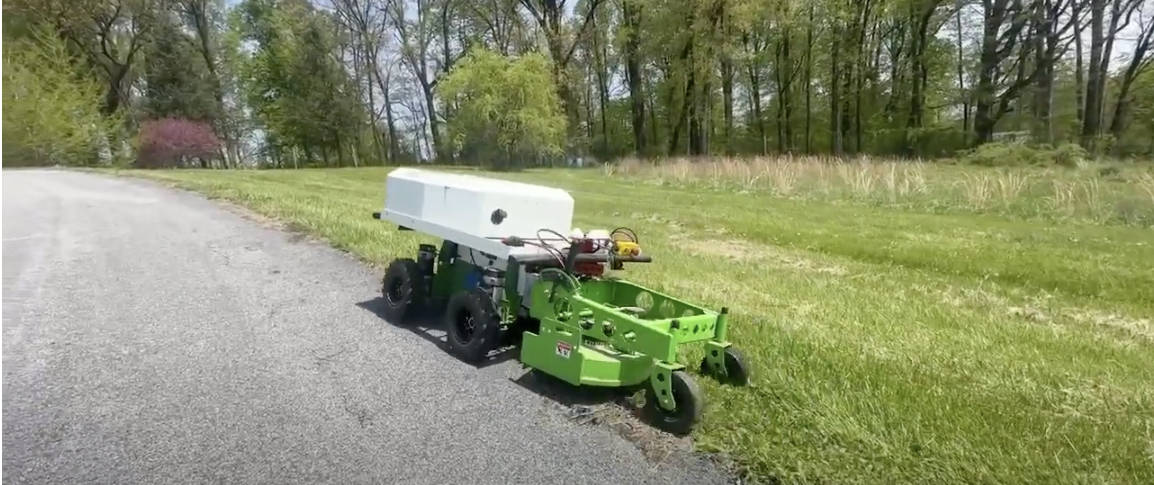

Would anyone in their right mind want a mower that autonomously docked to charge, then repalced a BX or 1025R sized machine and mowed areas / rows autonomously on a continous cycle? To me, it sounds amazing - buys me about 50 hours a week of labor during the summer / or about $2k/week just in labor. What do people think? Here also is a survey - would LOVE any feedback positive or negative!)!
Some pics below also for context:

Here is about the size we are heading for (see image below) - likely starting with a 36 inch variant.
These are about 36 inches wide
dock to charge
Ballparkish economics would be like 28K for system with autonomous charging dock, robot, and mower.
This could do about .6-.75 acres per hour, but run 3-4 hours per charge, so figure manage like 80 plus acres per seasons assuming 8 passes per year.
We are looking for a few early adopting customers in Pennsylvania (We are based in Philadelpiha) who would want to try this and share a ton of feedback.
