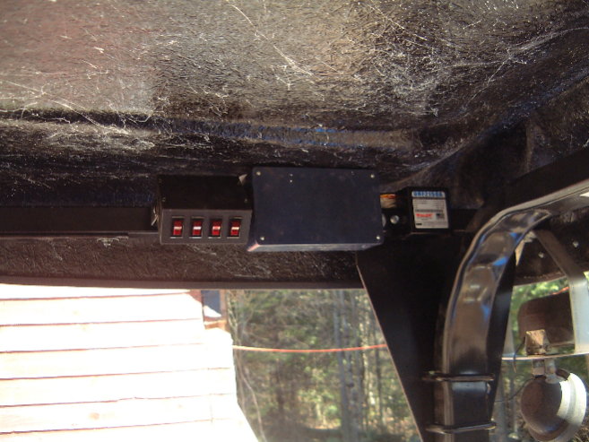

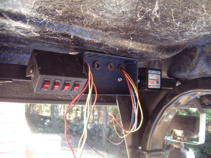

Final picture for now.
The wire I have ordered is a 6 conducter, 14 guage cable used for wiring trailers. This will save me from having to run a bunch of single conducters and will leave me with 2 spare wires for ???

I was actually thinking of throwing in a 12 volt overhead light like you see in campers etc.
I could make that the 4th switch.

Nice clean setup.
